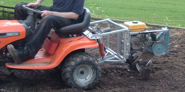

Idlers.... I had the same set-up on a Rotavator/Tiller. The machine used to destroy belts in no time at all, even though the 'idler' was mounted on the 'slack' side. What I did in the end, was to mount the motor on some sliding rails to do away with the idler which forced the belt in to an non-natural position (breaking its back comes to mind). Since fitting the sliders, I'm very pleased to say its no longer eating the belts. The sliding motion is controlled by some rods to an old handbrake lever, so the ratchet on the handbrake mechanism holds the motor in position to give drive. I would post a photo, but but friend has 'borrowed' my machine..... so not available.
/ Another Mini-Dozer #356

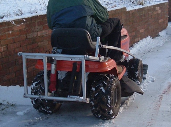

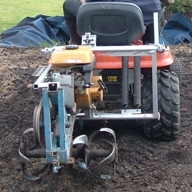

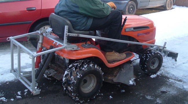

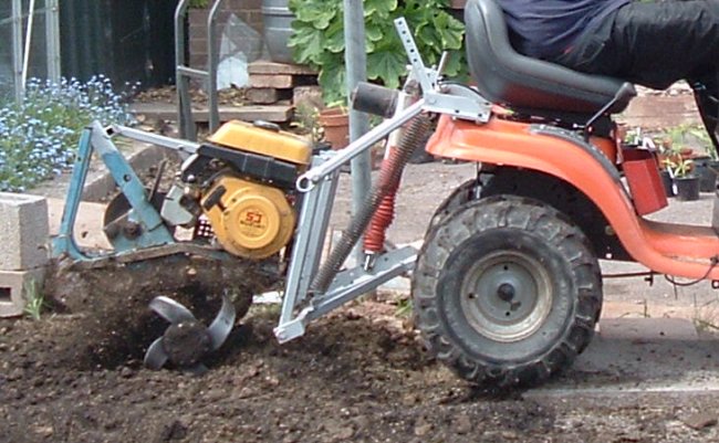

Re Linear Actuators.
I fabricated a 3pt linkage type arrangement on the back of my garden mower to attach my rotovator/tiller on. Unfortunately it would lower fine, but struggled to lift. What I did to solve the issue was to fit a pair of large pull springs (I think they were originally used on 'up-and-over' garage doors to counteract the weight). These counteracted the weight of the attachments, so that all the linear actuator was 'position' the attachment at the desired height. This may not look as good as having just the actuator, but it does solve the issue.
