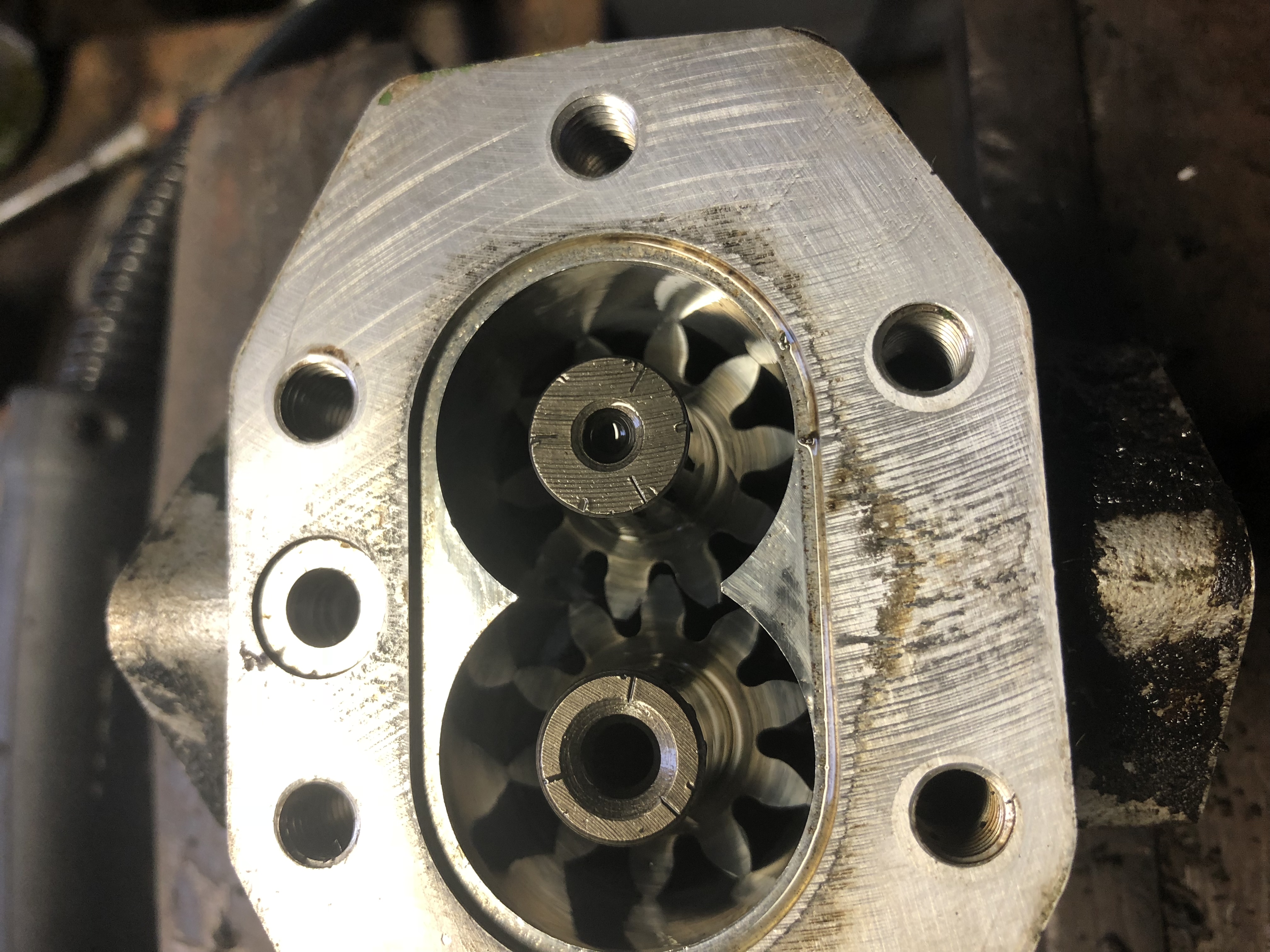

#47
CDED14F1-8F21-46C6-833B-E642A461FDE3.jpeg that’s what it looks like inside the pump housing

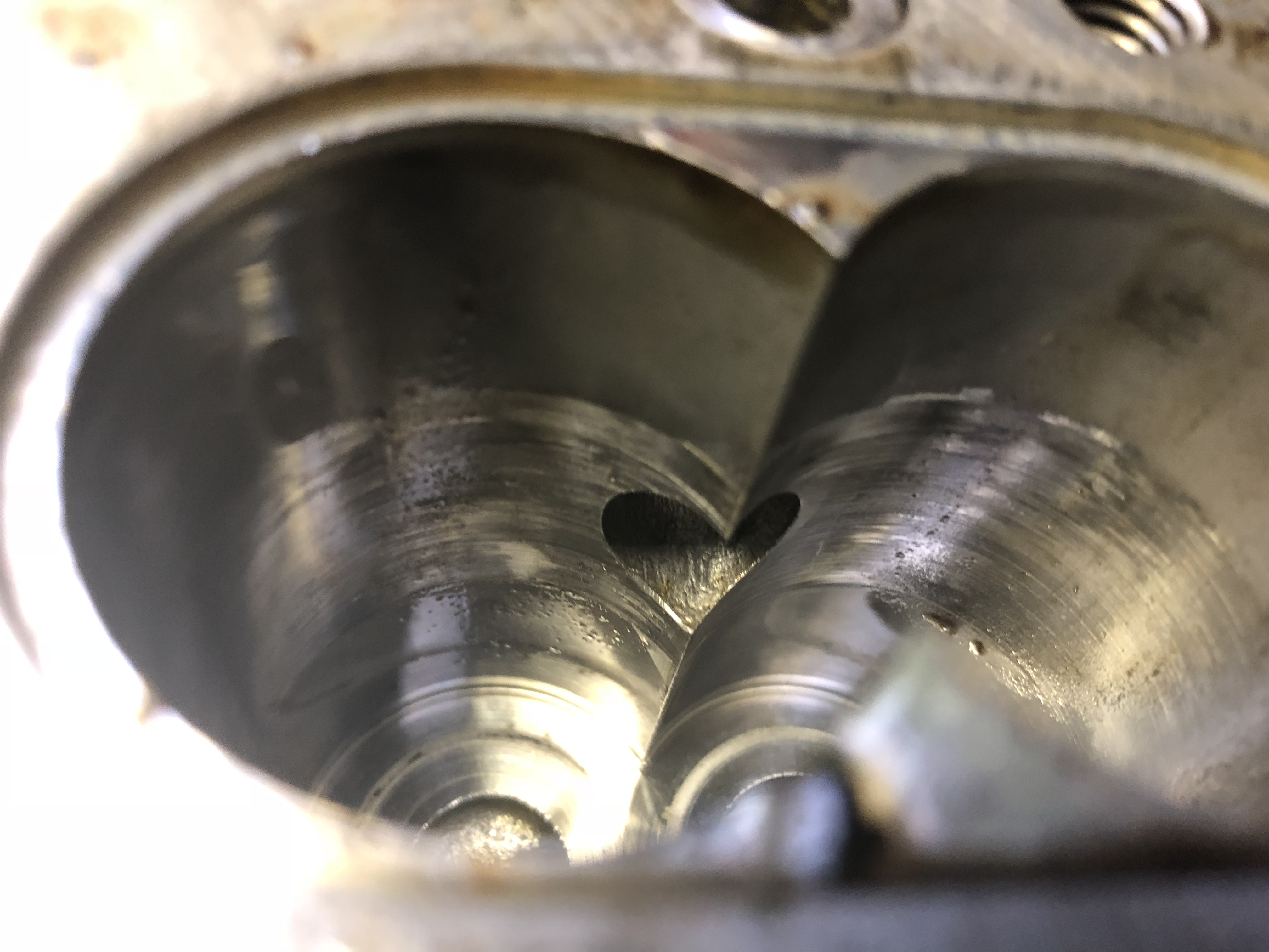

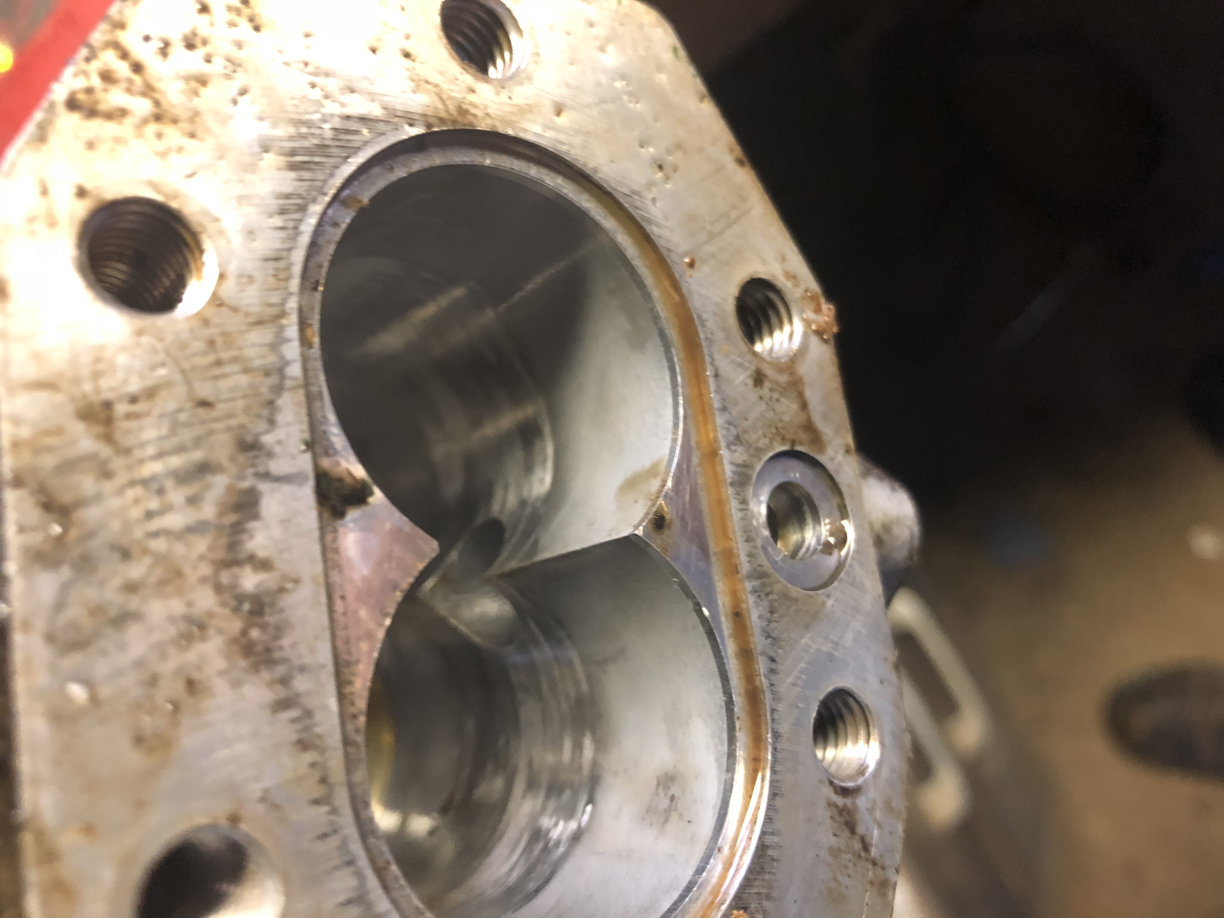

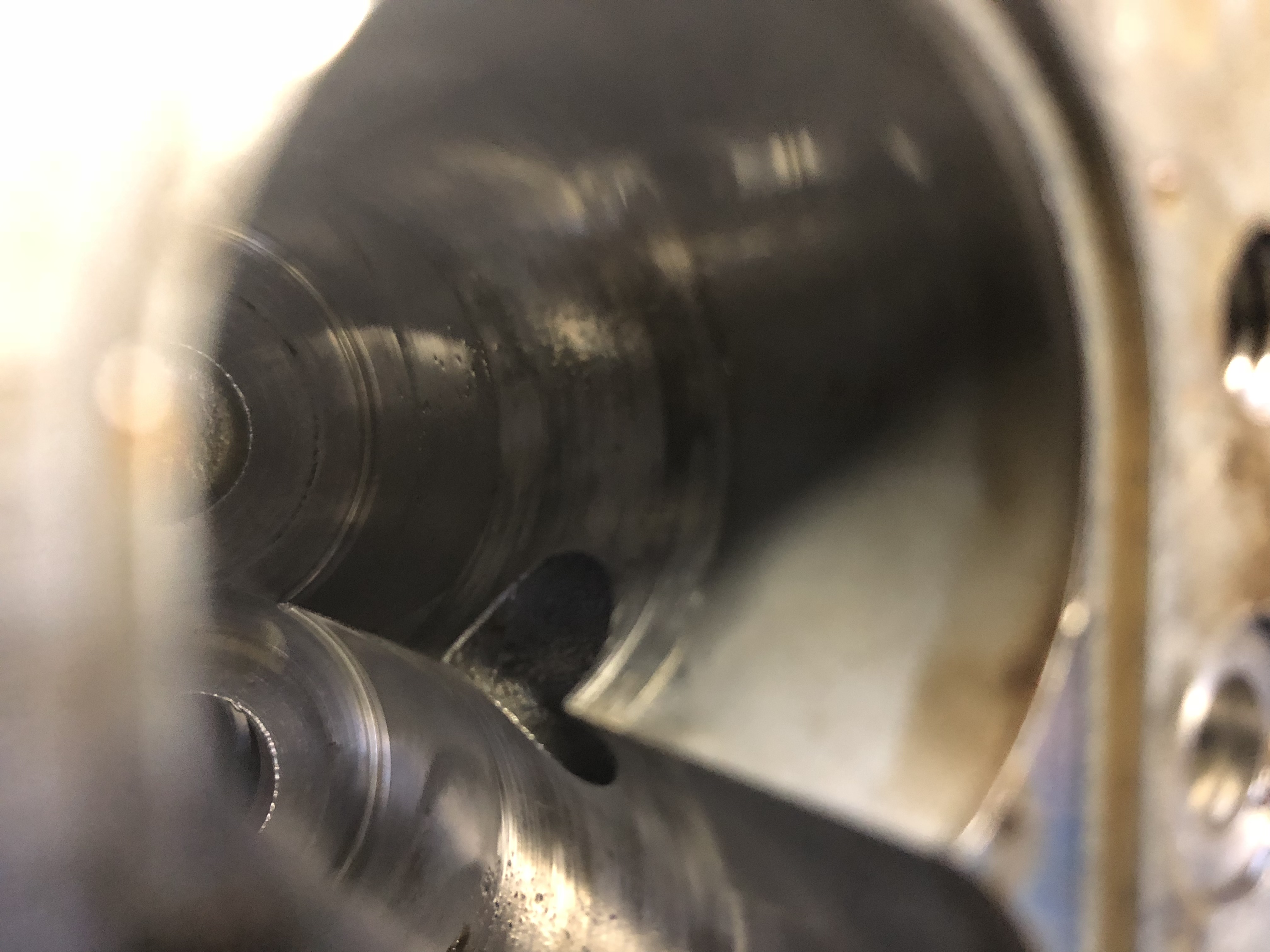

#48
It’s just on one side 7B9839D0-4463-40A3-806A-79C4A1E291D5.jpegCEEC007F-7627-4295-B277-871632B611FA.jpeg3A6AD1A9-B934-4E73-BAB2-99B90C2F095A.jpeg
