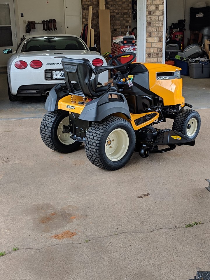

Alright we've been in the property about 45 days now and I am starting to get a handle on what I need around here.
I bought a garden tractor for the lawn and light duty stuff, Cub Cadet XT1 GT - 50".
It does a good job in pulling my 12cu poly cart and a 4' harrow/drag but that is about it, oh and it mowes well. I did try to do some pasture knock down and it is entirely to rough to do without beating this garden tractor into the ground. It would work in a pinch, but far from ideal.

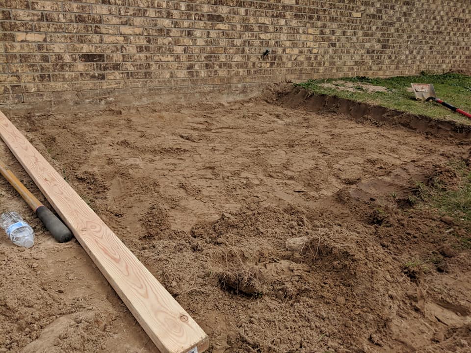

First major project I tried to start tractorless was grading around my house. I started it by hand, that was a waste of time.

I do appreciate all the advise, here is a shot I took of the Cub Cadet the first day I got it and some grading shots inside the Deere.
