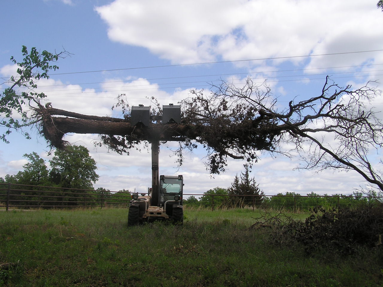

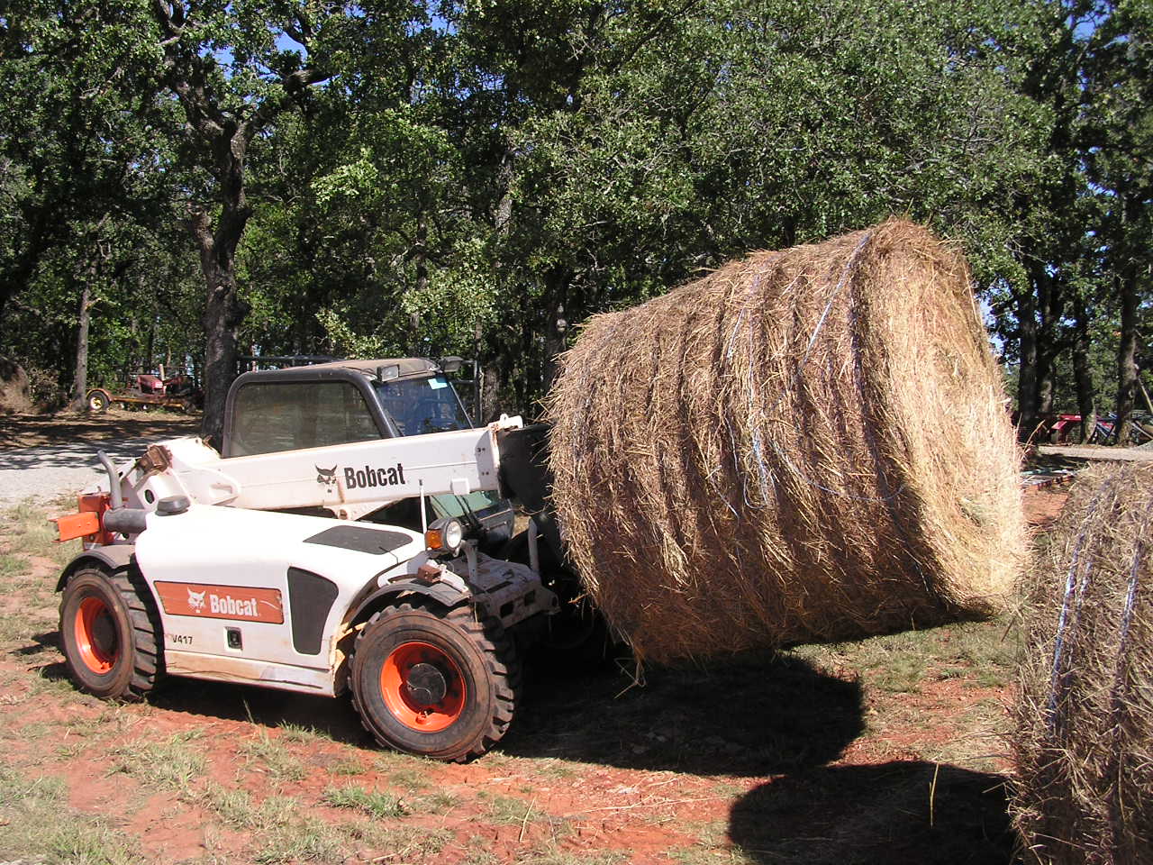

There is a machine that might be better than a tractor for you like it is for me: https://www.tractorbynet.com/forums...pact-telehandler-post3243370.html#post3243370
With a 7' brush hog:
Moving a 1300 pound, 5x6 round bale:
Moving a 40 foot long "log":
There are several companies making Compact Telehandlers, so it doesn't have to be a Bobcat.
The V519 is the one Bobcat sells now: V519 VersaHANDLER Telescopic Tool Carrier - Bobcat Company
And a thread about it: https://www.tractorbynet.com/forums...1162-v519-compact-telehandler.html?highlight=

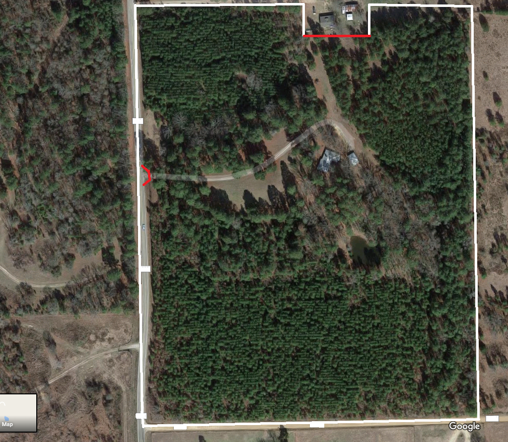

I'm in East tx also (Texarkana area) and you could plant pine in the back and far back pasture and then not have to worry about mowing. Of course that would change the type of tractor you need.
If I had your layout I would probably go with a cab and 50-60 hp size. Buy new since most brands have 0% financing. Hopefully you have a dealer within 30 minute drive.
You can see my property has mostly trees so I ended up going with a compact tractor that I bought new at Kubota (L3301). Use a zero turn to mow about 2 acres in front of my house and by the road. I'll use the tractor for clearing between trees and landscaping.
