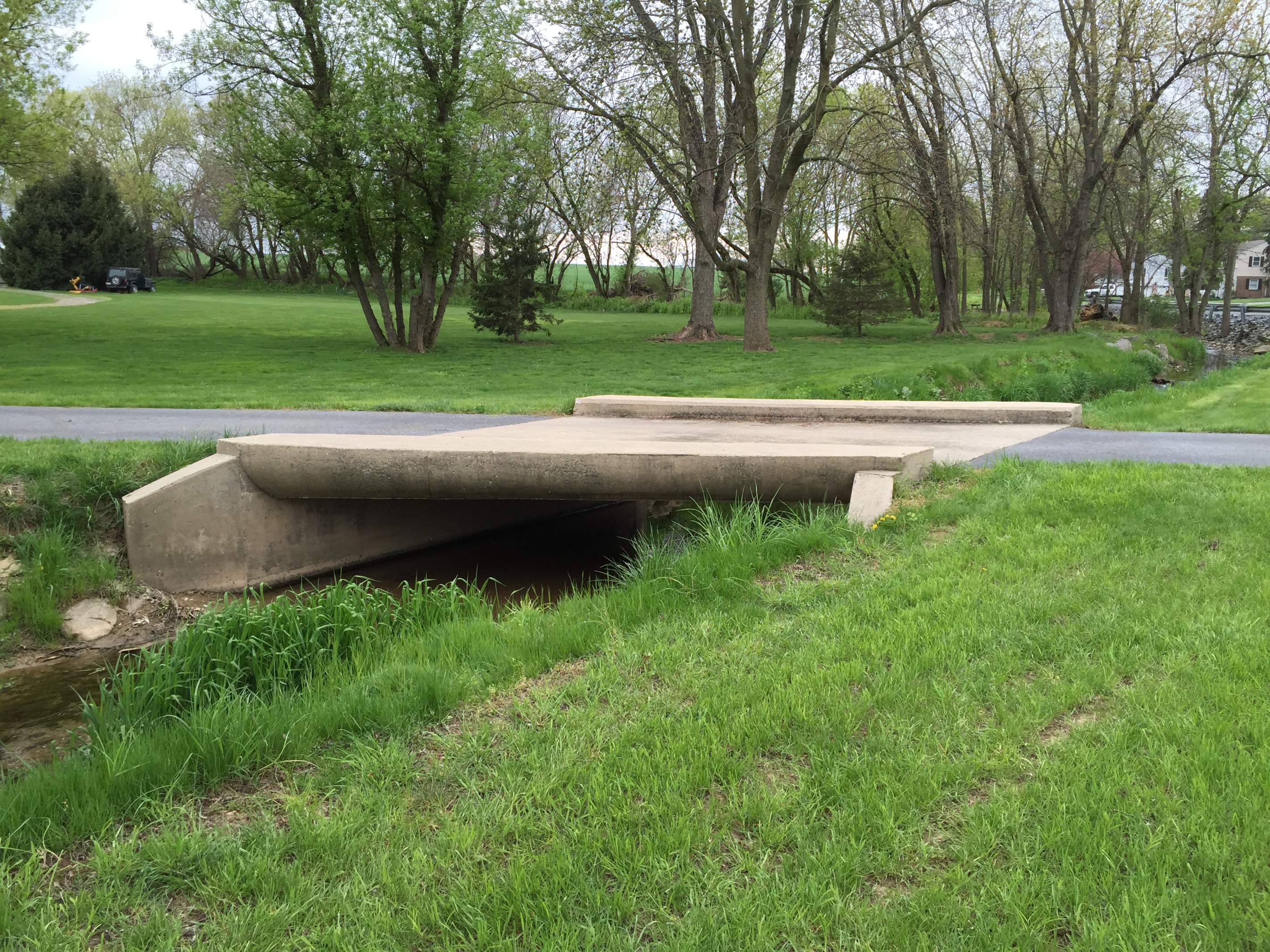

I read all the posts and unless I missed it, I thought I saw one small mention of the stream and the flood plain. Do you know anything about this stream? I lived next to one of these innocent looking streams for about 8 years. It was a very small creek 90% of the time, but during bad thunderstorms or a lot of melting snow, it became a raging river. It can be a pretty scary thing, and it took out more than one homemade bridge my neighbors tried to build.
I went by there several years later, in front of the house on the highway there was a low water bridge. After I left the state came in and redid the bridge, putting in two huge square concrete culverts. Most people looking at it would think it's ridiculous and a waste of money for such a small stream, but whoever spec'ed it out must have been there during one of the storms we used to have.

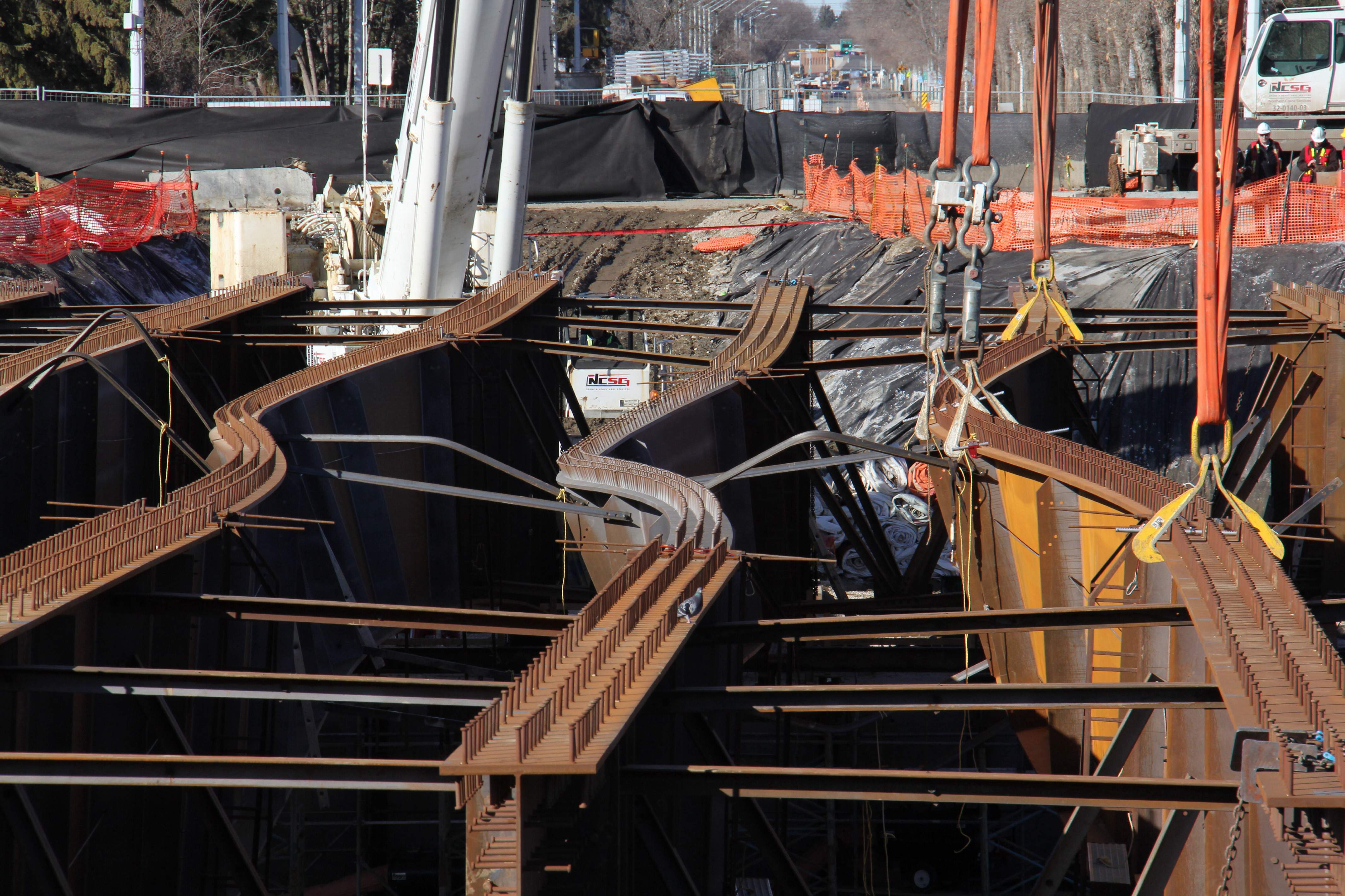

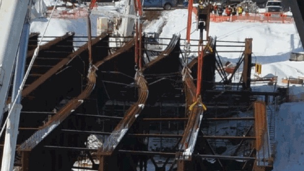

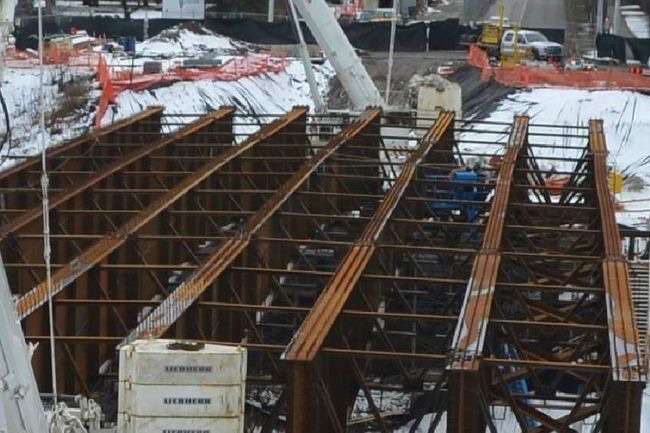

We don't need no engineering to place beams??
Or do we?
The three bent beams will be removed and repaired. It is though insufient cross bracing caused the failure.
Seems the supports didn't t fail!
/ Another bridge building question... #40
Yikes...there's a lot of money down the drain...plate girders can be squirrly.
