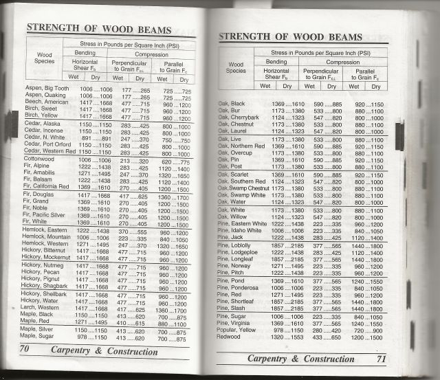

I need to build a bridge across my creek. Found a post on the topic from some years ago and have a question. One of the replies had a formula for calculating beam size:
(w*d^2)/(9*L) x (k/f)
Where (k/f) is the modulus of rupture (MOR). It gave the MOR for hemlock as 750. I need to look at other wood species, but all the tables I find give something wildly different for hemlock. Can anyone (hello LD1?) point me to the wood species table used by this formula?

Be a little careful here. You usually want to design to limit deflection, not design to failure, so we use Modulus of Elasticity, not rupture. Also, you will find that most of the formulas are based on uniform load. Bridge beams are closer to point loaded, so you have to cut the capacity in half. I never worry a lot about wood species because of the variability and just use pine and an extra factor for safety.

I agree on designing for MOE vs MOR.
Point-loading a wood beam becomes tough to find calculations for. 90% of charts, formulas, and tables that you can find are for evenly distributed loads. And even for house beams/headers the results are often listed in PLF (pounds per lineal foot).
American wood council has some good span tables/charts Calculators & Tools
As does southerpine.com Span Tables - Southern Pine

Point load capacity at center is simple. It's half of total distributed load capacity.
Not always.
I reference a chart alot that shows headers. For things like polebarns and it shows different load scenarios. Cause a polebarn header with 8' OC posts and 4' OC trusses.....the headers have a point load at mid-span. Its one of the few charts I have found that shows these numbers.
It shows a bunch of gluelam stuff as well as single and built up headers.
A 2x12 #1 SYP spanning 20' shows a uniform loading of no more than 72 plf. 72 pounds per foot for 20' is 1440lb total load. Yet the single point load at midspan is only about 1/3....coming in at 489# max.
And sometimes the point load can be greater than half the uniform load.
Take a #1 2x8 spanning 6'. Uniform load is 311 plf (311 x 6) which is 1866 pounds total. But the point load 1226.....which is about 2/3 of the uniform load.
Short spans seem to favor point loading being greater than 1/2 uniform. And longer spans to fall short of being able to sustain 1/2 uniform loading.

LD1, I have no idea why the tables show different values. I always went from the wood beam loading tables in Marks Handbook for Mechanical Engineers. It says that the loading in the tables are for uniform loading and to use half the value for a single load at mid-span. Other loading you have to do a detailed calculation. I think the 1/2 value comes directly from the stress formulas. The same relationship is shown for steel beams.

If you look at the chart though....for most common spans like 8' to 16' the numbers are pretty darn close to 1/2.
But the real short or real long spans is where deviation occurs.
Which makes sense. Because long spans...even with steel, stress is rarely the limiting factor....rather deflection is. And on really short spans....deflection is hardly a factor. Rather local stress or deformation right at the supports.
