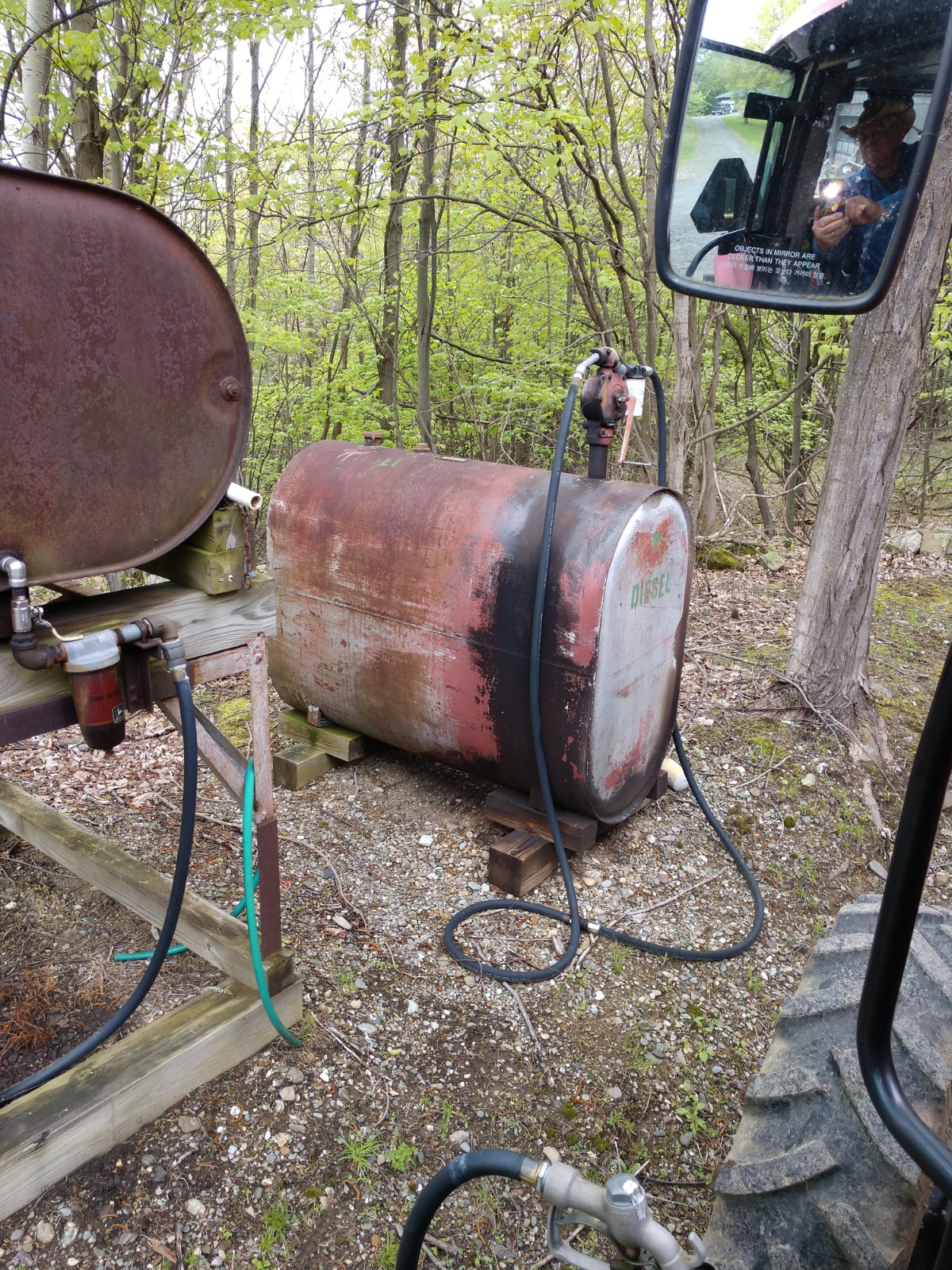

Does diesel fuel go bad and or how long is it good for?
My son just got a good used 250 gal fuel barrel last week, wants me to have off-road fuel delivered in that so we dont have bother taking my 30 gal barrel up the store that is only 5 mi away, maybe twice a year. 250 gal of fuel for me is enough for 4-5 years at current use, sounds like if I do that then I need to add some sort of diesel fuel preserver. Then there's the initial cost of 250 gal, right now ORF is at the store is $2.81/gal, that a big ouch if delivered at that price compared to going up the store with a 30 gal barrel.
   / An easier way to refuel your tractor #244
I would not do it.
Lots of condensation will form in that always less than full 250 gallon tank through the Maine seasonal changes.
   / An easier way to refuel your tractor #246
I agree..
I agree as well. I have a 500 gallon bulk diesel tank on the farm and I keep it no less than half full at all times plus I add a bio-cide regularly. If I had it do do again I'd just use my truck tank (100 gallons). Other issue with a bulk tank is, you need to drain the 'crud' off the bottom regularly too.
You run a bulk tank down, you get condensation in any climate where the temp isn't steady and water makes goo in diesel.
   / An easier way to refuel your tractor #247
I would not do it.
I agree as well. Not at your usage.
   / An easier way to refuel your tractor #248
The input was about what I expected except for the water making goo part, condensation I didn't think of, I dont want goo 3 years down the road or drain/wash barrel. I'd consider 250 gal if I used it up in 1 year but right now my 30 gal barrel was filled back in May , still 3/4 full. For the past few years my high usage has been in the winter time, so the way it's going now this fuel will go right into spring.
Maybe I should have made the 'goo' statement more clear... How about you have to drain off the crud that collects in the bottom of the tank once in a while. I call it goo because it looks gooey.

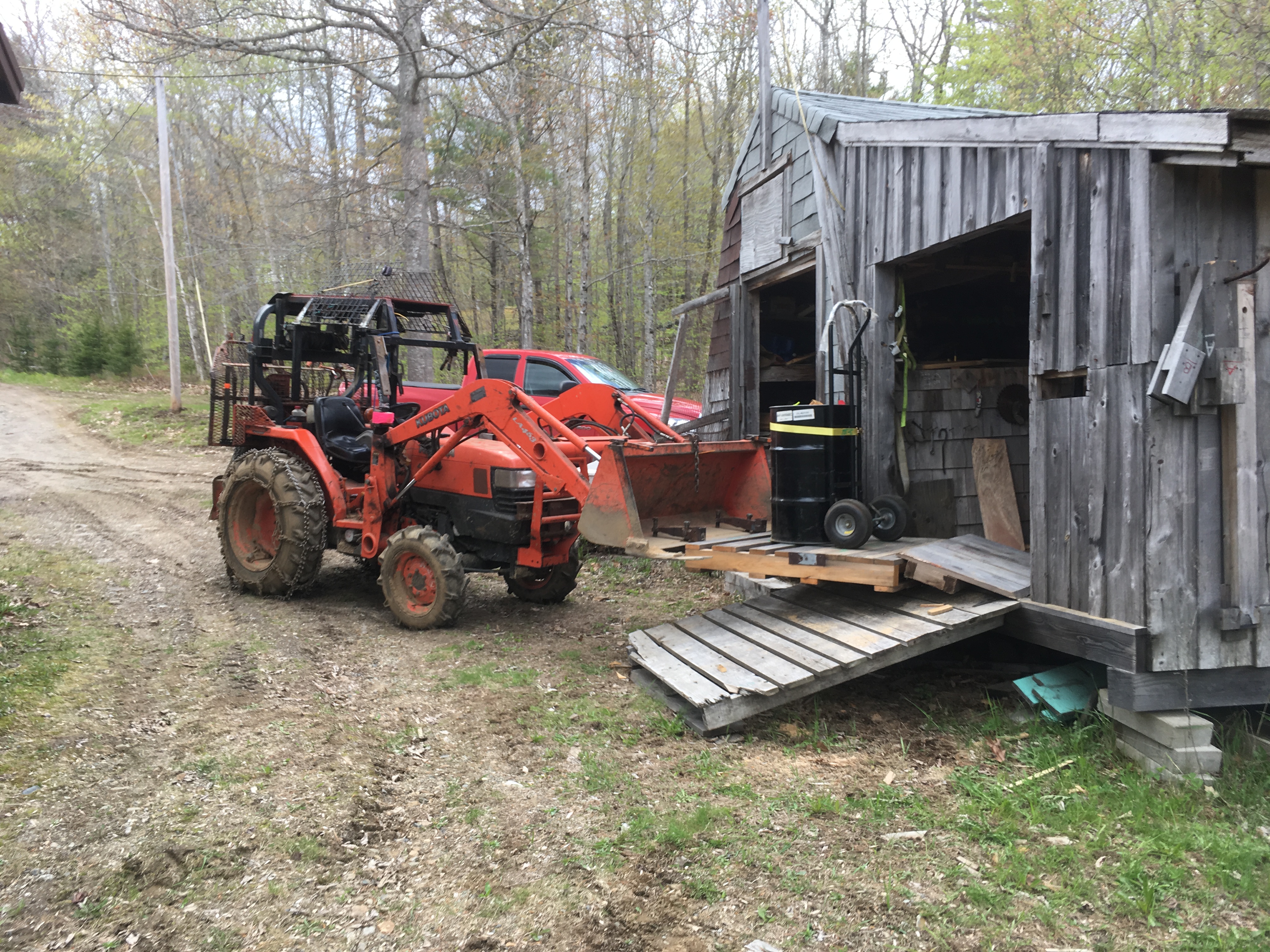

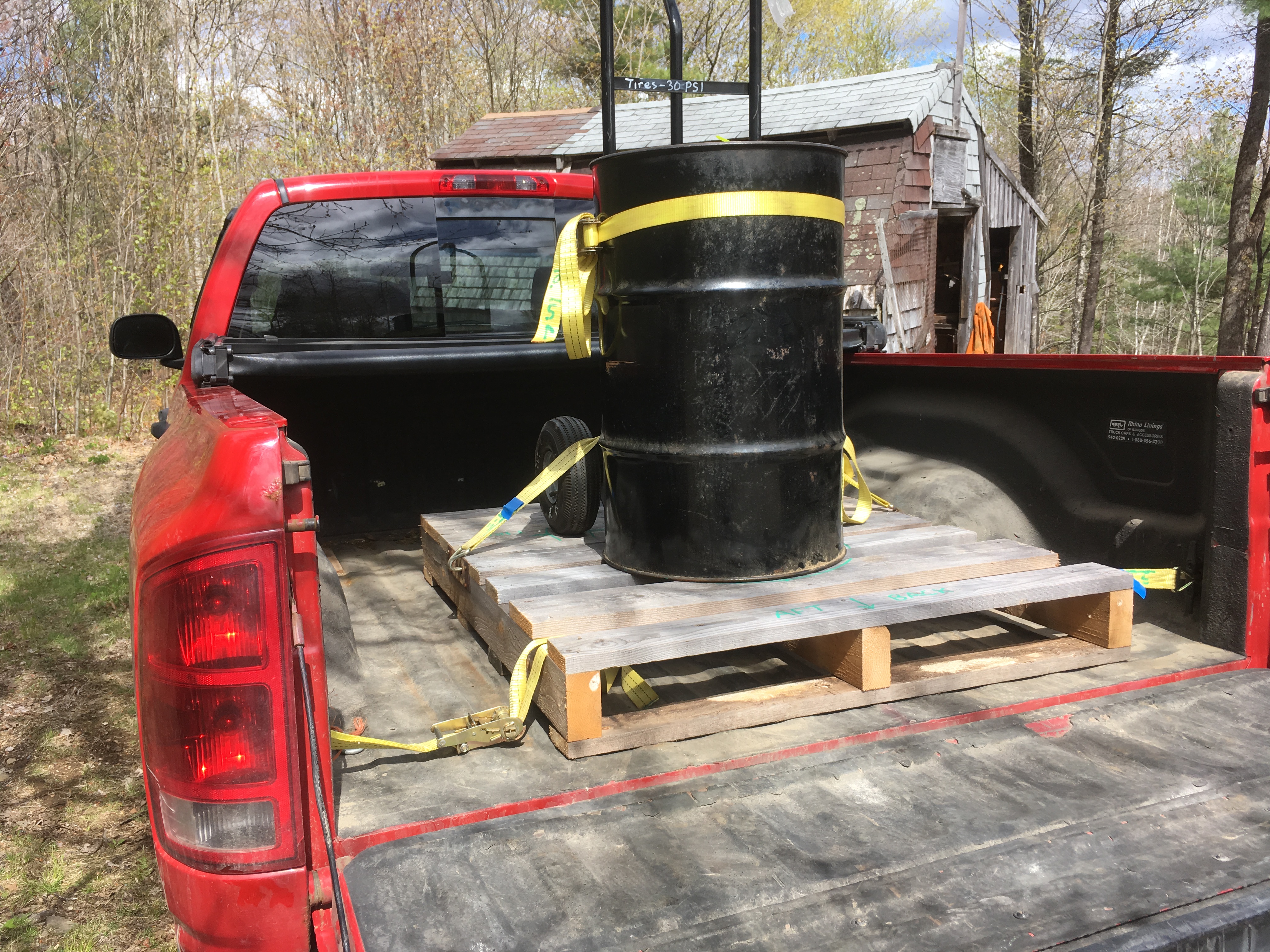

   / An easier way to refuel your tractor #254
I did the 5 gallon jug game and roaded to the fuel station in the tractor and finally stepped up to bulk tanks. That is the way to go, but does cost a good amount initially. Sorry about the photo, only thing I had on my phone.

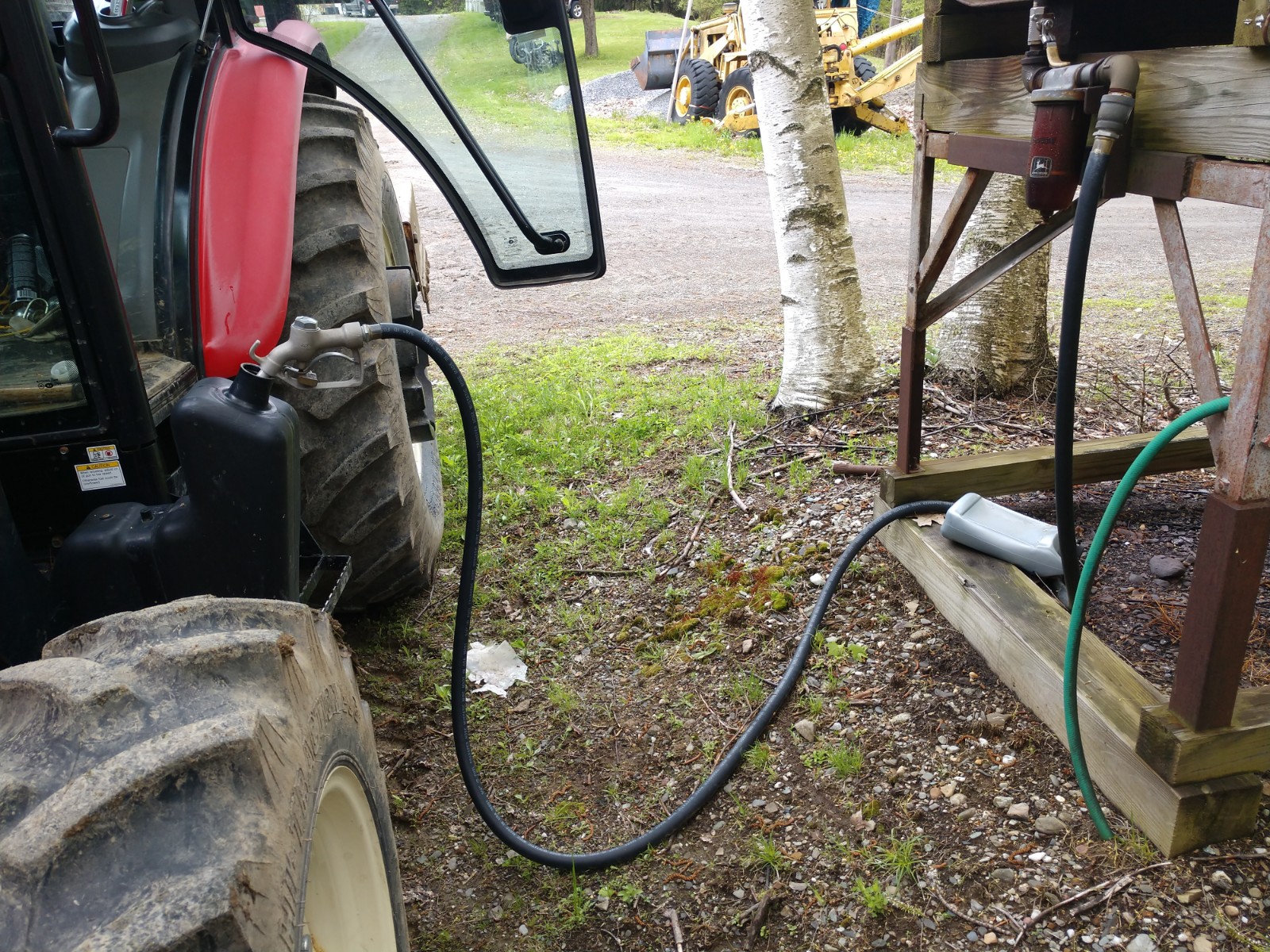

   / An easier way to refuel your tractor #260
Shared it before but this might work for some of you, you can get one on Amazon for just under $20 it is for diesel or oil empties a 5 gallon can in just under a minute with can on ground and my fuel inlet is between 5 and 6 ft from ground. I just connect it to a ground and the hot on starter because that is the handiest on my tractor.View attachment 614136
