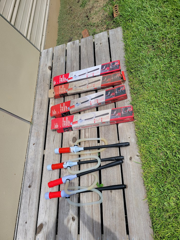

I have the worst experience with these things. I've probably had 6 or 8 in the last 4 years. I never even have to change the batteries in them before they fail.
Is there a more reliable option?
I store 20 gallons of diesel and 20 gallons of gasoline all in 5 gallon cans, and I fill my equipment 5 gallons at a time (1 can), so I don't need anything large or elaborate, just something reliable.
I filled the mower this morning with gasoline which worked fine, set the pump aside to drain while I got the 5 gal can of diesel for the tractor, about 5 minutes, and the pump completely died in those 5 minutes. I checked the batteries, they were fine (1.46v) and I changed them just to be sure, nadda, dead! I use Energizer batteries.
Any options?

I buy mine at Walmart. Probably the same as HF, but not a 40 mile round trip. Usually, the impeller comes loose. Clean it up and super glue or JB Weld will fix it. If not, they don't cost much and save work and spillage.

Nope...lol I buy a couple at a time myself when on sale in the ITC section. One thing I do is I use rechargeable Li-Ion batteries in mine, have a couple pair at all times. The bottom contact gets wonky and you need to reach in there with a long pair of hemostats or long handled needle nose pliers and pull it up a tad.

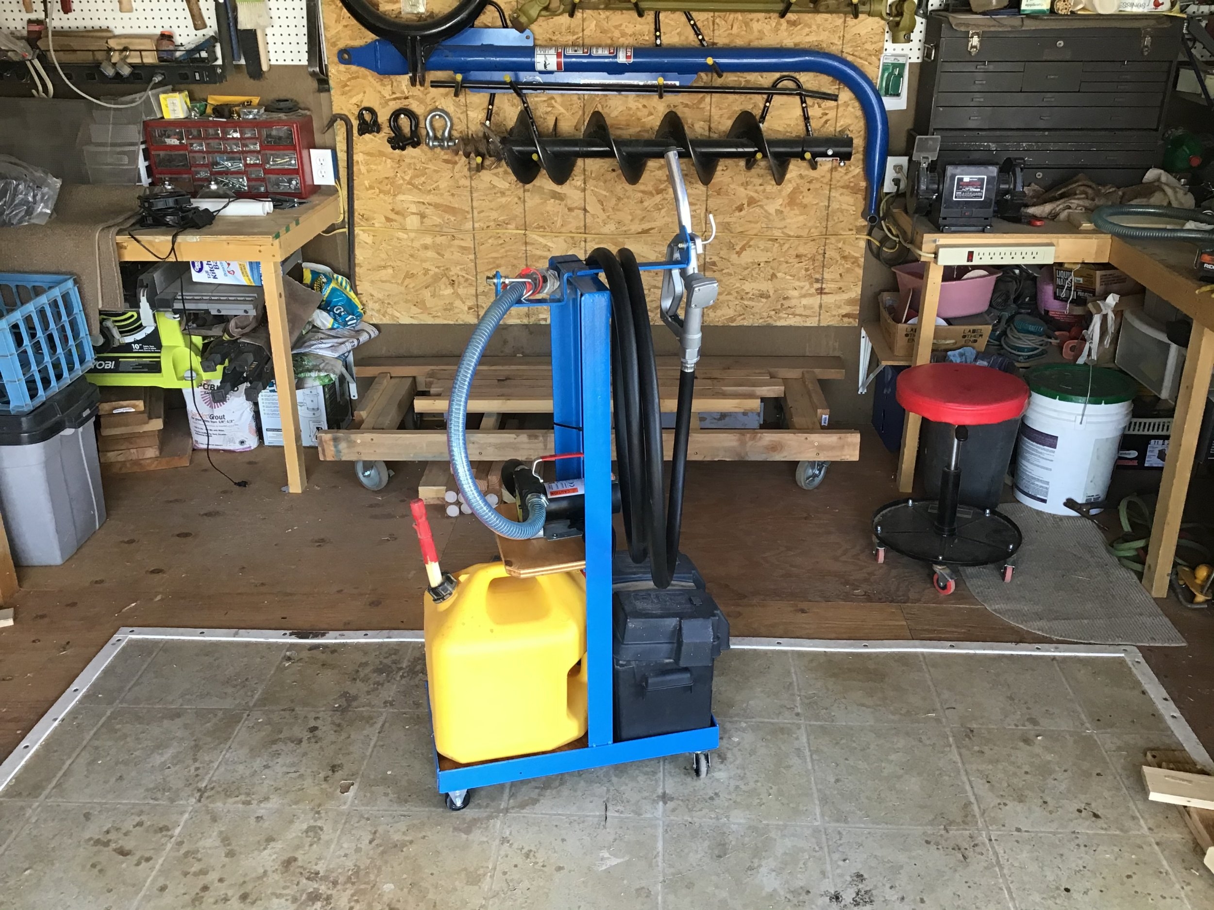

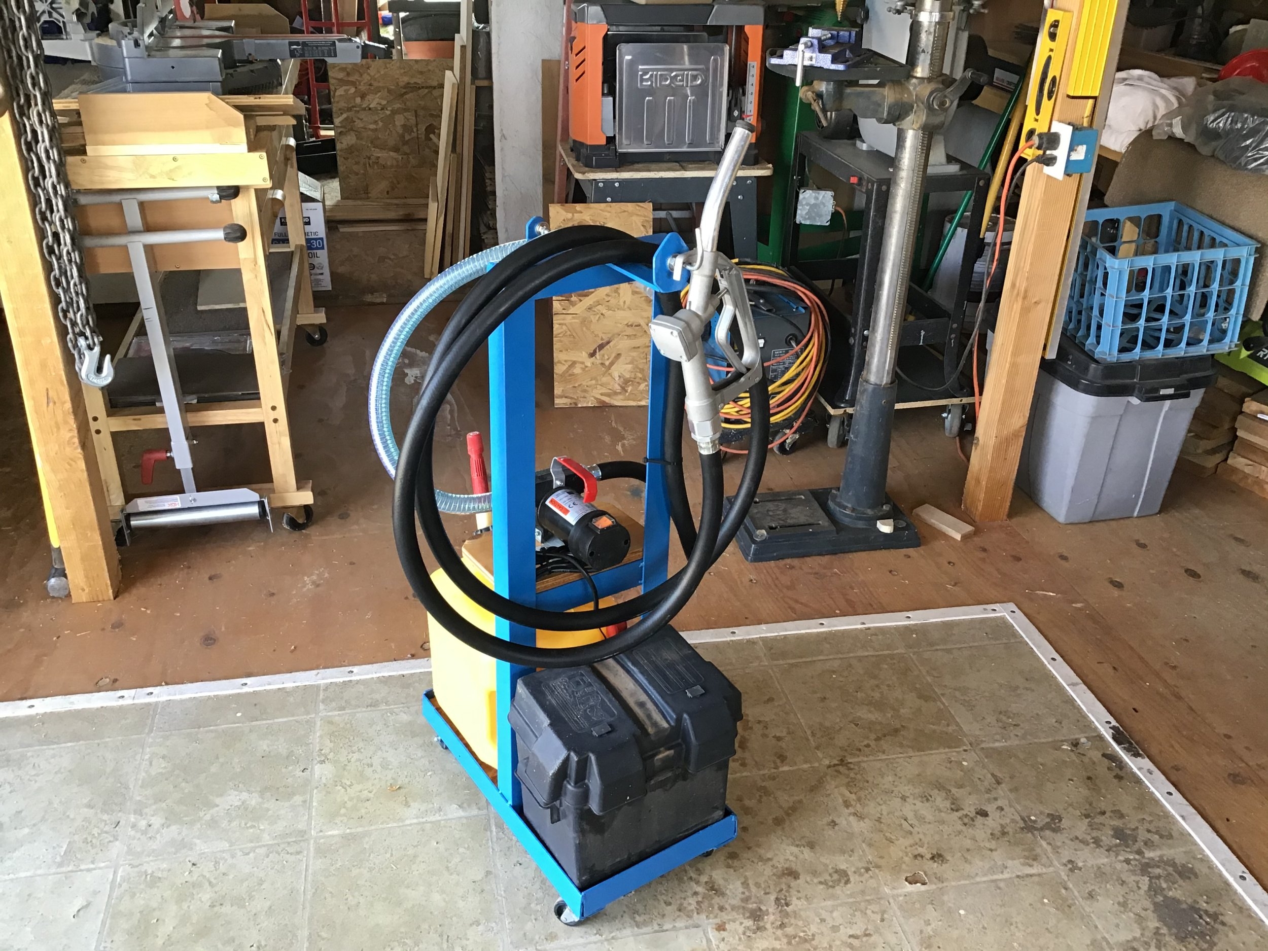

I have a decent pump for diesel fuel transfer similar to what is posted in post #10 that has lasted four years but it will not do gasoline. It is too cumbersome for 5 gal jugs but I have it mounted on the frame that holds a 50 gal reefer fuel tank that was salvaged.
