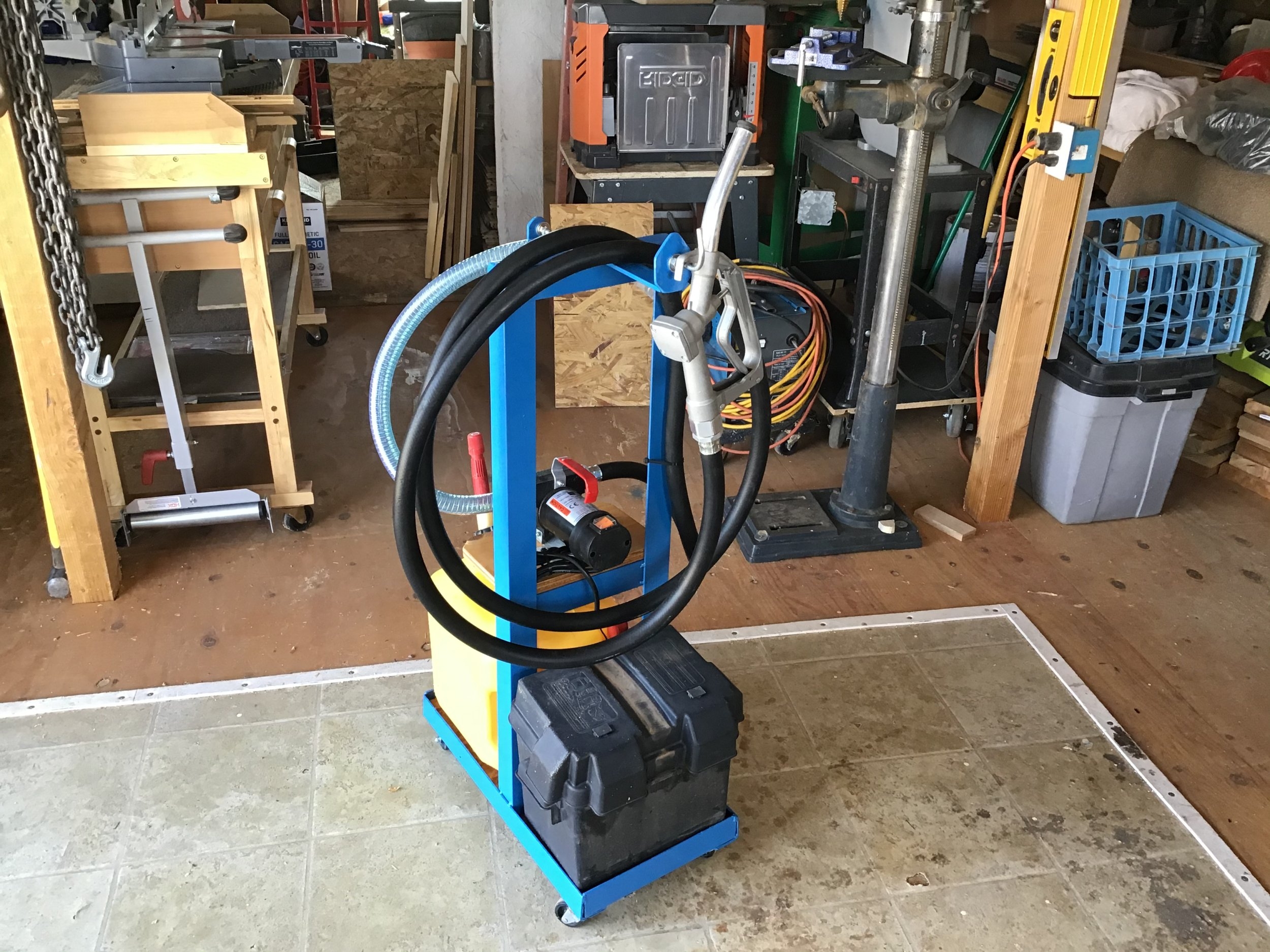

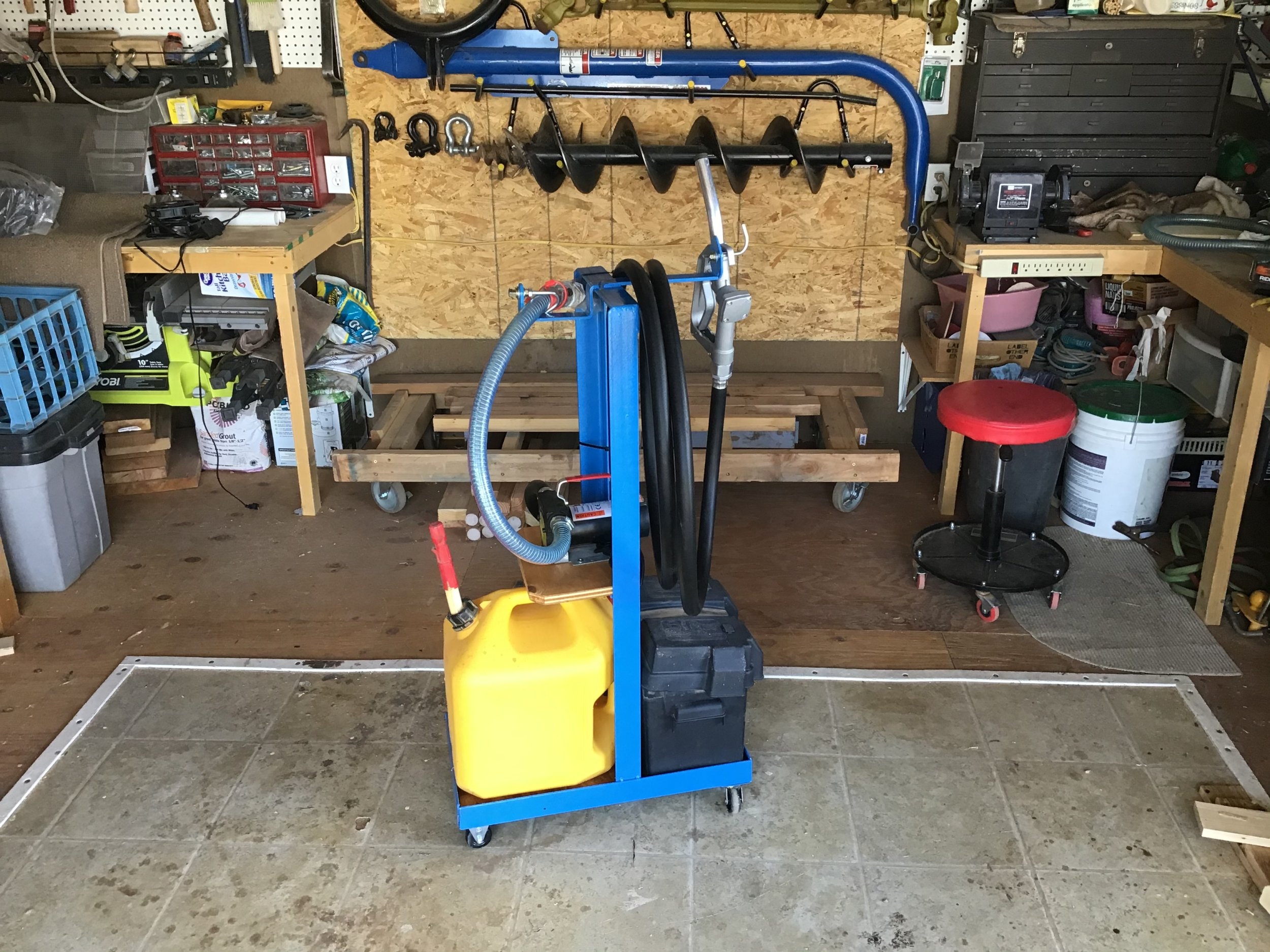

- for last 1.5-2(?)yrs. Got it while trying to make the best use of a grocer's fuel discount program since it combined with multiple gas cans let's me I'll buy 30-35 gallons of fuel (usually at steep discount given how much I'm spending on groceries per month) and then pumping it into my pickup.
Have it paired with a Dakota Lithium battery pack. It's not the cheapest setup, but being able to use the discount for the max 35 gallon purchase per transaction for the last couple years has already recouped the cost of the pump and most of the battery pack.
When I was looking Fill-Rite was one of the few manufacturer's of fuel transfer pumps that I found that actually manufactured their products to be compatible with most fuel types (that I know of) and also not require lubrication with another oil/additive.
Saw a lot of ....stuff on online retailer websites that claimed to be fuel transfer pumps, but the fine print indicated it wasn't compatible with gasoline - or required the gasoline to be mixed with oil.....
Have been happy with how it's worked thus far as it'll drain the 5 gallon cans I have faster than they can be poured through their nozzles -- at least with a power source that can supply enough electrons.
