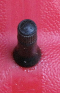

If you are stuck using normal 5 gallon jugs with the typical safety spouts that take forever to dispense 5 gallons there is a cheap and easy trick to help it breath and flow better. Get a tire valve stem for a tubeless tire and remove the guts from it. Drill a hole and install the valve in the back side of the jug where the vents use to be. Remove the valve stem cap to let it breath and flow better when filling up. It took mine from about 6 minutes to 2 minutes to empty a 5 gallon jug.

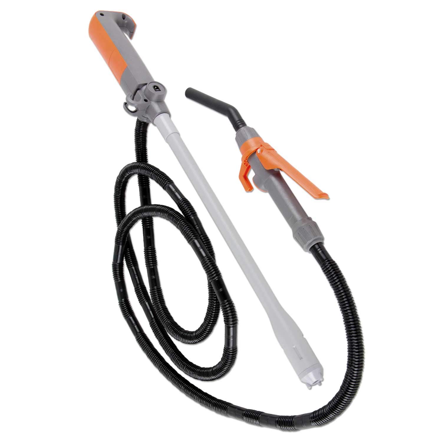

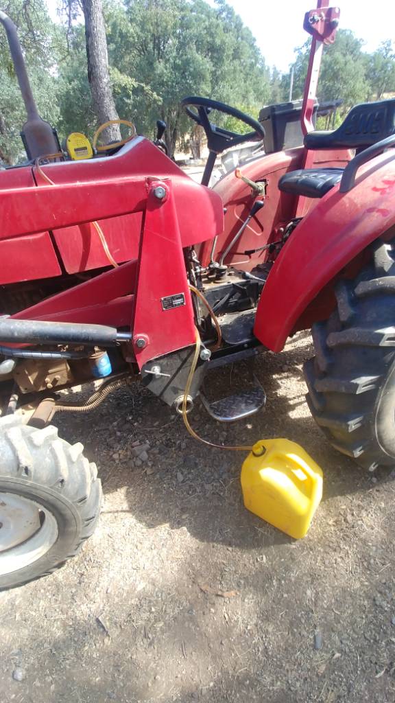

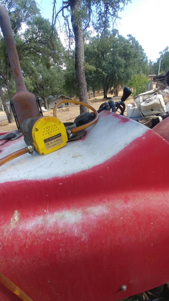

Why lift those 5 gal cans at all when you can use a pump like this:
https://www.amazon.com/gp/product/B01HOXQ5E0/ref=ppx_yo_dt_b_search_asin_title?ie=UTF8&psc=1
The hose is long enough to reach the hood fill port with the can on the ground. Takes less than 2 minutes to empty the can. The pump uses 12VDC or 110VAC and is rated for gas or diesel.

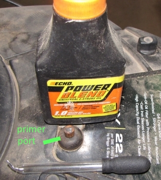

Been doen it that way a long long time. And those valve stems make a excellent primer port for those briggs that are a little difficult to start. To put a squirt of gas in the carb throat don't need to remove the filter cover for this hard starting twin.
