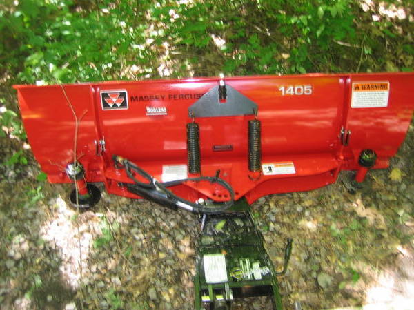

In terms of new and or used blades check with the Kubota or MF dealers. The 60" power angle blade on my Honda looks identical to the 60" blade used on the MF GC23xx series. The QA bracket mounts on the front weight bracket by means of a screw clamp. At one point I was seriously considering mounting the Honda blade on my 3320, but just kept the Honda tractor / blade instead. Here is a pic of the MF version - 60" power angle blade.
The JD weight bracket may be a bit small, but if you need the exact dimensions for the MF QA I could send them to you later. From memory about 13" x 5" x 3/8" is fairly close. It would be easy to get a correct size made that could just bolt on the existing JD bracket.

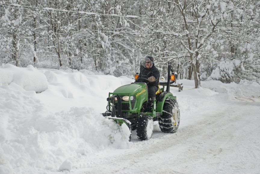

I will add my two cents in about plow width for the JD2320. A 54" plow width is without question too small for the 2320. A 54" inch plow blade angled to a full 30 deg. will leave a path approximately 47 inches wide (maybe), my 2320 measures approximately 50 inches across the rear tires. I have been running a homemade 66" for about 23 years, 21 years was with the plow attached to a JD650 which is smaller than the 2320. I am seriously thinking about a new blade of 72 inches. I may sell my old blade, maybe!
