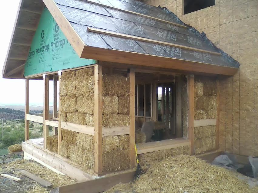

This is our spare bedroom. It juts off the side of the house, and was where I started with the bales. I got better at it and faster, but it is labor intensive. Barley is grown near here, so high quality bales are abundant. That tall frame wall was part of the original cabin, we stripped down to studs and most of the original cabin is enclosed within the footprint of the existing house now. We had someone come in and spray foam stud walls. That includes the gable end on that bedroom, where the tyvek is.

I realize straw was used by man for hundreds of years. How does it hold up? I am guessing if dry for a long time, but the change in temps I would think would be an issue, even with a good vapor barrier? Do you need to vent it extensively?
Do you screws or lags so you can open it back up?
You must have to seal that up real good for rodents.

It holds up real well if you keep it dry. A lime/cement stucco (both sides) allows some vapor transmission. Chicken wire is attached to the bales with sod staples and then tacked to the support structure, inside and out,stretched real tight. At that stage in construction you can body slam a wall and the bales should not move even a fraction of an inch. After stucco they are very solid! Our interior walls are finished with colored clay so the stucco doesn't look bad. If you had to open an exterior wall for some reason, it would be a real mess, like opening an old plaster-lath wall. And yes, for bale construction an eye for detail is critical. There should be no openings for rodents! Four years and no mice (knock on wood.)

Straw bale works really well in our dry climate. I'd be nervous about it in PA. One risk is getting bales wet during construction before stucco. Our schedule was complicated, I was burning vacation to stack bales so I didn't have a lot of flexibility, and the stucco crew was late finishing their previous job, and then we got several days of heavy rain while waiting. I had tarps up to minimize damage, and then we had about two week of dry sun, but I did end up tearing out several sections of wall because I feared the bales were damp internally. I don't know how you'd ever get them dry enough in a humid climate, although I recognize there have been a number of successful projects in the northeast.

Good call on the straw in the more humid climate. That's something I'm concerned about. It can be very humid here, rain for days on end, go from -20 in the winter to 100+ in the summer, get 3 feet of snow in a day, or 40-50 mph winds. Some of that all in the same week. So we need something stable and well insulated. One of the things she wanted to do was build into a hillside. We've seen one such house in the area, but have never been inside. I always thought that would be a good way to regulate temperature with minimal controls (and easier to defend ;) ), but I don't know about digging it all out for that. And it requires the right topology on the property, unless we make our own hill by burying the house. If we could do that I'd like to do the same thing for the animals for those extreme temperatures.

Why not just use real insulation and be done with it? Is it money thing or pride in doing it yourself? Both are cool.

That's a good question. The straw bale portions of our house has these advantages:
1) Natural materials that are locally sourced.
2) Eliminated a substantial amount of conventional lumber.
3) Quiet (18" thick walls)
4) Looks different in a good way -- nice wide window sills, curved surfaces on some interior walls***
5) Lower cost of materials (This assumes you can do substantial work yourself, otherwise this will be offset by increased labor costs).
6) Reduced flammability- This might be counter-intuitive, but densely packed straw bales don't easily carry flame. Imagine trying to burn a big phone book, the ratio of fuel to air is just no good. On the other hand, where we used spray foam insulation we had to have a 30 minute flame barrier to meet code.
Some interesting things happen when eliminate conventional stud walls. Wherever we used 2x4 or 2x6's we had to have stamped lumber, most of which came from Idaho, Oregon or Canada. But where we used big beams, we could source those from a local sawmill.
*** I should say "looks good to us". Everyone has different taste.
