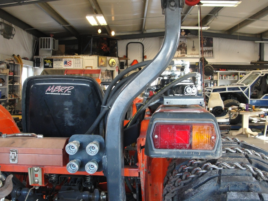

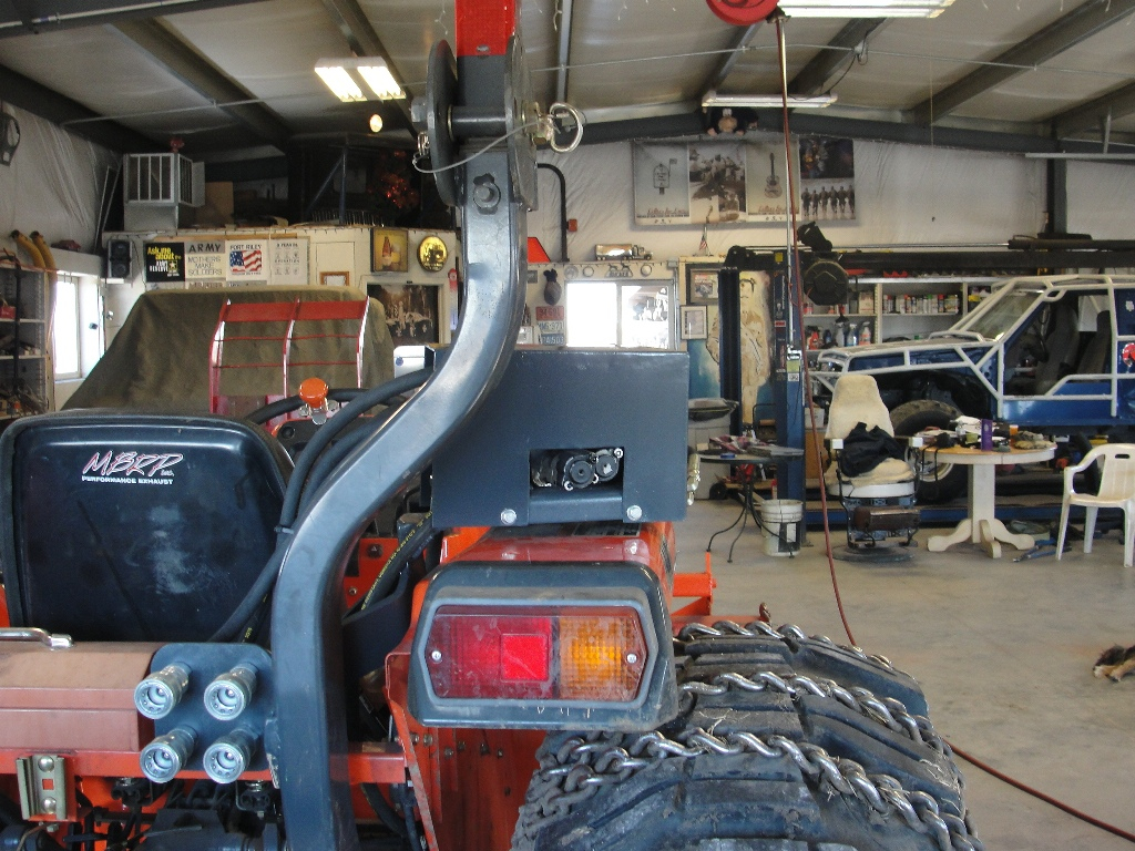

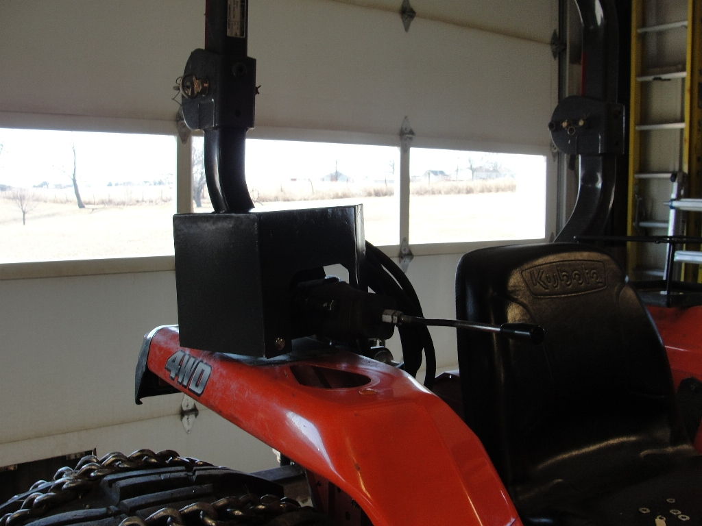

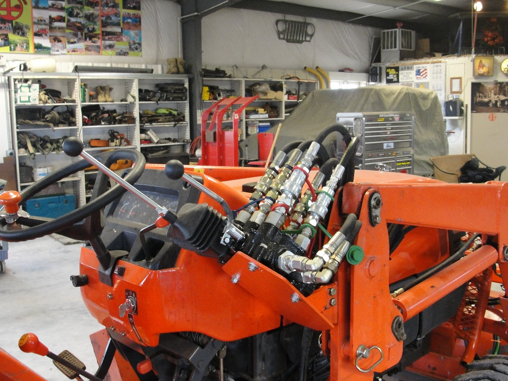

I used the valve Lou displayed to run two cylinders off one rear remote on my rear blade. For my uses a toggle switch mounted near the valve levers works fine. For Grapple use I'd want a push button on the joystick.
/ Alternative 3rd function? #44
As do I and I even had another one to add to the blade to get 3 uses out of one remote
Those devices have many uses I plumbed one into a JD forage harvester last year.
It was built for use with JD's closed center system and we had to get it to function with Pressure Compensated Closed Center which
does not lit to play with closed center applications.
We plumbed it so that when not energized the flow circulated right trough the NO ports and when energized it provided hydraulics to the closed center valve body ( an electrically controlled 5 section body header lift/ that controlled all the functions of the forage harvester, drive clutch fwd/N/rev, header lift/lower, chute rotation and defector position, and machine position in or out compared to tractor centerline) ended up working quite well.
Mother Deere had a component to perform the job for $600 plus a few other bits and pieces but didn't want to divulge the info on what it was or how it worked.
We found a wire in the Deere harness that was hot upon activation of any of the controller switchs and used it to control our electric valve,
so the diverter valve and 3 short hoses and ready to go to work. It did take considerable researching and probbing to figure it out, but a piece of cake after that.
