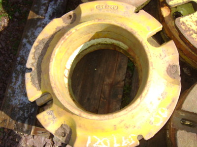

From the manual;
OMW54458
Required Minimum Tractor Ballast?00CX Loader
CAUTION: To help prevent the possibility of personal injury or death caused by tractor/loader roll over, DO NOT operate tractor/loader unless it is equipped with proper ballast.
The amount of ballast listed in the chart is the minimum required for normal loader operation. For some operations, additional ballast may be required to maximize stability.
IMPORTANT: When adding ballast, do not exceed maximum tire carrying capacity shown on sidewall.
REQUIRED MINIMUM BALLAST FOR 4105 TRACTOR
Ballast1
Tire Size
Number of Rear Wheel Weights Required per Wheel
Fluid-filled rear tires and 500 kg (1100 lb) of 3-Point hitch ballast2 and Rear wheel weights per wheel:
14.9-24, 4PR (R1) 2
17.5L-24, 8PR (R4) 1

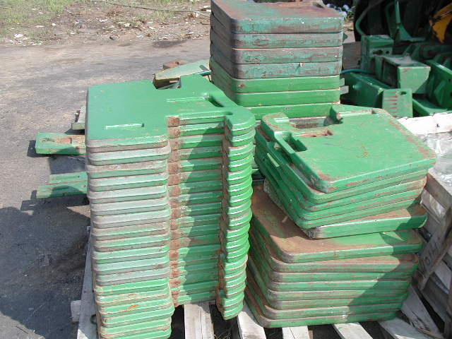

Yes it was bad that the salesperson let the rig go with a heavy bucket and no ballast box and no loaded tires. Looks like my estimation of 750 to 1000 and loaded tires was a little light with JD manual calling for loaded tires, AND 1100 lbs on the 3pt AND 1 set of rear wheel weights for the R4 tires.. And this poor guy had none of the above. Oh well, live and learn.
James K0UA
/ almost flipped the tractor, really need some help! #51
James K0UA
I think the manuals numbers are actually overkill. My ballast is only about 650 lbs and that is about half of Bobcats recommended number. But then again I'm on flat ground. I know if I had the OP's bucket and no ballast, I would be hanging the rear tires in the air going over minor dips.

Good luck with getting things set up correctly. I think it's as simple as everyone suggested, add ballast. I have a Kubota M7040, which is a little bigger than your tractor. But, I have cast iron wheels on the back of mine, kind of equivalent to wheel weights. Even with that, it's not very stable when using the FEL. I actually wouldn't even use the FEL with just that anyway, because there's too much stress on the front axle. So, I built a concrete ballast block (similar to the one in an earlier post). The one I built weighs a little over 2000lbs. Once that's on the tractor, she's very stable. And I have no concerns about being able to get up a hill. Weight carried on a tractor gives it much more traction and it doesn't really seem to slow it down, even when going up hill.
I also agree with what others have suggested and look to get a different bucket. As others have said, the dealer probably shouldn't have even sold the tractor with that bucket. I think you'd have a leg to stand on to go back and demand an exchange of the bucket for a smaller 4-1 or a regular buck, which would weigh much less.

Why didn't you just lower the fel and set her back down immediately. Ballast is a must for fel work. I have loaded tires, 4 cast wheel weights and use my 1600 pound mx8 mower for ballast. Without the mower my bucket stays inches off the ground as I work because of stability.

I have been on 3 wheels twice in 2 days. Got a weight box on ebay that handles 1000 lbs and put 600 lbs of farmall model A weights in it (4 ea) and then filled the spaces with gravel. With the 153 lbs for the box, I figure I have about 900 lbs and what a difference that made. The loader specs recommended 700 lbs.
You really need a weight box or a heavy implement on back.
