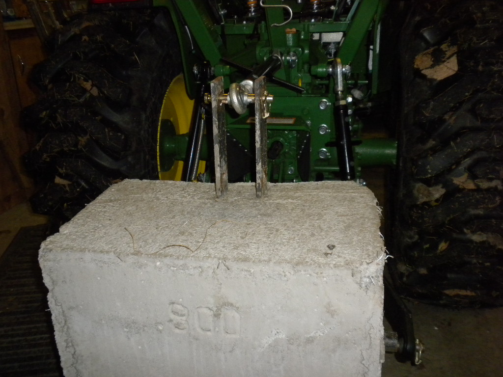

I think the manuals numbers are actually overkill. My ballast is only about 650 lbs and that is about half of Bobcats recommended number. But then again I'm on flat ground. I know if I had the OP's bucket and no ballast, I would be hanging the rear tires in the air going over minor dips.
I don't think the manual weights are "overkill", but the manuals do suggest tailoring the ballast to the project at hand.
My ballast (sand, in a ballast box) weighs about the same as yours, and I have added extra sand (in bags for "easy" removal) as required.

My land has lots of similar slopes and I've spent maybe 40 hours moving dirt on slopes like the one that tipped up the tractor.
My setup is:
Loaded(rimguard) R1's set at the maximum width.
Normal bucket.
Low range always.
4wd always on slopes.
1100lb box blade.
You can use the box blade to push dirt in reverse down a slope very safely compared to using the loader, and its low usable ballast. I'd also get a normal light bucket for everyday use and put on the 4 in 1 when its needed.
