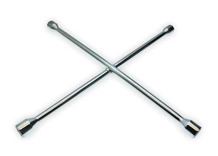

I need an impact wrench to remove lug nuts. A good cordless 1/2" one would be ideal but run $250-$300. (I want one for various reasons and plan to get one but it just isn't in the budget right now.) A good corded one would be about $150+. An air tool impact wrench can be got for about $75.
I have a 3.5 gallon, 135 psi pancake compressor. The tools I've looked up say that 90 psi is the ideal pressure and they use 5.5 cfm of air. Knowing nothing about air tools I am wondering if I could get by using my small compressor and an air impact wrench. Entire job is removing 4 wheels and then putting 4 on. I normally do this with a lug nut T wrench and the desire for an impact wrench is just pure laziness. It does not have to be fast.
Thanks for any advice.

For rotating or for brake inspections I crack 'em loose with a 4-way before jacking up & spin 'em off with a corded/cordless drill or lite duty impact, according to how well greased or not bunged up the last time off. They spin right back on with the little guys to be fully torqued in steps (20,40, 60 ft/lb, etc) once back on the ground.
Impacts usually bust stuff loose with even the smallest tank, if hoses/fittings are big enough as sound guy says. Air consumption isn't that high once they're spinning, but folks expect a lot from 'em anyway. btw: Anything else but an air-nailer is too often expecting too much from single-stage compressors or small tanks. Grinders, jitterbbugs, sand blasters, DAs, etc run best from 2-stage compressors due to volume demand. Oh, and air ratchets are air hogs too.
