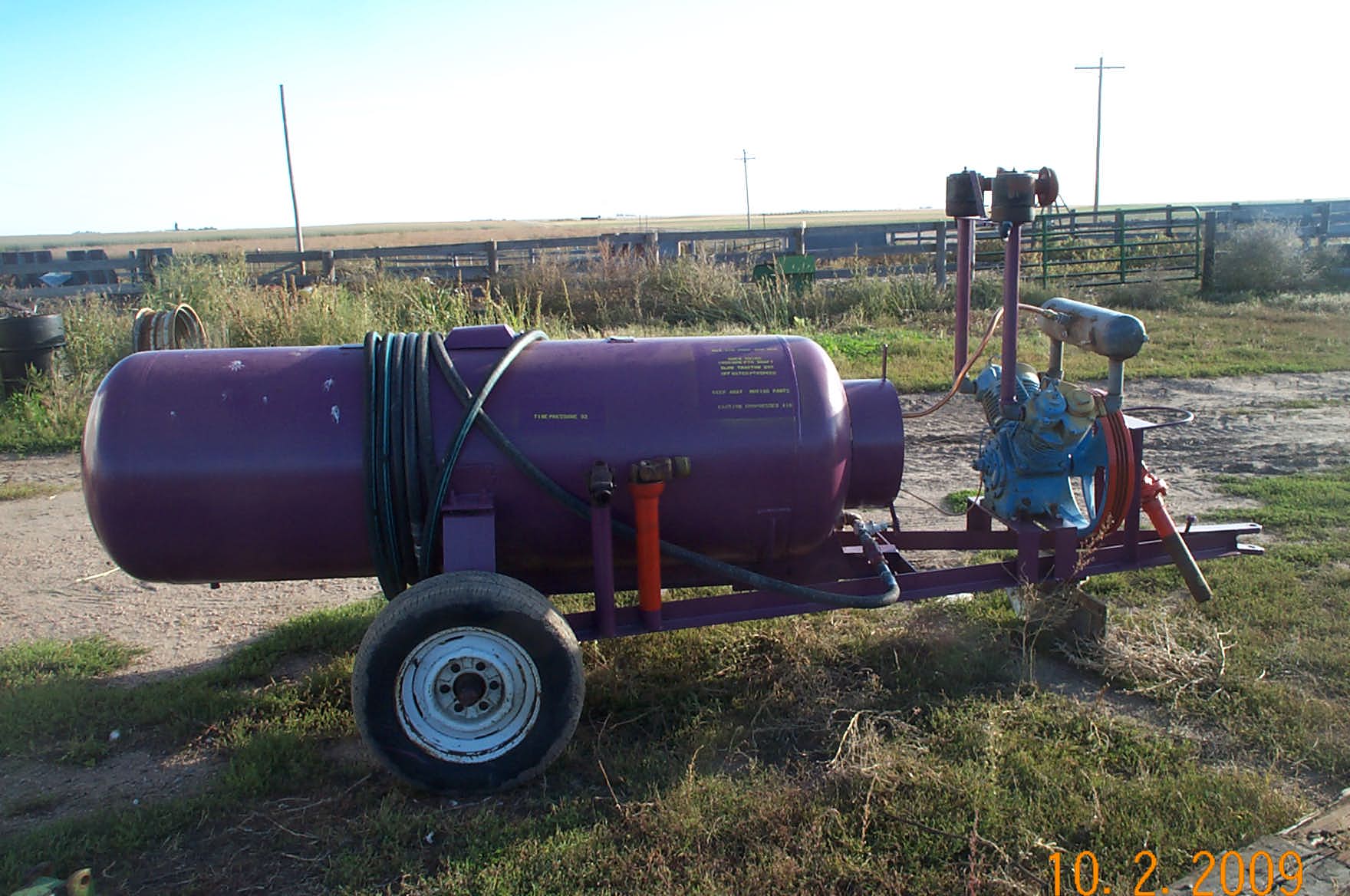

and then in my sons scrapping days he brought me a compressor head, and I made another unit for hopes of sand blasting some day, it runs off the tractor and will put out the air lots of it, (but the truth is it is not real practical),
