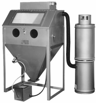

I do a fair amount of sand and bead blasting. My compressor is rated at 24+ CFM at 175PSI. I have forced air cooling for the compressor and I have a fan cooled air-air heat exchanger after the compressor tank before my extra tanks. The air goes into the extra tanks and out a different port to help cool the air as much as possible. Drains in the line are also installed where needed. This gives me nice cool and dry air. About the only way to get drier air would be with a refrigerated dryer.

For me, I purchased a air compressor from my local NAPA autoparts store. Cause I knew it would need parts in the furture, so I decided to purchase locally. I mainly use my compressor for sandblasting. Which we all know uses a ton of air. Sandblasting is the hardest job for a air compressor. I paid a little over $1600 dollars for my air compressor. Which is high, but my air compressor has paid for itself over several times. But, I had to purchased a blast cabinet also. I use the blast cabinet and air compressor to clean parts that I then paint and put on eBay. The blast cabinet cost me a little over $1000. All of the parts that I have cleaned and painted and sold on eBay, I have $O dollars now in my compressor and blast cabinet. Auto restoration is big on eBay, so if you guys want a big compressor, you can take my route and in the end, you'll have a free air compressor.

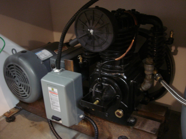

My compressor is a Champion Centurion II Model VRV7F-8 (7.5 HP baldor motor with the RV-15A pump). According to their web site
http://www.gardnerdenverproducts.co...iprocating/Brochures/C1-1-7-220 _5th_1-06.pdf
the specs for my compressor is...compressor rpm 990, 125PSI CFM displacement is 28.7, CFM delivery 23.9, 175 PSI is CFM displacement is 28.7, and CFM delivery is 23.1. My manual shows what I posted but the RPM is greater - just over 1000. However I'm sure specs have changed in the past 5 years.

Since I knew I was going be doing a ton of sandblasting, I wanted a two stage and a 80 gal tank. Two stage is the only way to go if you need a ton of air like in sandblasting. When I use a impact or a paint gun, I have to turn the pressure way done. When I use a paint gun, the pressure has to be way done (35-40~ primer or paint). If I blast cast iron or steel that is real rusty, I use 100 lbs. I use about 70-80 lbs for my impacts. I've never used anything above 100 lbs.

The 7.5 motor uses 32 amp run (per leg)..Here are some specs on it:
Full Load Torque 22.5 LB-FT
Break Down Torque 52 LB-FT 231 % of F.L. Torque
Locked-Roter Torque 53 LB-FT
Starting Current (Amps) 184.0 :eek: :eek:
I purchased the 7.5 HP because I don't have 3-phase at the house and it's the largest I could find to run on single phase current. I have a "serious" hobby and do all sorts of restorations, fixing, creating, etc. I knew I wanted it to run my bead blast cabinet, pressure sand blaster, etc. I considered a screw compressor, but most of those only do 125 PSI and I wanted the 175 PSI for operating my tire changing equipment. With 125 there were several times I couldn't easily dismount a tire that was on a rim for a long time. With my sand blaster the unit has a tough time recovering. - which is another reason for the 300+ gal air storage. The guy I bought the compressor from was trying to talk me into the 5hp version. Boy I'm glad I stuck to my guns and got the 7.5. I did a bunch of research and calculations and knew I needed over 20CFM for my max use.
Depending on my media I run 60-100 psi in the blast cabinet. I run 120-125 in the pressure blaster. I use line pressure for the tire equipment and I regulate the air line drops to 100. My spray gun is a Sata NR95 HVLP gun so it requires about 50 psi at the gun (which produces 10 psi cap pressure) it uses 13CFM. I also use my air compressor to feed a full face respirator for painting. (yes it runs through special filters to remove contaminates) So that is another 3-4 CFM for it.
So, yes, I'm very pleased with my compressor.
