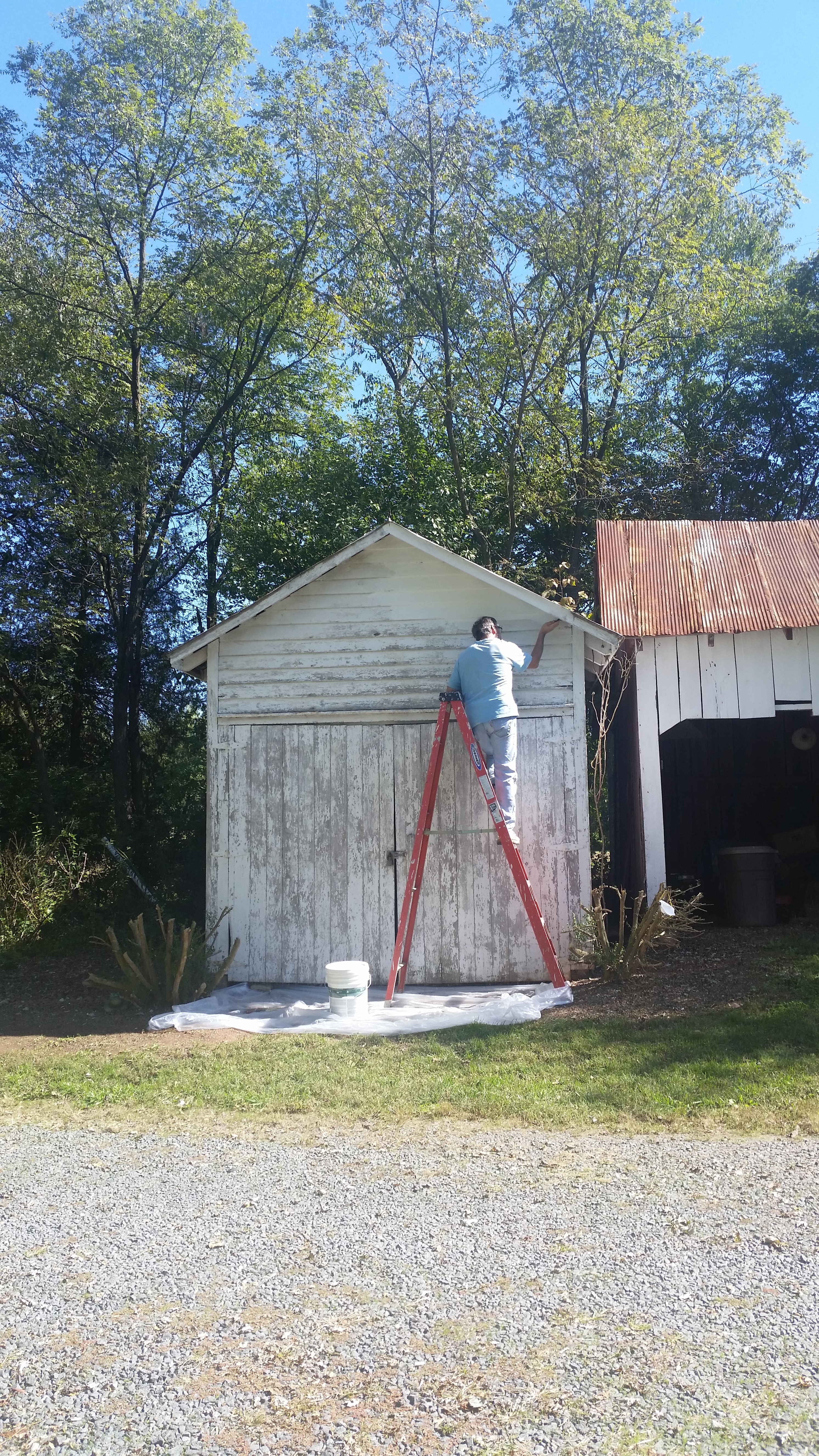

I have been swayed to look at the airless. In fact, I completely forgot about my outbuildings. Guess one doesn't think about bad things. LOL.
In any case, the airless looks to be the right tool for the job, and has the benefit of simplicity in setup and operations. The price point, especially with the super coupon from HF, looks agreeable. Thanks for pointing that out George2615.
