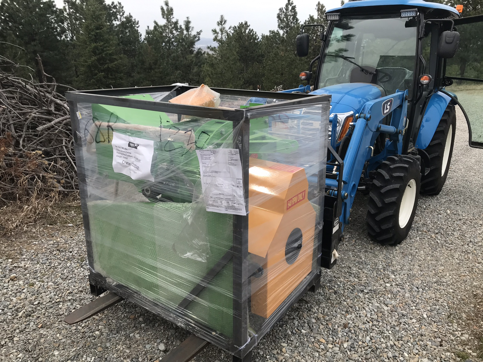

Update:
My Woodland Mills WC68 arrived today along with my Woodland Mills HM126 saw mill and the 16' trailer.
My wife and I assembled the chipper in about an hour and a half which included cutting the PTO shaft and filling the 5 gallon tank with hydraulic fluid. That part took a long time. It was cold and the fluid was thick and the filler hole has a wire screen in it that made pouring go very slowly.
Anyway, we got it running and ran some brush through it. Works very well. No real issues to speak of. Agree, it makes wood chips more so than "mulch" but the wood chips are what we need.
I had actual decided to buy the saw mill before deciding to buy the chipper. The clincher was that a great deal of the scraps from the mill can go into the chipper.
My daughter and her husband (they are half owners in the saw mill) will help my wife and I assemble the mill and trailer this weekend.
Side note: My Kubota L4400 (with pallet forks on the bucket) was adequate for lifting and moving the chipper (800+ lbs) and the trailer pallet (500+ lbs). It was not adequate for lifting the mill which was about 1000 pounds. It did it but it was dicey and I had to go super slow and barely breath on the joy stick inputs. I had a box blade (maybe 400 pounds) on the back and loaded tires. I think this showed the weakness of bucket forks. The loader is rated at about 1700 pounds at the pins but forks on the bucket are way out there.
