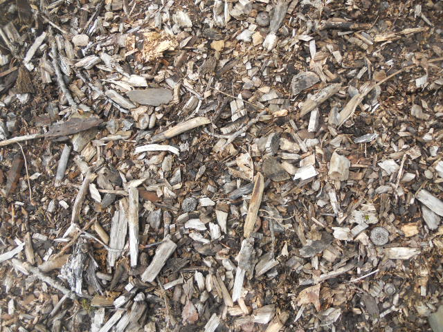

I bought a Chinese PTO chipper a number of years back 1000lbs, auto-feed, rated for 6" logs. I used it primarily for saplings when clearing land and also for tree branches with leaves. It did a great job with the saplings and was flawless. For larger branches, it did an ok job but the chute would get clogged up and it takes time to clear it out. Would I recommend getting one like this? If saplings and branches with leaves, absolutely. Larger stuff to avoid clog-up will require you to wait for the item to be chipped before putting in the next one but lets face it, do any of us? Chips are like pea gravel size with occasional shreds. Here's a sample of last year's chipping. A lot of the stuff in the pic was long dead, fresh cut stuff chips beautifully and looks great.

/ Advice on PTO Chipper #33
Those chips look like mine from the WM-8H. But i am patient and do one large branch at a time. Works well.
