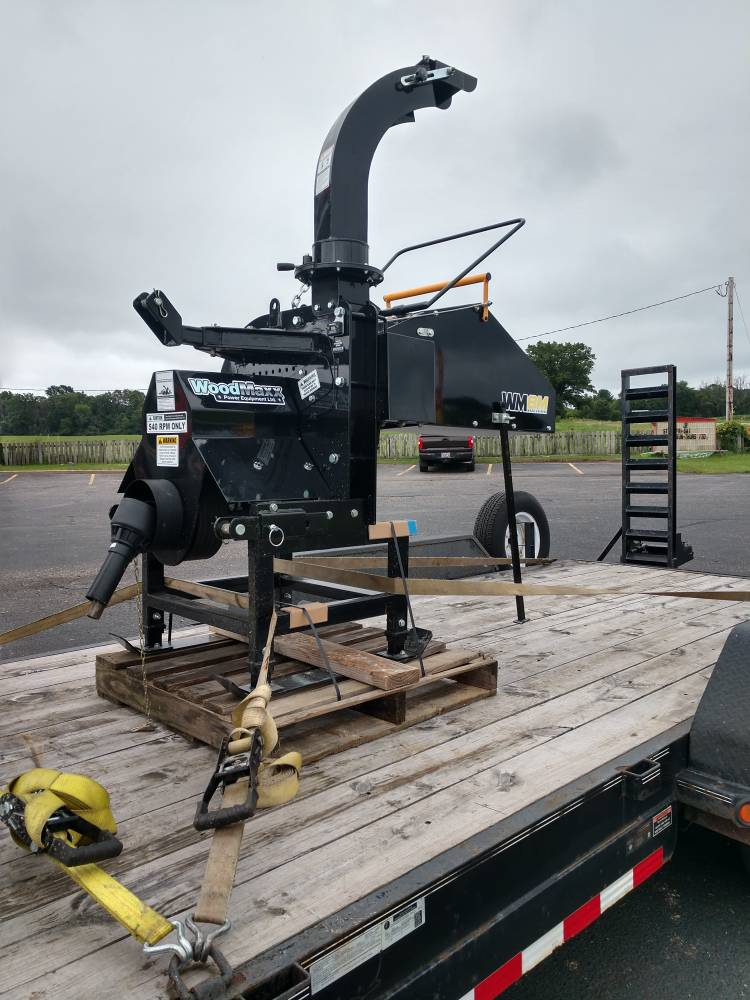

My Branson has 32 hp at the PTO. I have a Woodmaxx 8H chipper. I can chip hardwood up to about 4" diameter without slowing the chipper feed. Above that I need to slow the feed down to about the minimum speed. I have chipped stuff close to the size that fits in the chipper but it was Madrone which machines really well for hardwood and I had to stop and start the chipper in short bursts. It sure made a lot of chips fast though.
Woodland Mills says you need 60hp to chip 8" material with the WC88. That sounds about right. 8" stuff is pretty large and heavy. If it's got a stub or curve it may jam in the chipper.

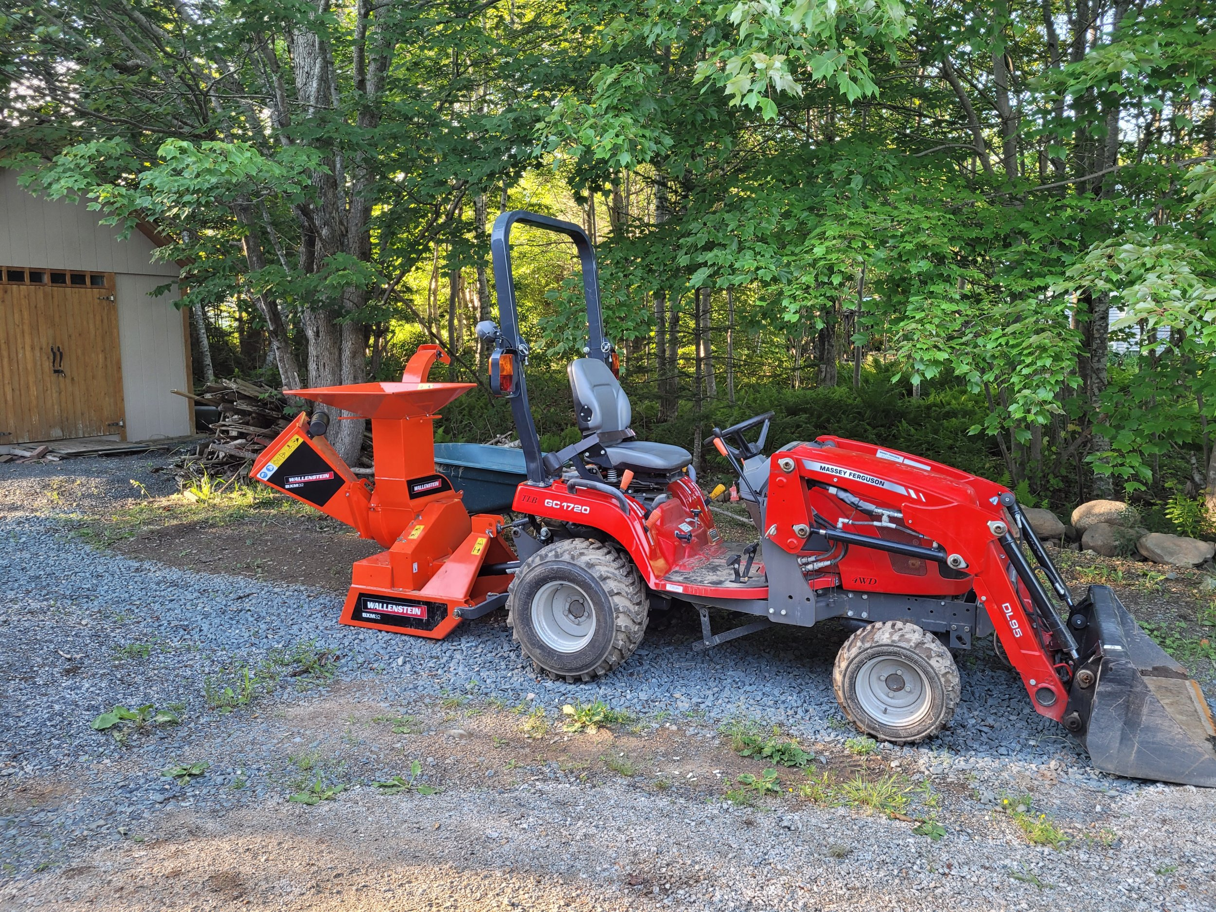

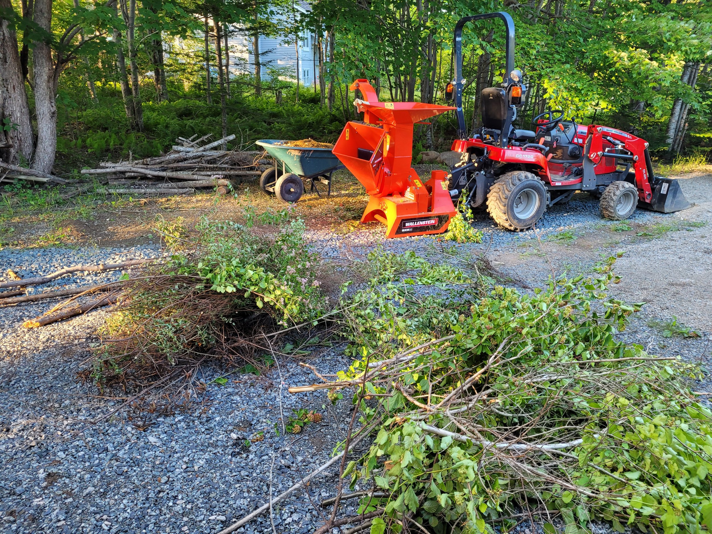

I have a Kubota L4400. Same horsepower as your L4600. I have the WC-68. Nothing that I put in it slows the tractor down at all that I can hear or see.
So I suspect you will be fine but before spending extra money ask yourself why you need the bigger chipper. The WC-68 is spec'd to handle 6 inch stuff. I almost never put anything that large in it. That is for several reasons. If it is hardwood then 6-8 inch stuff is going to be firewood. If it is pine or cedar it gets chipped but it is not that often I'm encountering 6-8" pine limbs. (For me, pine logs go to the sawmill, not the chipper.)
On the other hand be aware that if you have your 6" capable chipper set up to take 1-4" inch stuff it may not take a full 6" piece easily. That requires an adjustment of the infeed roller spring. And if you have it set to take the maximum diameter it tends not to take the smaller stuff quite as well. Also consider that a 4 inch limb with a crotch that spans 7" will not pass a 6" infeed chute. An 8" chipper will help but you'll run into the same problem if you add 2" to the numbers above.
I considered the WC-88. Glad I did not spend the extra money. There hasn't been a situation yet in which I felt like I needed to chip 8" diameter stuff and by far the majority of stuff I end up chipping is under 4".
As for vibration issues I do not find it a problem. At first it was because I did not know any better but I do not hold onto the stuff I'm putting in because the vibration can indeed be violent but also because the infeed roller causes branches to twist and turn suddenly. You can get a branch across the face if you aren't careful. I stand to one side and chuck stuff in. If it gets hung up or won't feed I either reverse the roller or push it in with another piece. There are ways to avoid the vibration. If it is still an issue you can get anti-vibration gloves that might help a little.
