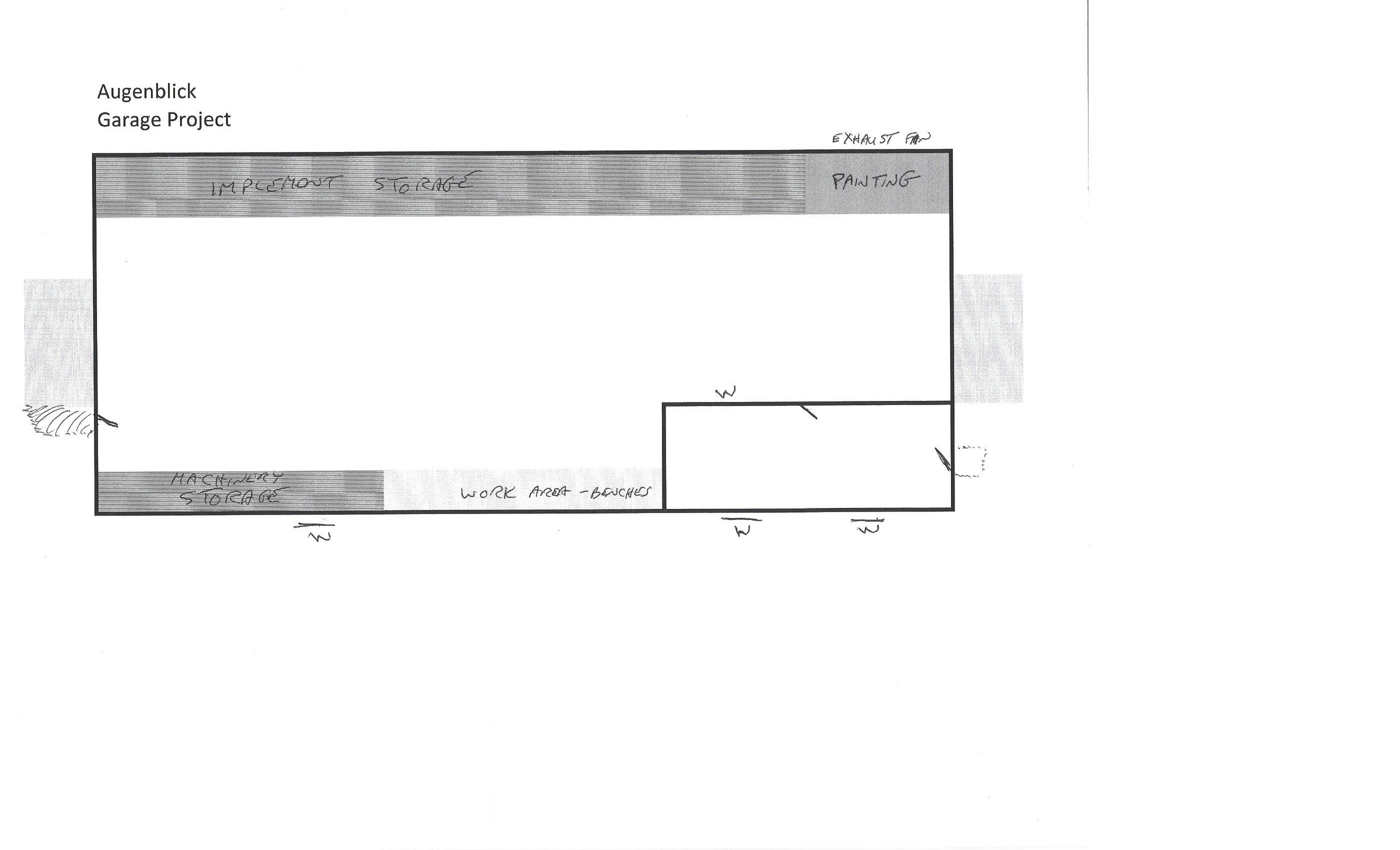

Yes, a metal roof is going on next week. Not sure what you are referring to. We extended the roof two feet to keep the interior drier, with open sides and front.
Not sure why all this wood was needed on the roof. Personally I think the shed is totally overbuilt, plus all that wood adds weight up high. I wanted a basic storage shed; likely this builder knows only how to build one way, and I was hesitant to get him out of his comfort area. Now...if I had only asked for a nine foot opening instead of ten...I think the building is too high. I need to get my cab tractor under on the left side, but he sized this I think for a ten foot door. No door...
My ignorance is clearly showing. And no, I didn't get any plans, drawings whatsoever. Builder said he usually works without them. If I wanted plans, I needed an architect. Next time, I do this with drawings, if there is a next time. Frankly, I think when they are done it will look just fine. And hopefully last a lot longer than I had plans for. I'm only going to be here maybe ten years at the most before my health takes me elsewhere, so for once I'm not looking to build for all eternity. A generation, or two, would be fine from a resale standpoint.

What product was applied to your roof on top of the sheeting? It looks like a self sealing membrane to me. Maybe it's just a Felton tar paper. I agree it's over built.
/ Advice on new barn construction needed #64
At first I thought there was no such thing as overbuilt, but looking back at your pictures, I can see that I'm wrong. How old is your builder? I've seen young guys do this because they lack experience or an understanding in engineering. They just do everything the same way, regardless of span or finish desired.
How far apart are your trusses? What type of metal are you using for your roof?
For a metal roof, trusses can be as close as 4 feet, which makes it easy to use purlins on the flat. Going farther apart saves you money on what you pay for trusses and then you use your purlins on the edge. The extra cost of larger lumber for the purlins is going to be less then the cost of the trusses. I was trying to count how many trusses you have, and figure out their spacing. Are they one foot apart? If so, that's just crazy wasteful of your money buying what you don't need. Adding decking, then using a high dollar membrane is even more wasteful. It's like he has an unlimited fund to spend money on materials!!!! The only time you would deck a roof when using metal is when you use standing seam metal, which is going to be a lot more money then R panels. It's prettier because you don't see any screws holding it in place, but it's weaker and you need the decking underneath to hold it in place and attach the hidden fasteners. This is the most expensive way to build a metal roof!!!!

What size building is that? I would have put the trusses 4' on center and stripped it with 2"x4"s on 2' centers. What size is that LVL?
/ Advice on new barn construction needed #66
Ok I found its 15' x 40'. Could probably have used a 9-1/4" LVL on the rear. If there was another post on the front could have used a smaller LVL there. Can't have the opening and the smaller LVL.
/ Advice on new barn construction needed #67
Seems like he spent as much as he could on those beams too!!! There was no need for them on the end walls, that was just throwing money away there. Doubling them up wasn't needed either. He could have used a 2x6 onto the side of the beam keep the wall flat for the siding and been more then strong enough. Again, it points to a spending spree without any knowledge of what was needed, or caring what it cost.

well...18 inches on center, savings of 500 bucks to go to 24 on center, so I stuck with his first suggestion. yes, this crew only knows how to build one way, as good as they know how. That was clear as soon as they started. But, I had a fixed price, which was ten grand less than the first quote. For comparable construction.
This will be twenty grand with the back closed in, which I chose to do, and extending the roof two feet on each side. That was all the money I wanted to spend on this, frankly would have been thrilled with five grand less, but I wanted to give the business to this fireman builder. And for sure, I have clearly paid more than I could have, but if I got value for what I paid, then I guess one should be content. The building can be converted into something more than a shed later.

If he used end trusses might have needed them to sit on the LVL. Hey I'm a Charlotte firefighter. I give my customers a drawing of the structure and a detail of the building in the proposal. He could have definitly built it differently to save material/labor costs but you will have a very nice building. People that do residential work do not understand pole building methods. And there are many different ways to do pole buildings. Just be happy with the GC you pick and the finished product.

assume you meant 16" oc, 18" in not normal. I like to go 16' oc if sheathing, even if you can go 24". I just like it better for minimal increase in material.
That will be a nice sturdy building.
/ Advice on new barn construction needed #72
yea, 18" dont work out with 4' wide or 8' long sheathing, lumber, etc.
Agree it was way overkill. Spending more money for upsizing and strengthening where it aint required isnt a good value IMO. I Could have laid 12" block, built walls with 2x12's, poured a 12" thick floor, and set my 4' OC trusses a foot apart, but where is the added value in that?
