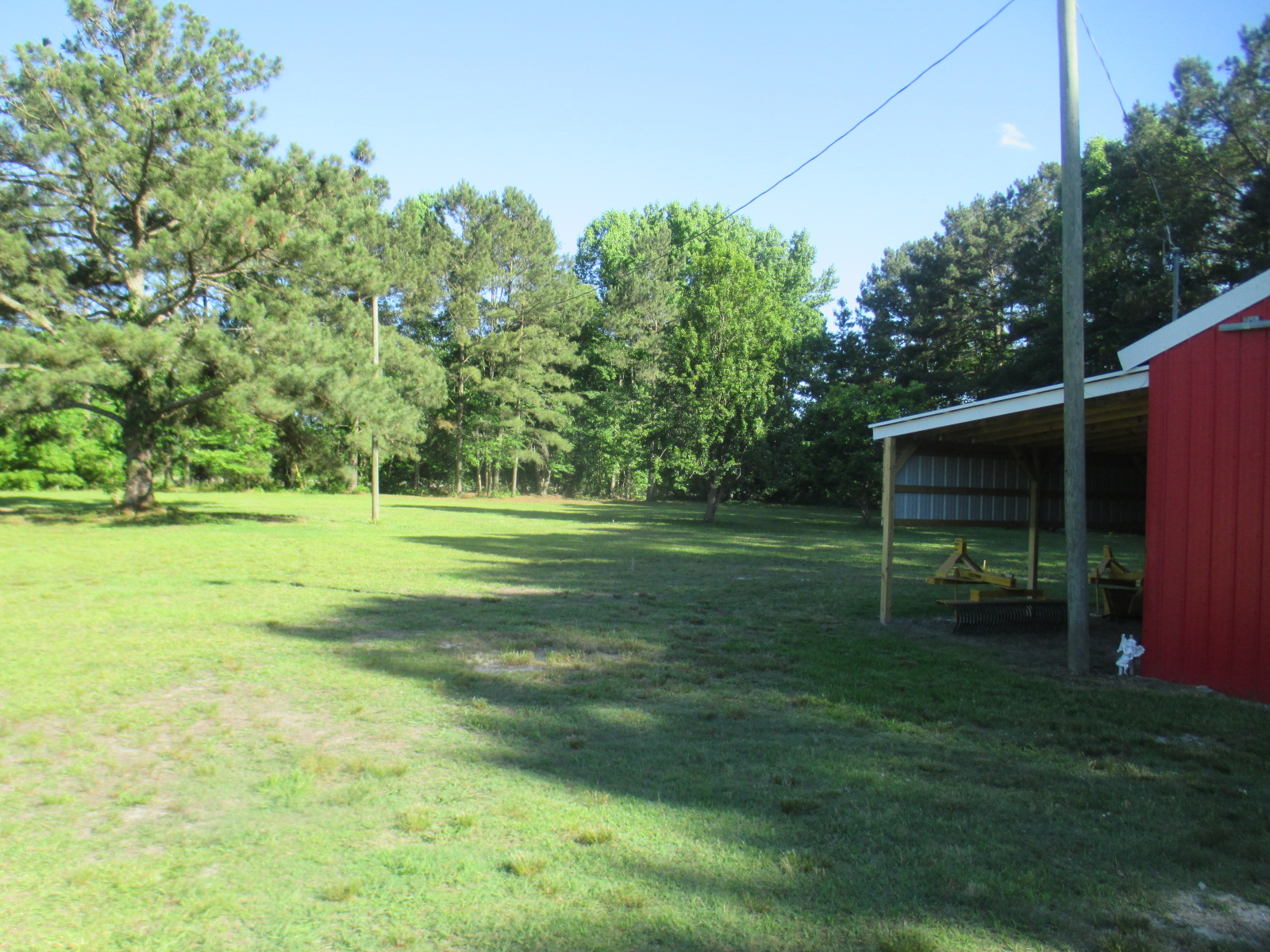

actually, I would build the same thing and take the trees down if they did not clear. Power lines can be moved, or if need be, I can take the pear tree down at the far end and then move the whole thing five feet further away from the power pole.
Currently lined up with existing barn, but I think the next building will have to be set back a little.

mac you crack me up. Growing up with 70 acres of woods directly behind our 1720 stone house, and fields in front, my father always told us we had to "beat the woods back" because for sure it would try to come out and take over the property. And it did. Same now with my place, invading species of cabbagey like weeds are working their way across my lawn, directly from the woods, like an invading army. Weed and feed did nothing to them, need to dig them out by hand I suppose. And those briars, the foot a day vines with the huge ripping teeth on them, they bloody me constantly, so you are sure right. But despite all that, I have another fifty sideline trees to plant and plant I will. Lot of weedwacking and watering though.
The trees in question are an old pear tree and that large pine. Both are healthy but the pine of course makes a mess all around it. The pine is going to get heavily pruned on that one side anyway since it has a branch over the power line that needs trimming. technically the City of Washington should send a truck out here to prune it; they have to maintain the line to the barn, since it has a transformer on it. I have two pole transformers on my farm, strange...and they burn and blow up from experience as a fireman. Now that I have a new gate that allows trucks through the property going the long way around behind the orchard and not through my lawn, I might just call them. I put the gate in for many reasons, including getting concrete trucks through the property back to the barn area without destroying the lawn. That only occurred two weeks ago and was the starting impetus for me to get moving on this new storage garage now that construction vehicles could actually get to it.

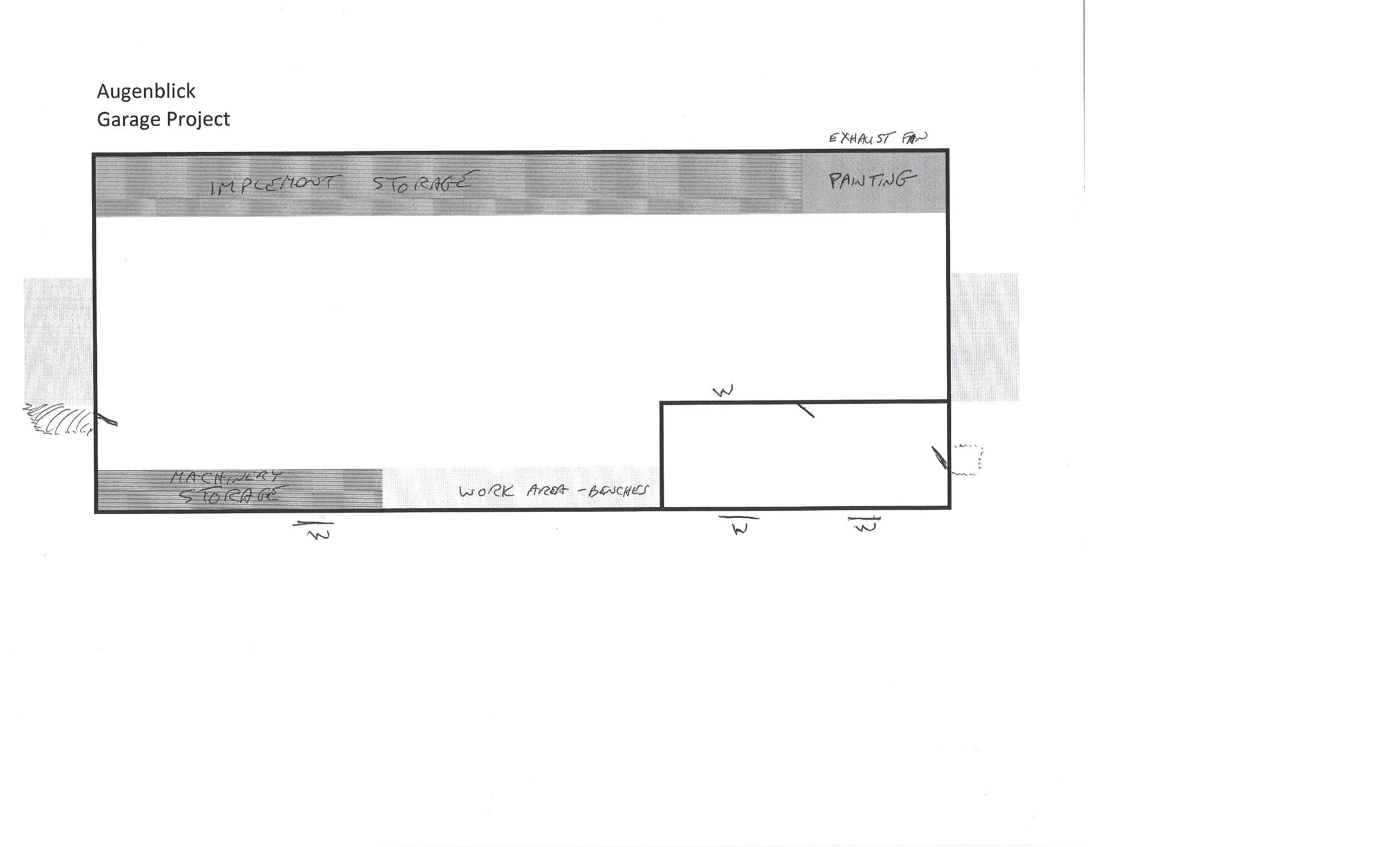

very crude drawing given to builder. He will make a nice 3d model for me; has good software to do this. No thought yet given to aesthetics, other than a cupola. And no, not drawn to scale.

Drew find out if grey water systems are allowed in your area. They still are in mine. You might be able to add just a floor drain and sink and get away with a grey water pit. It's just a pit lined with filter fabric then filled with sand and gravel.
One note on your sketches. I really don't believe that your allowing enough room for your implements. Looks like you need to stake it out and place everything in it you want. As previously suggested.

not all of them are coming in here. Some will stay under the shed roofs as currently, based on how well they weather outside. Like my water roller which can park on a sheet of plywood under a roof just fine. I drain it and soak it down with oil before putting it away anyway.
And...more importantly, I fully intend to mount my heavy implements, like the rear blade and rake, on rolling jigs. So I am hopeful I can go two deep in some places. If they move easily, fine.
All my motorized stuff has to go in here, and they will definitely go two deep on close side. Three garden tractors including a 1968 CC 125 almost fully renovated, a swisher rough cut mower, two Gravely wing mowers(in process of renovation)
pull behind tiller, and maybe six more motorized somethings. Yeah, a lot, but realistically my primary mower will stay in the barn because I'm not tracking all that grass into the garage constantly. Plus I keep fuel in the barn in the compressor room with a concrete floor. Open roof above, lots of air flow... I really want to keep fuel out of the new garage. Though there will be oil and grease there for sure. That's where I want to do maintenance.

What this will mean is equipment I now have sitting outside will either come into this building or under the sheds where that equipment will now move here, all like little checkers. And when I'm done, yeah, no room for a new little bulldozer...or something. But the property won't look right if I build a bigger building, would dominate my back yard. Will just make the best of what I have and be very grateful for a concrete floor finally.
I will ask about grey water. Good idea.
