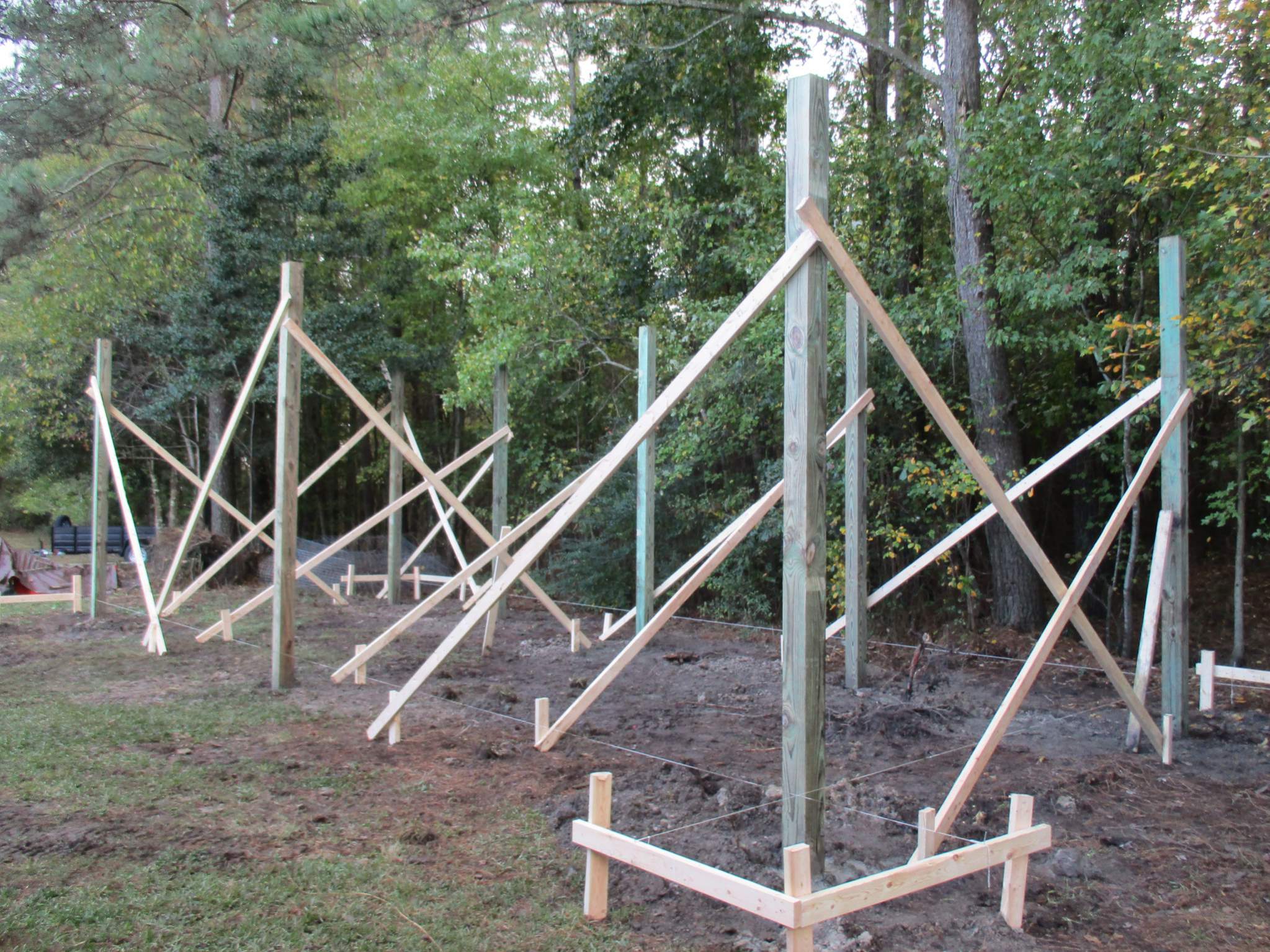

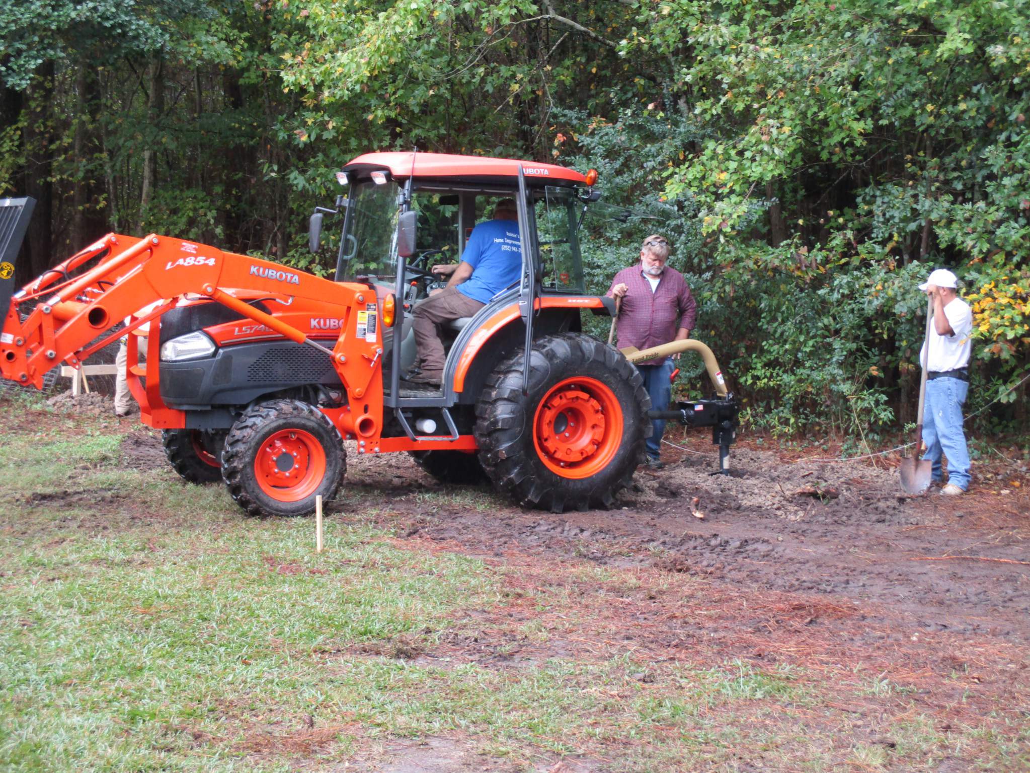

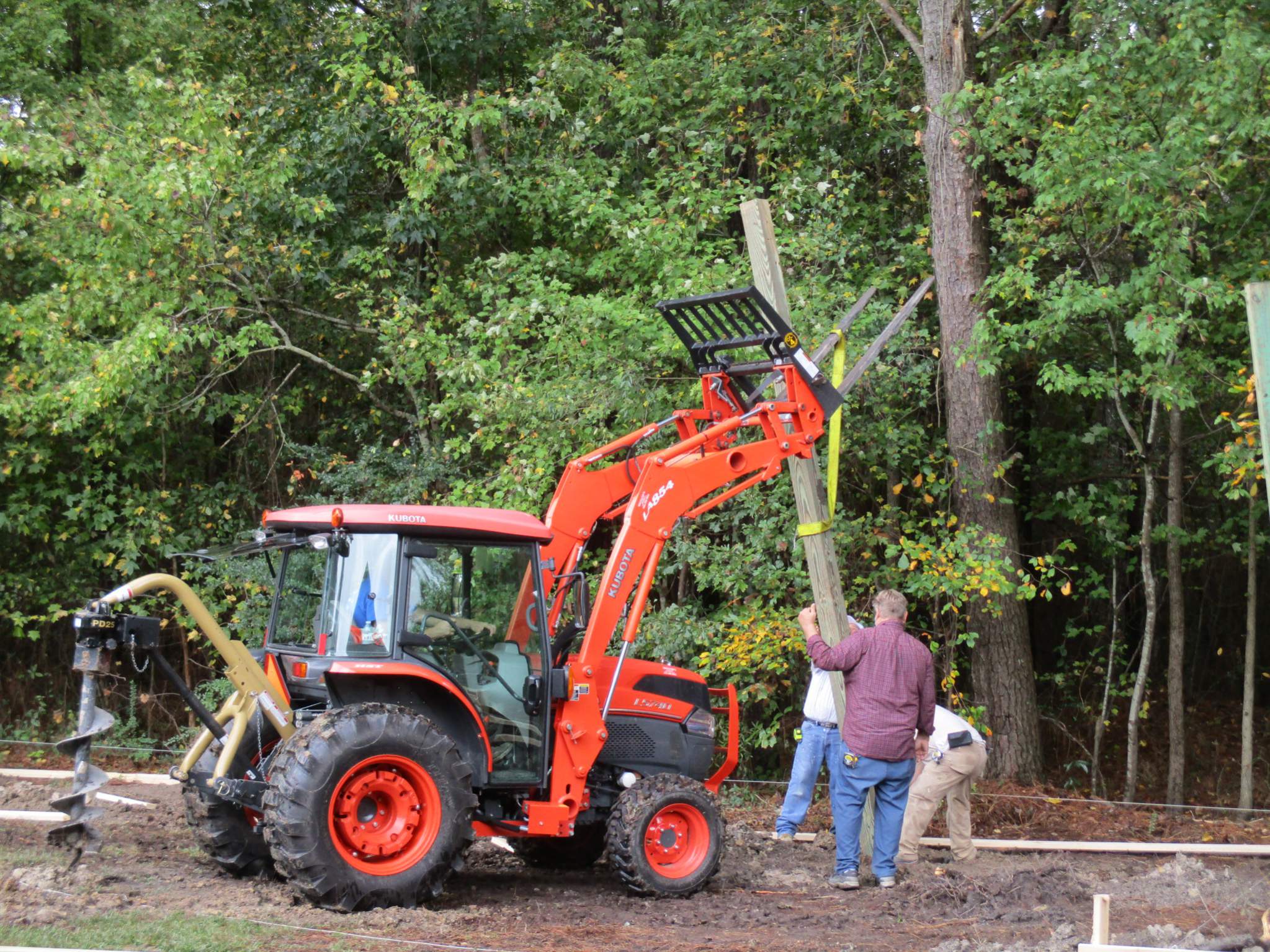

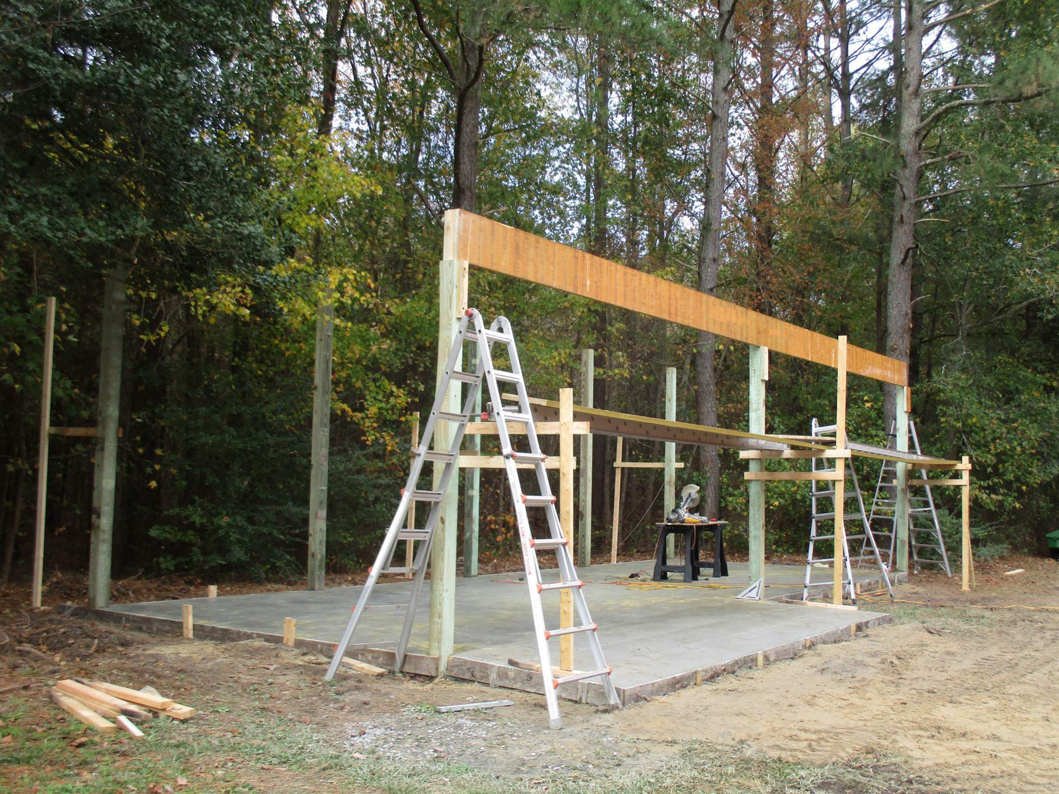

Good progress today on revamped storage shed, now a 15X40 open shed with a concrete floor, vs. a much bigger enclosed blg.
I dug the first several four foot deep holes, then let the contractor take it from there. He was tractor savvy which was good.
Was supposed to be four poles in the rear and three in the front; they goofed digging and dug five holes in the rear and had to go out and get another 6x6. 50 bucks a piece for those poles... With all those poles and trusses 18" on center, I don't think this thing is going anywhere. Metal roof and red trim to match the barn.
I didn't understand why the contractor wanted to set the poles, then let the concrete guy come and pour concrete afterwards, including whatever site prep needs to be done. Why not do the prep first? Apparently these guys have done it this way a long time, but I was worried about getting the roots out from underneath apparently more than they were. I took my FEL forks in there and dug up some big roots but why would someone want to run an excavator around poles?

straps, that is what I was missing setting my poles. need to get some of those....
nice tractor pic.

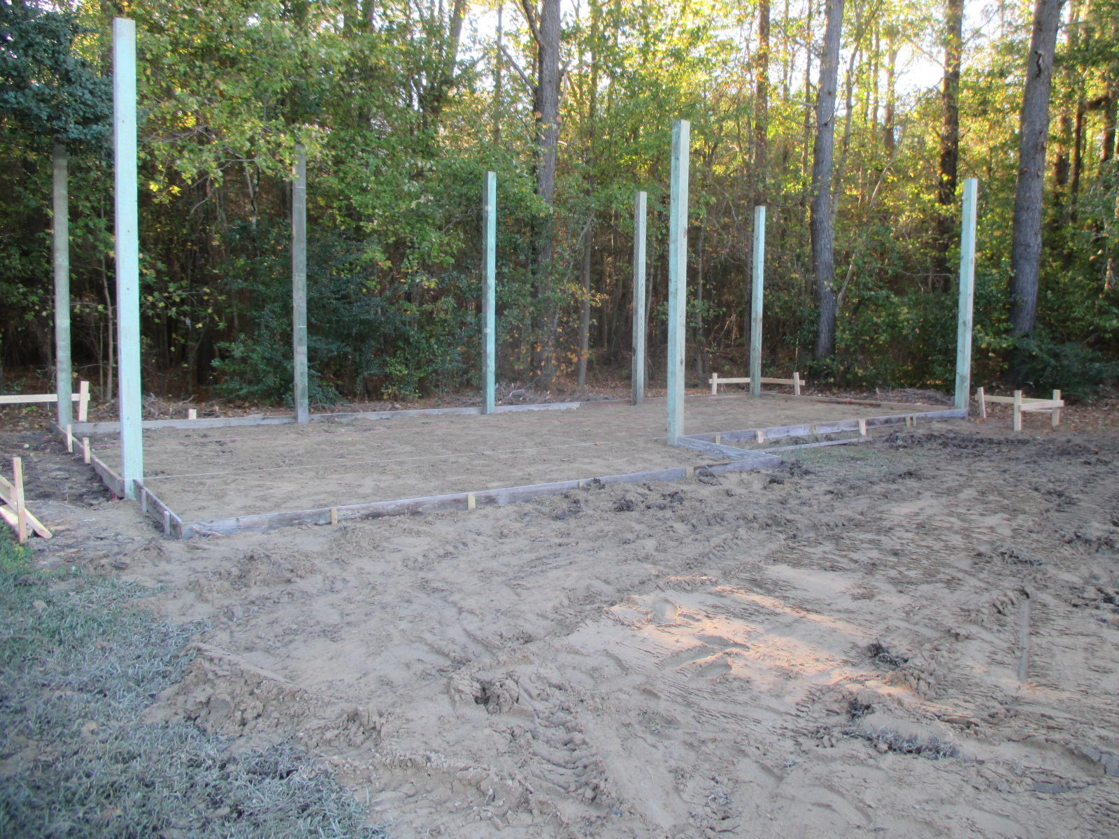

That dirt/sand above finally got spread today as the concrete guys were waiting for the area to dry out.
I asked them where their front end loader/bobcat was and they looked at each other and said well, uh, I guess we were going to rent one, but they close by noon, and...
ok, enough hints dropped. Well perhaps you'd like me to do it with my tractor. Oh sure....
So I spread the sand after they had set up their forms and the concrete truck is due in Monday. Father and son raked it all nicely and doublechecked with a level. And asked me to check it...nice and level. They only wanted six hundred bucks more for the apron, so I said yes to a 5x20 apron on the left side, with a slope of one inch. I saw them laying it out and it just didn't look right. What's your slope? 3 inches. Oh no. One inch please. Yes sir. I have to be able to push things up that little slope..
Going to have a lot of dirt grading when this is done, concrete sits up high quite a bit, level with the bottom of the barn door/floor. plus the land slopes and I have to adjust for all that. I have a huge pile of dirt from having water diversion ditches put in so when they are all done making a big mess, I'll clean it up.

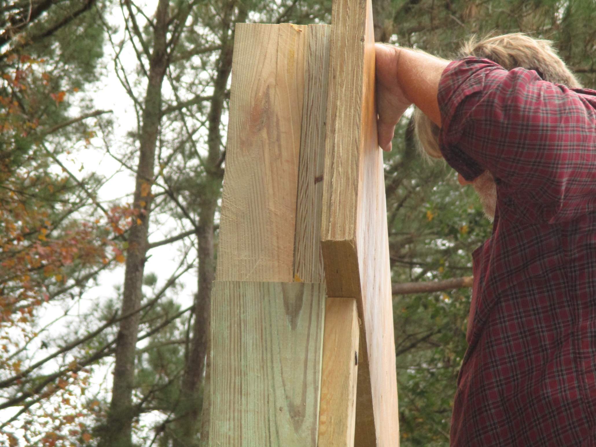

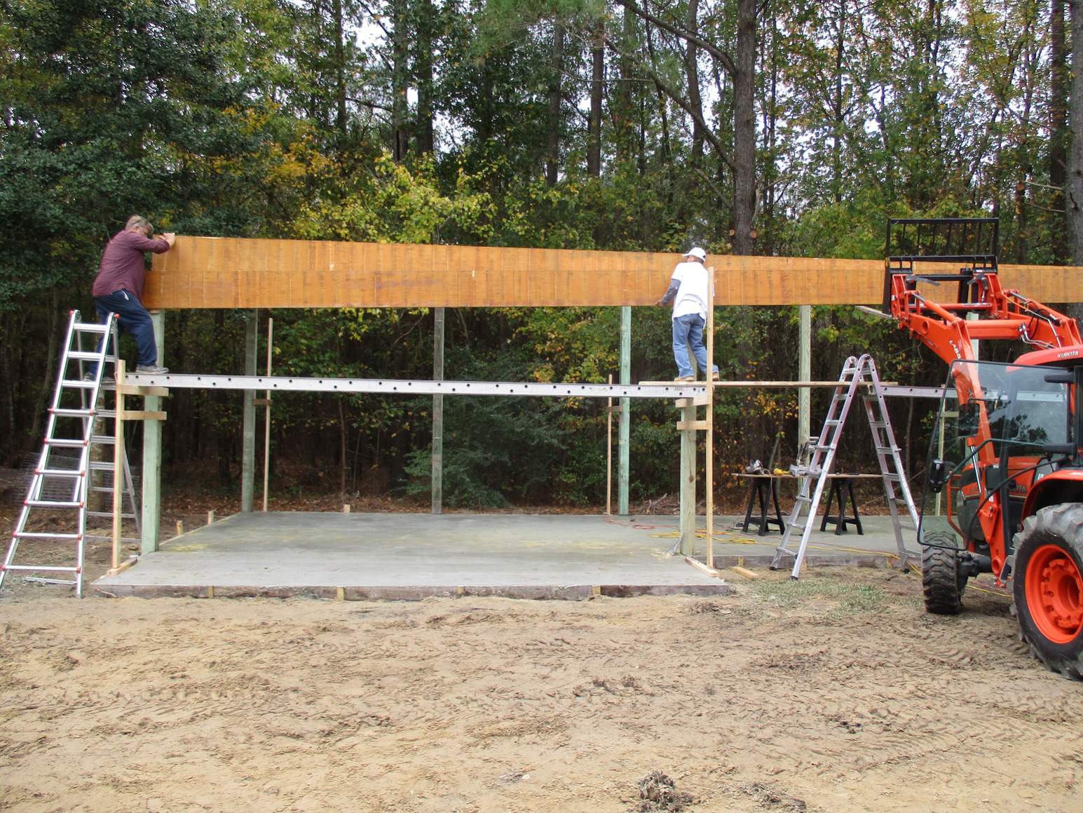

I didn't get a chance to see what they got accomplished this afternoon but this morning I saw them lifting those very heavy laminated beams. I thought one would be plenty strong, but they were doubling them up, two on each side. In my opinion, totally overbuilt for what I was intending. I did question the use of that short piece holding up the outside beam; told it was temporary, guess I'll just wait and see. Said they were throughbolting the beams and I suppose into the posts.
this was an OSHA nightmare at times, these guys have little respect for safe material handling. No backup lines, one slip and the whole thing would come down on them.
This is the carpentry sub working for the GC, 40 years doing this so I assume he's made it this far...

I think I'd be more concerned about them walking on the uncured concrete. And if one of those glue lams gets loose and falls, there will be cracks for sure.

agreed. I had hoped they would wait one more day. And since for some reason the lumber yard is closed tomorrow, they are delivering plywood as we speak in the pouring rain. That can't be good for it...

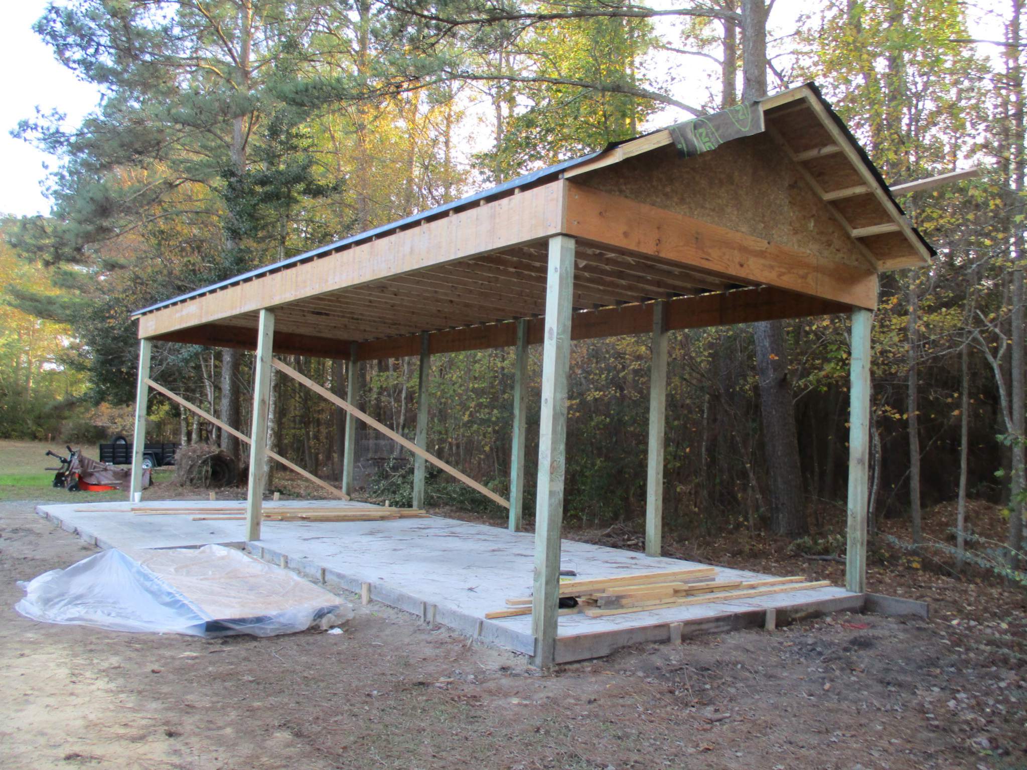

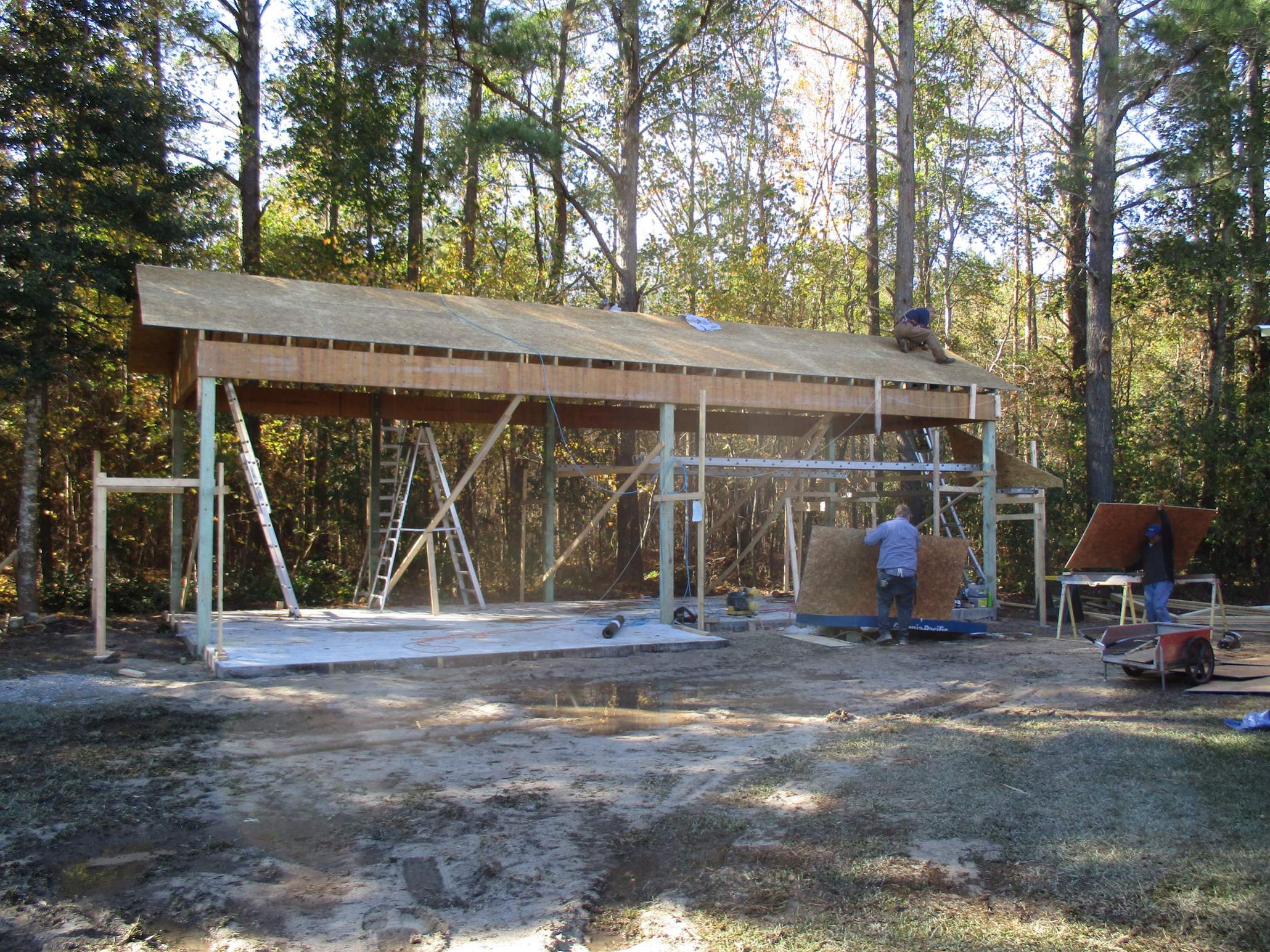

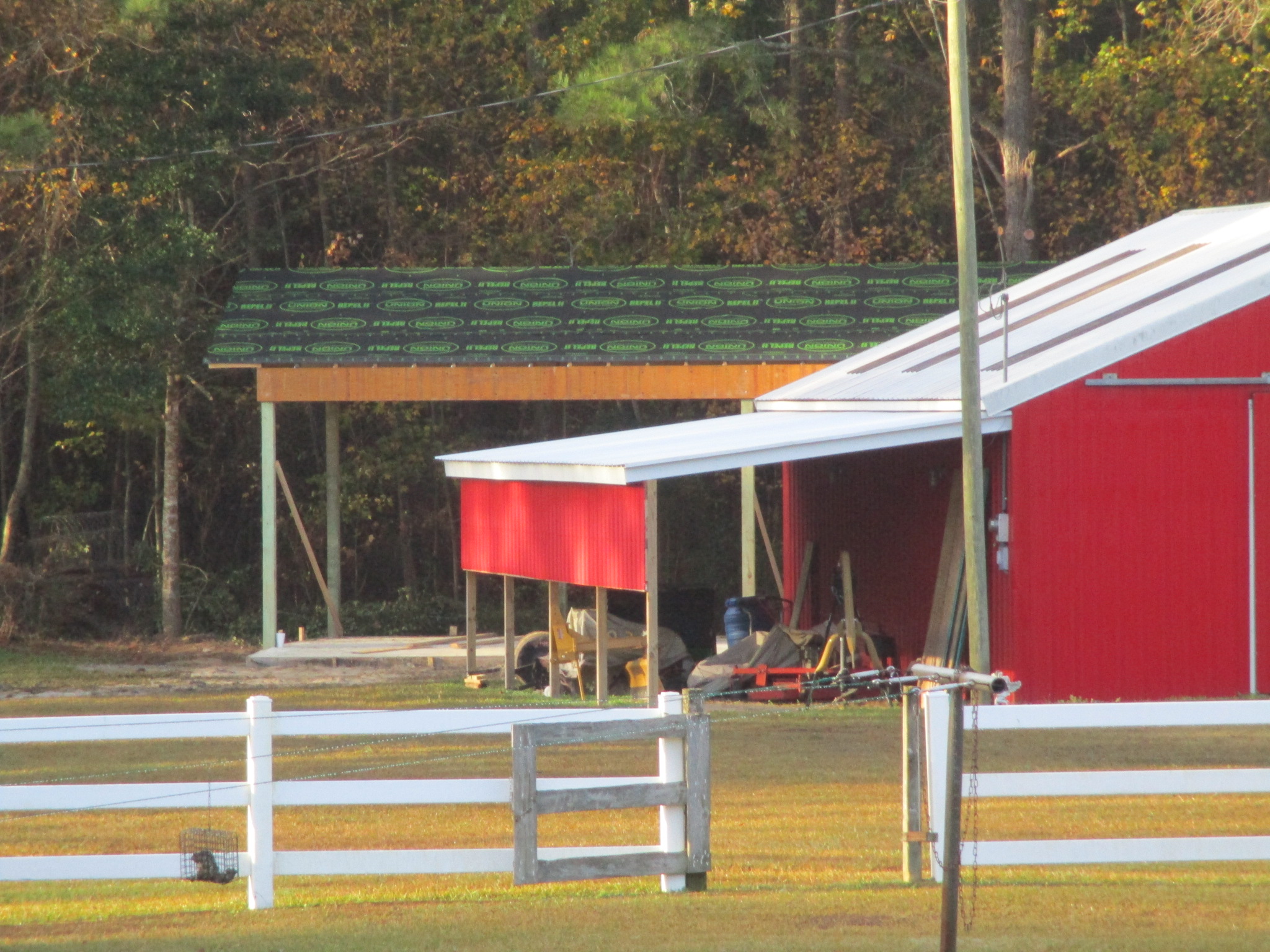

making progress, getting roofing underlayment on, I did ask they extend the roof out two feet on each end to help with keeping stuff blowing in the sides. Rear is likely to be closed in but sides and front left open. They will reinforce the part sticking out past the building, and gutters are going on front and rear.

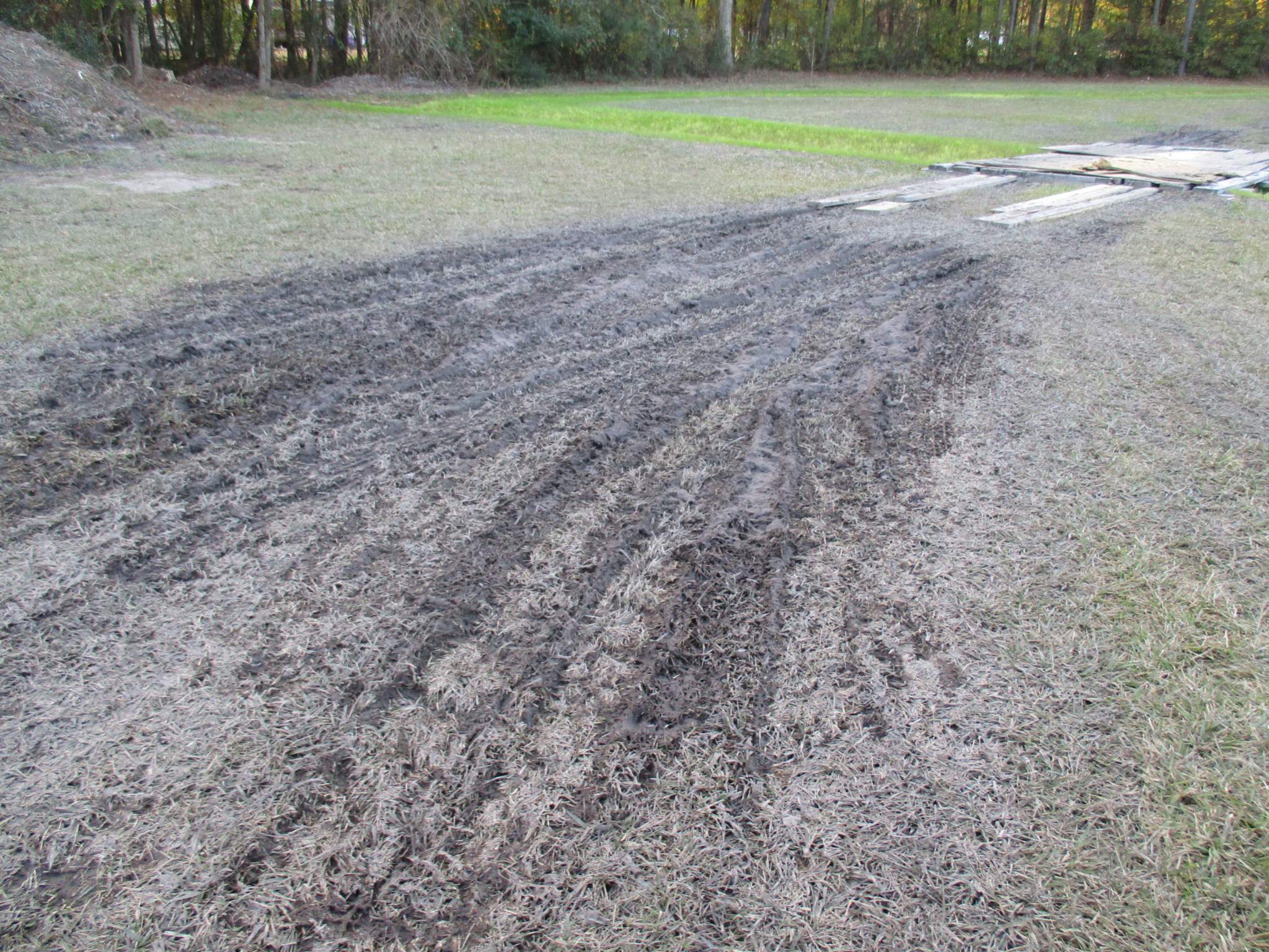

progress

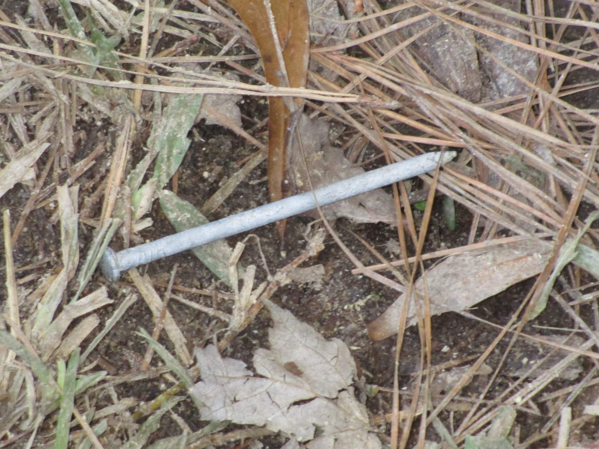

more ruts to fix and a reminder to the GC that he has to pick up nails at the end of the day...
Good luck with that, Drew. The concrete contractor that poured the driveway here got several reminders, all of which were ignored. I ended up dragging a magnet through the dirt over the course of several days, recovering over a gallon of screws and nails that I'm still waiting to recycle.
