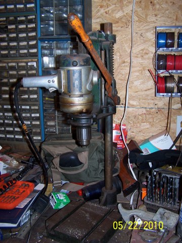

I have a direct drive drill press (basically its a Stanley 1/2" drill mounted in a press frame). Most of the newer ones I've seen today are belt driven by 1/3 to 1/2 HP motors. The belt driven ones usually have a stepped pulley system. By moving the belt to a different groove in the pulley you change the speed of the drill. I've attached pics of mine and a typical bench top variable speed belt driven press. They also are available in floor mount.
If your looking at used, keep your price down. They bench top model I showed sells new at Lowes for under $300.
For your own home shop use you'd probably want a 110V unit.

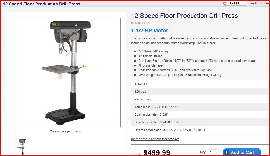

The 39955 HF DP can be bought for a bit over $300 if you wait for a sale
and use a coupon. The specs still list it at 150RPM, but that is not true....
180 is the min speed. Also, the torque is so great at that speed that you
can slip the belts, not bog the motor. I feature it with my annular cutters
here:
