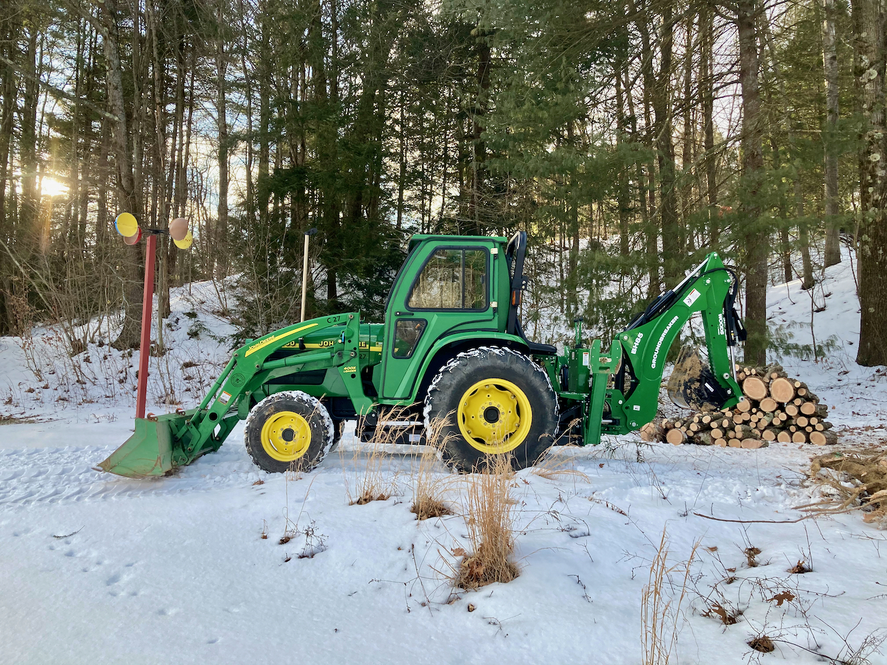

I was looking for a similar tractor last year (although with a loader). All of my other stuff is Kubota, but I ended up settling for a 2000 JD 4700 with ~608 hrs. I had to drive about 8 hours one way to get it. It's been great so far, about 160 hours later. I've added a new Woods BH85 subframe backhoe since then.
