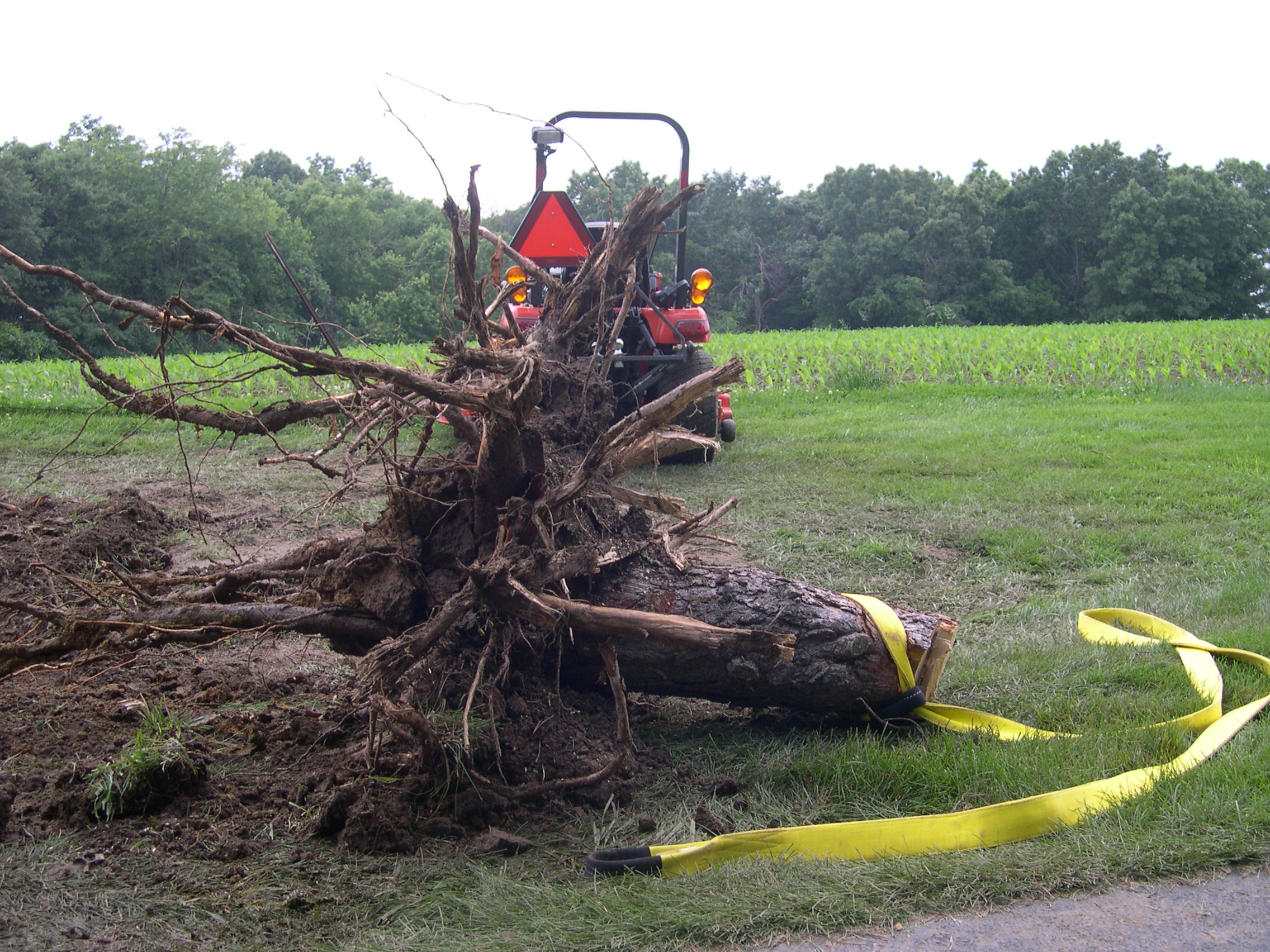

Several of us have proven (with pictures) Doktor Orange wrong on that point.
Sure you can do it, but it takes hours and beats up your machine. My backhoe alone weights 700 lbs more than your entire tractor and I dont dig them unless I absolutely have to. Advising someone not to buy a backhoe to dig up stumps is sound. Of course it can be used here and there for it...but that is not a reason to buy it in my opinion.

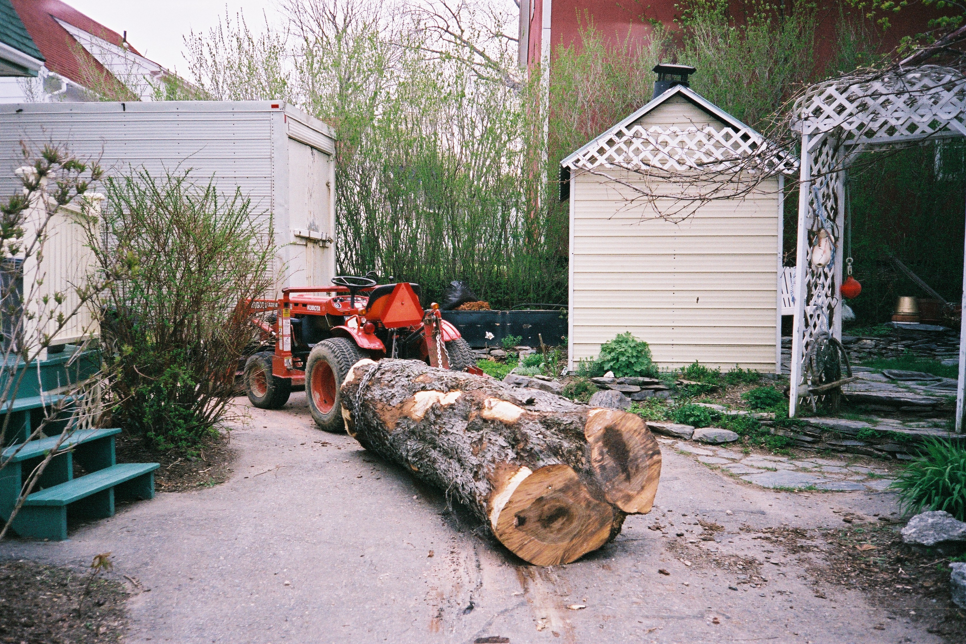

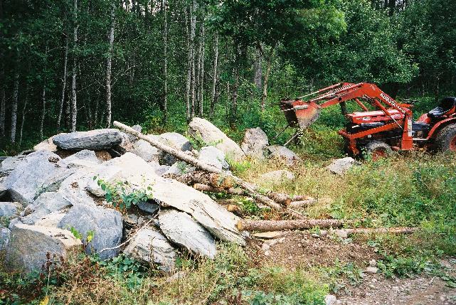

For what the OP wants to do a tractor similar to my JD4200 with backhoe would work well. Some feel the small backhoes are useless but used in perspective they can be a great addition. Industrial backhoes come in different sizes with the small ones being toys compared to the large ones. It should also be noted that digging beyond five feet requires shoring or a cage which moves the job into a different category. Of coarse there are those who claim they can tell when deeper trenches may collapse. They have a tendency to make news.
Previously my B 7100 preformed most of the tasks the OP has listed other than having a backhoe. Chains add an unbelievable amount of traction. Load the bucket and put a little down force on the three point and pulling ability is greatly increase.
On ice and wet snow conditions you may find weight does not help traction.
Digging Rocks & Pulling Maple Log. It came up a twenty degree driveway slope. I do believe it weighed more
than the tractor.
