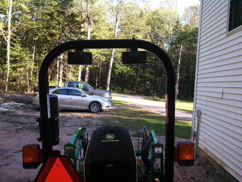

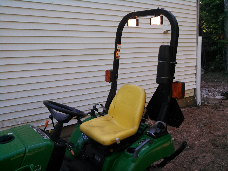

Thank you all for your help and advice on this project!!! I got the lights hooked up and used them one evening last week. All went well until both lights vibrated loose Thurs. and fell off. I put some rubber bushings in that should help with that problem. Below are some pics! Would love to hear your thoughts and input on the final product! :)
John Deere 2305 w/ 200CX fel & quick hitch power broom.
/ Additional lights on 2305 ROPS #28
Looks good. Are they in your eyes at all when you look back to back up?

Not really, monroe. Especially since I blew another fuse when I was tightening the nuts over the bushings tonight. Lol

From what you said about the nuts vibrating loose I take they are standard type metric or SAE. Have you thought of replacing the regular nuts with ones with the locking plastic inserts. I have had good results with using the plastic lockers in high vibration areas.

I hadn't thought of that, Gator. I'll see if I can find some! I'm also having wiring problems since the wires and bolts go through the same pre-drilled hole in the rops. Any ideas?

gator is describing nylock nuts which is a good choice, available at any hardware store. I can't visuallize what is going on with the wires but any of these should protrude through the rops without a chance for pinching. If you need a new hole for the wire to pass through the rops might make it big enough to fit a rubber grommet.

Ahh...see, the bolt goes from the lights, through the bottom hole with the wires beside it, then out the top hole, while the wires stay inside the rops. I didn't dare drill a second hole for wires because I thought it would weaken the rops. Is a small hole for wires ok to drill? That would be ideal!!

That's exactly what I did for mine. That extra hole won't hurt anything, but either put some flexible conduit around the wire where it goes into the ROPS, or put a rubber grommet in the hole to avoud chafing the wire.

I drilled mine as well, two small 1/4" holes will be OK. If you looked at the older post I linked above you'll see that I drilled mine a few times.
