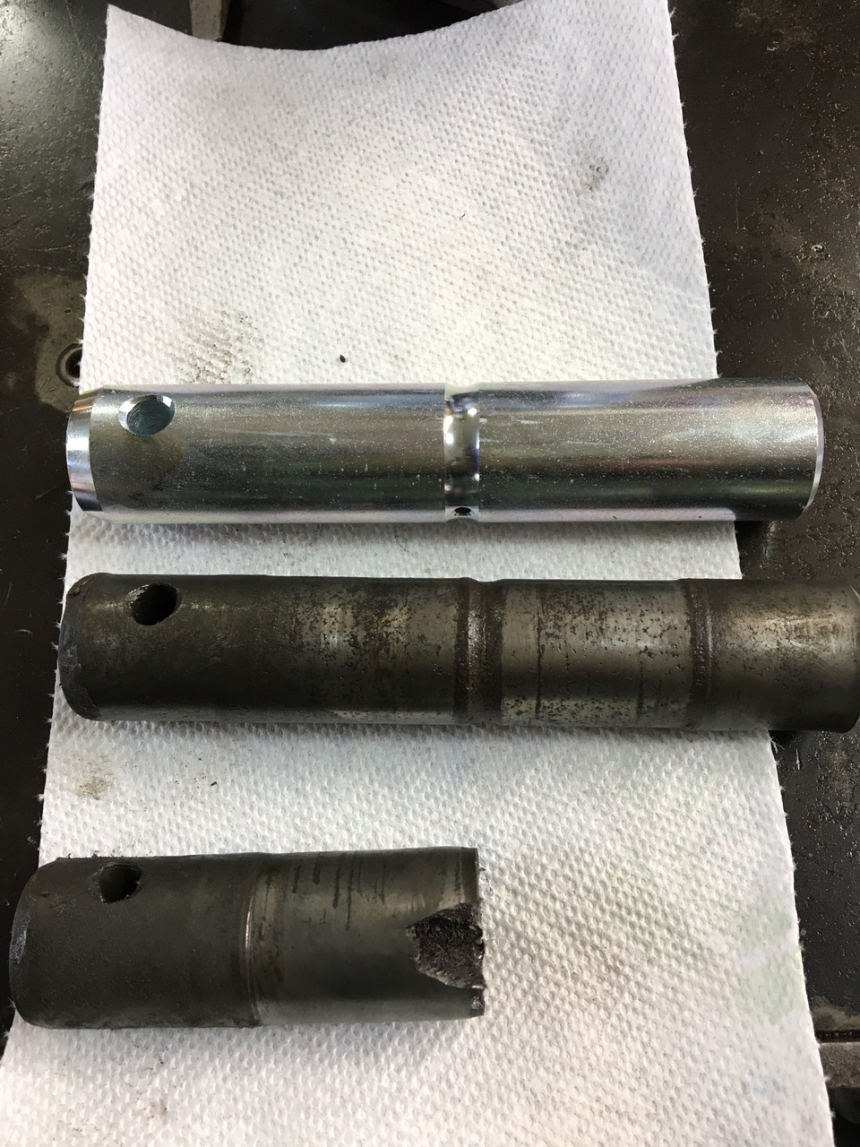

That’s the “notch effect”. The radius is intended to reduce breaks but they still have created the weak spot.
Yes, the notch tells it where to break, but not why. Given a choice, having it break torsionally and perpendicular through the center of the pin is correct for both where and how the designer would want it to break....if it had to break. So he gets points for the notch. And extra points because the bottom of the notch is radiused instead of slotted with sharp edges. Having a radius dramatically reduces the main cause of crack propagation.
And since they seem to last 1000 hours, that says the pin is basically strong enough in shear and bending. But it should have lasted far longer than 1000 hrs. My guess is some sort of lube failure that affects one end of the pin more than the other. And maybe associated some way we don't yet understand with its having that bolted pin connection at one end.
After we see a few more pins that are worn but not broken we may get closer to the answer. In the meanwhile I'll be pulling those pins on mine for some maintenance. Might be a good thing to do at 500 hrs, too.
Which reminds me that we ought to look at a few new unused pins too. Just to see that they were made properly to start. They may have been designed properly throughout, and the problem could be nothing more than a production machine shop mistake.
