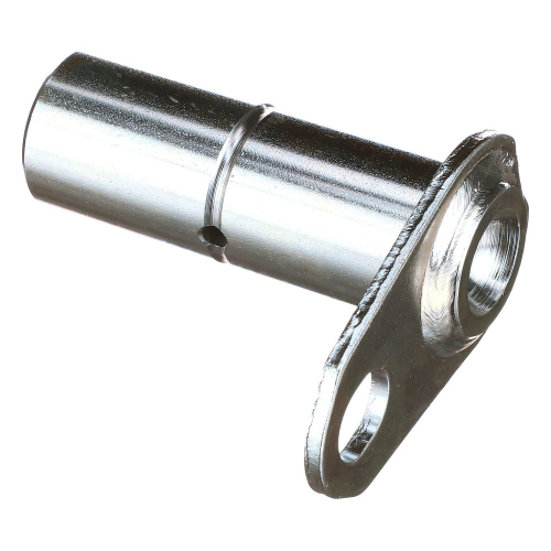

Sort of baffled here, have a lower pivot pin on FEL that wont take grease, have had pivot pin out, and zerk is good, channel through pin is good (clear), exit port in chanel/pin is good (clear) but won't take grease.... Seems that the eye on loader frame is hard pressed against the pin and effectively forms a "seal" on grease port of pin.... Sort of thinking of taking Dremel tool and putting small groove around pin so grease has channel to go around pin like in image below...
Anybody have different idea/solution....

Try the penetrate, if it won't take grease, cut the groove.
/ Bucket Pivot Won't Take Grease #6
Can you drill the cross hole all the way through If pin isn’t too hard? This allows for load on one side creating grease clearance on the other. Groove does similar thing.

I have one zerk that WILL NOT take grease while the FEL/grapple is in the resting position. It's a PITA. I start the tractor - raise the FEL slightly - rotate the grapple slightly - Whala - the zerk works fine now.
BINGO.... Changed angle of bucket to loader arm and it takes grease......

You aren't hurting anything by cutting a lengthwise groove the same dimensions as the circular groove already there. I'd do it in a heart beat and then work the bucket to maxes and install more grease till you have had at least 2-3 of good pumps in there. Expect it to squirt out the ends which is usually my stopping point but for you I'd disregard it, getting a good layer of grease around the interface.
