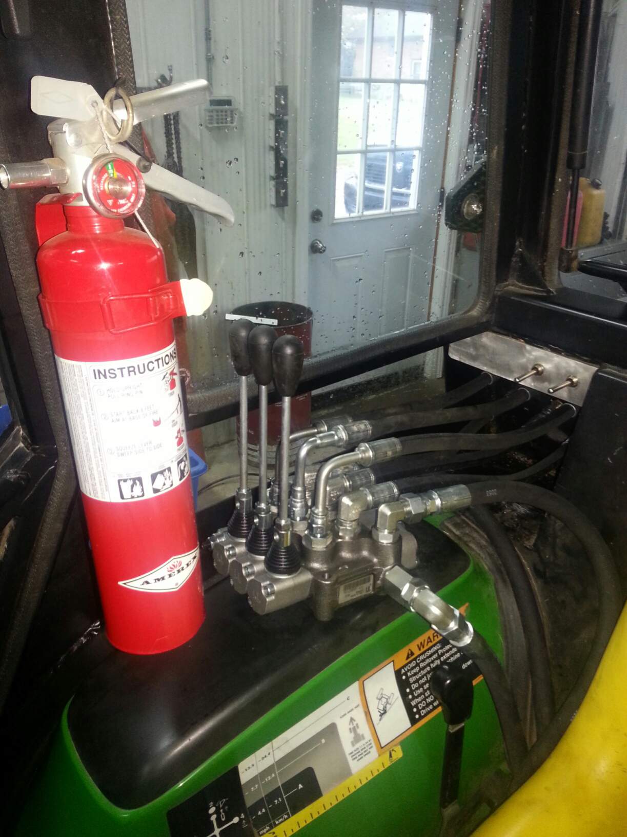

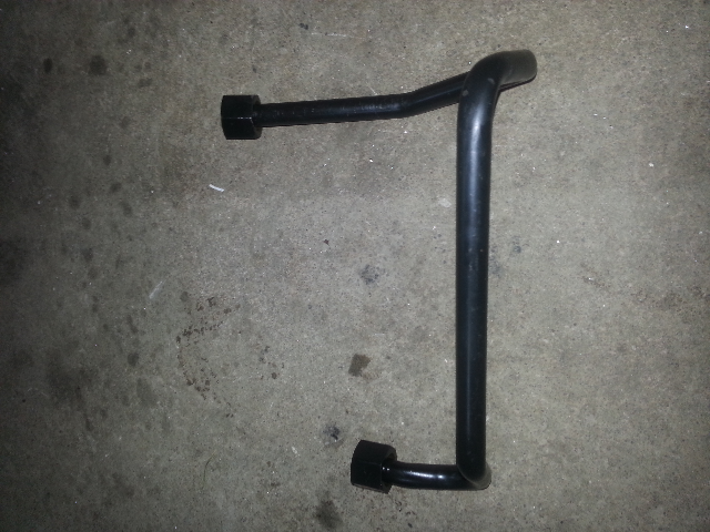

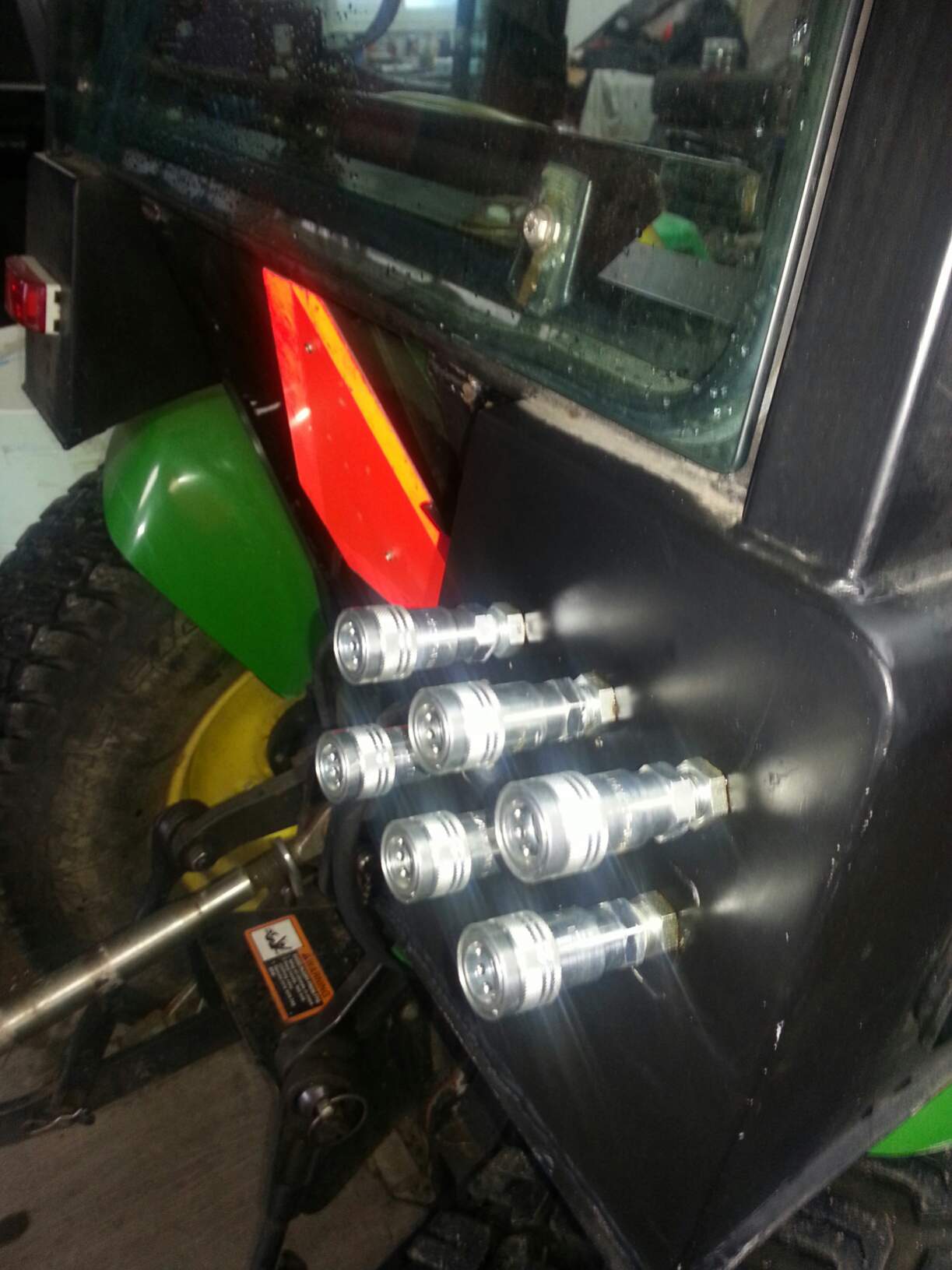

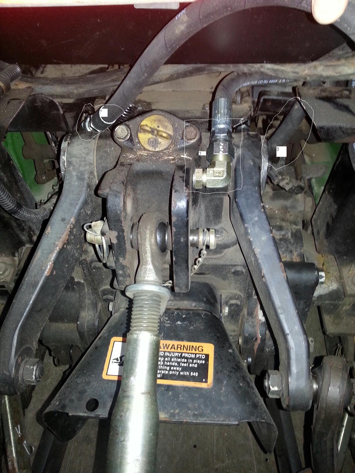

hobbie918 I have a 4300 and wanted lines to the front for a grabble and to run hydraulic sliding tines on my forks. The parts from deere to be able to use the third spool on the factory loader valve are pricing for what you get. I intstalled 3 new spool valves (6 rear outlets) for slightly higher price. There is a steel line at the rear of your tractor that comes out from the factory loader valve on the right across the top of the PTO housing and back in the left side (some have a filter and some are just the steel tube) to the factory 3 point hitch valve. This line is the power beyond (full hydrulic flow) from the loader valve to the factory 3 point valve. By removing the steel line you can come out of the factory loader valve with a hydraulic hose to after market spool valves (1, 2, 3, ect.) then out with the power beyond on the new valves back into your factory 3 point hitch valve with hydraulic hose. The only extra line you need to add is a line to tank from the new valve stack. I will add some pics. so you can try to make sense out of it. On the first pic you can see my line going to the tank with the 90 degree fitting to the right of the fill plug. Oh I have a cab so you would mount the valve to the ROPS or make a bracket ect.
You did a really nice job on that.
