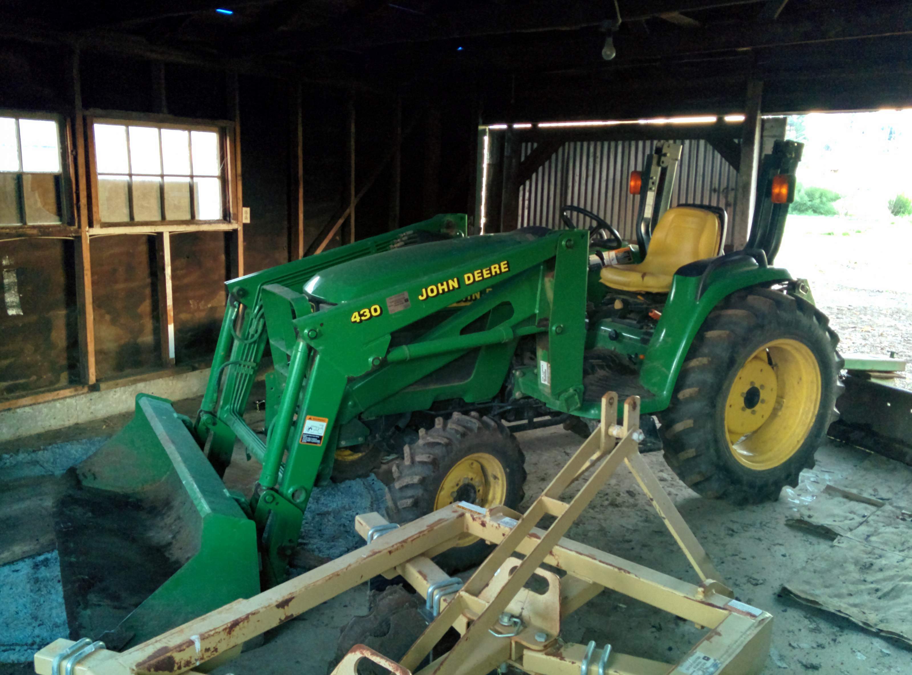

Hi everyone, I know this question gets asked a lot on here, but I am still confused after reading through a lot of similar posts.
I have a John Deere 4400 with a 430 FEL and have a root grapple that I need to add a line for the open/close function. From what I have read, I don't believe my tractor has a power beyond and I would like a true third function for the grapple. I went to my local Deere store and they quoted me out at 10k to get the 3rd function, so that is out of the question.

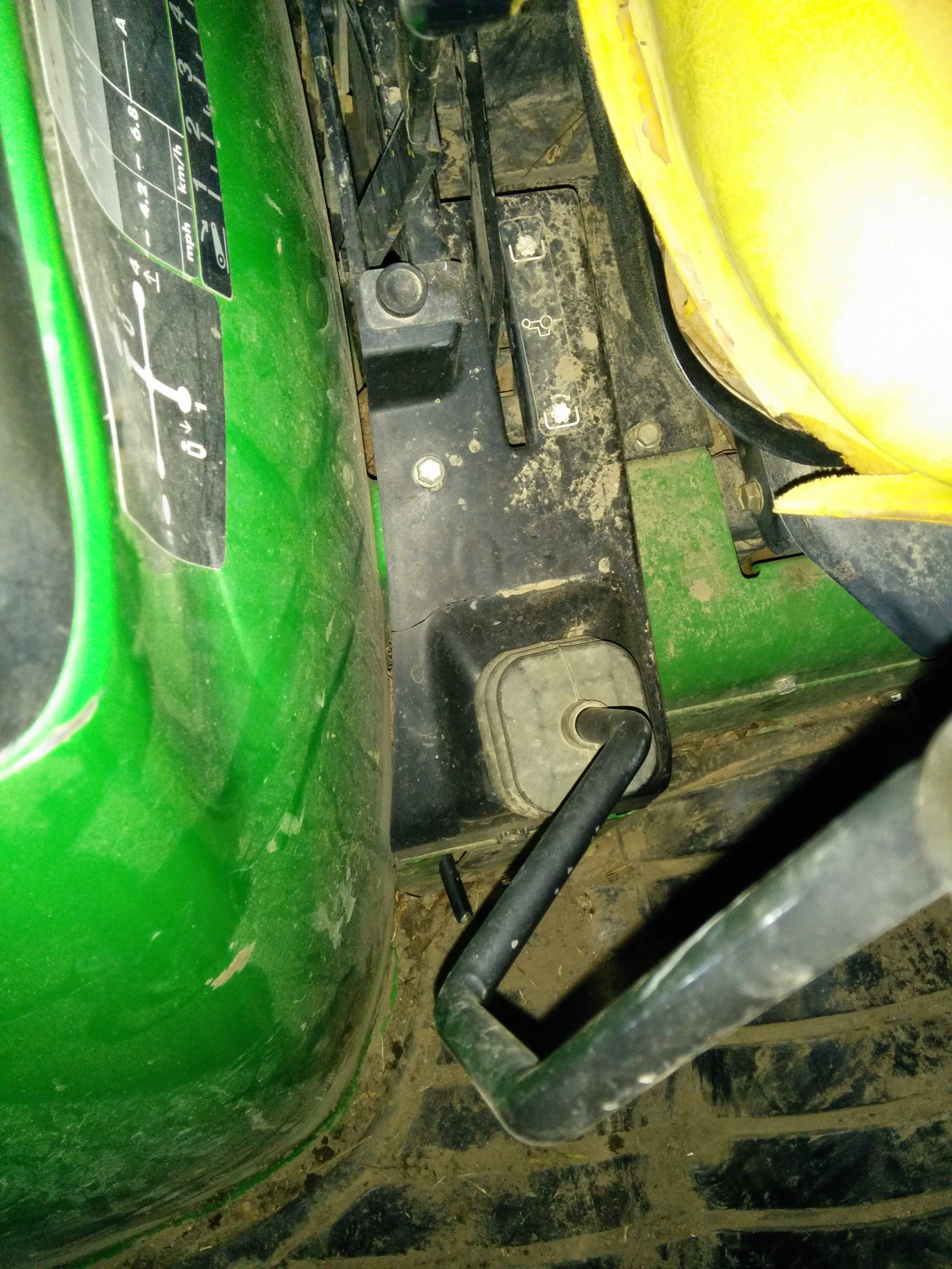

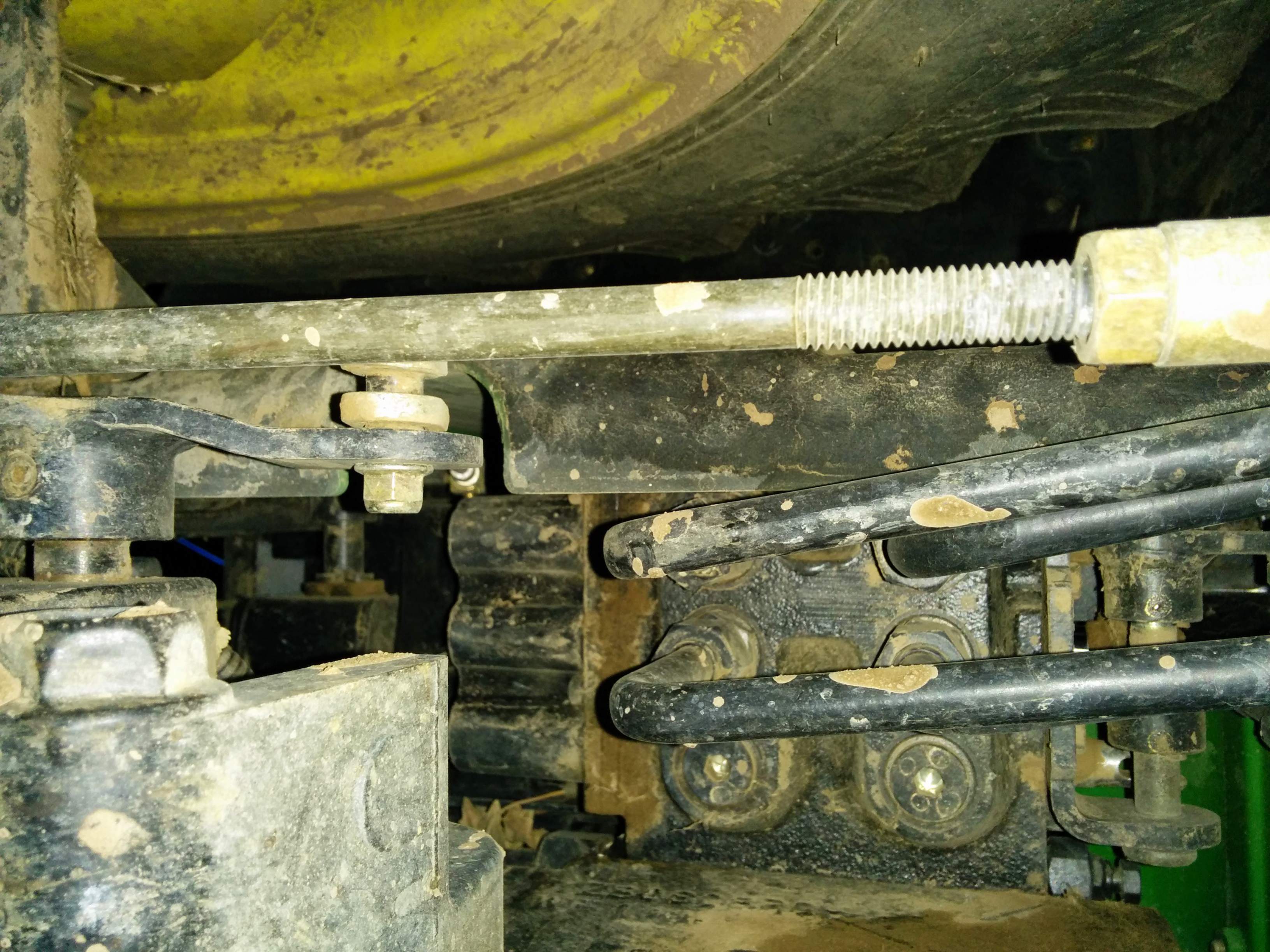

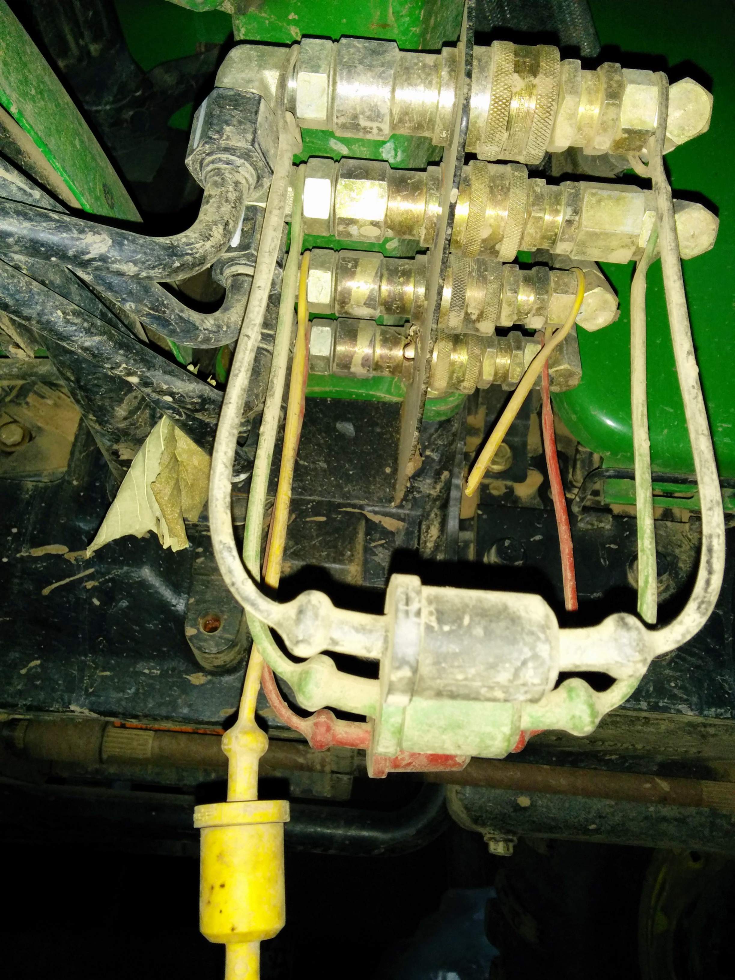

When taking a look under my FEL joystick it looks like there are two more ports that are just capped off and maybe those could be used? (Pictures attached)
Anyway, I'd appreciate any help on getting these lines hooked up and let me know if there's any info you need that I left out!

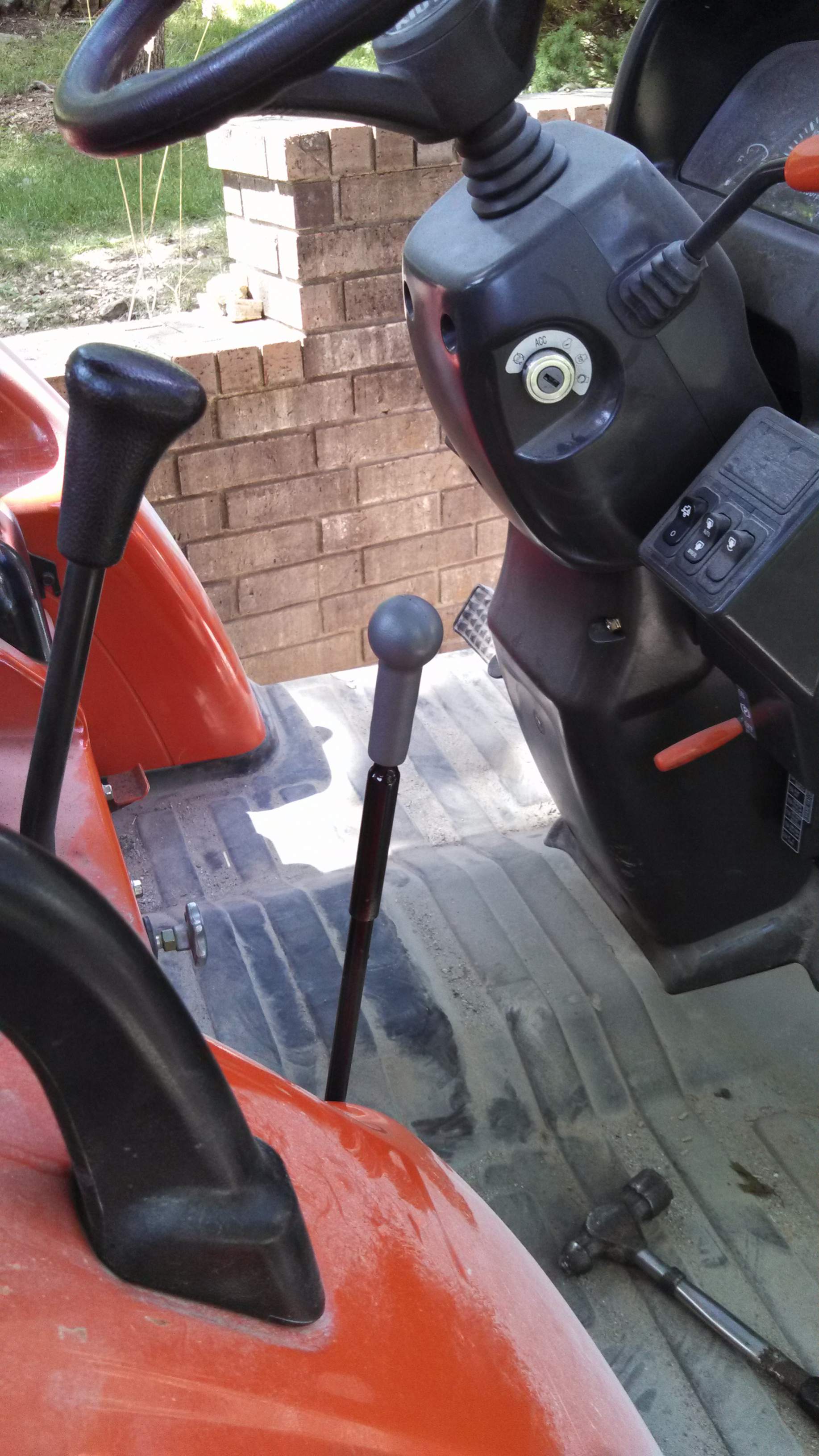

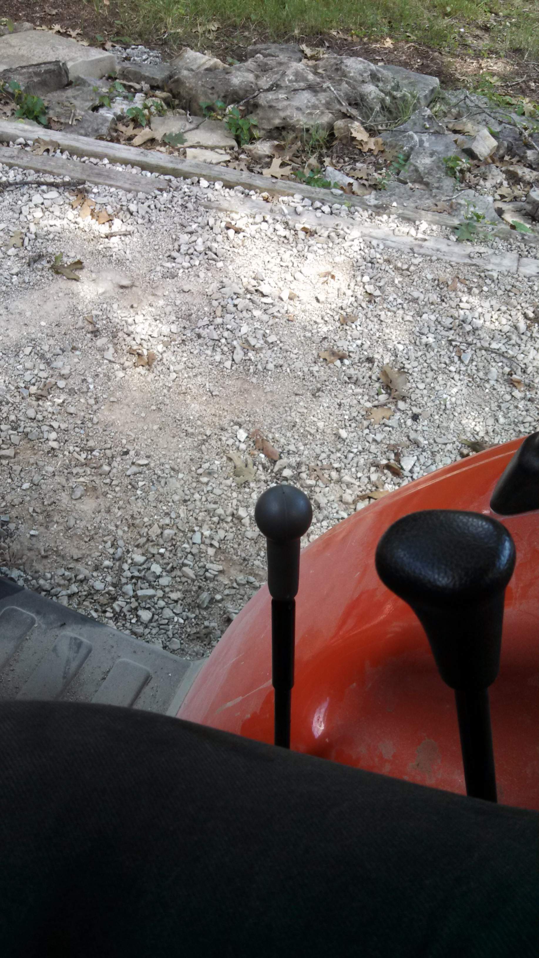

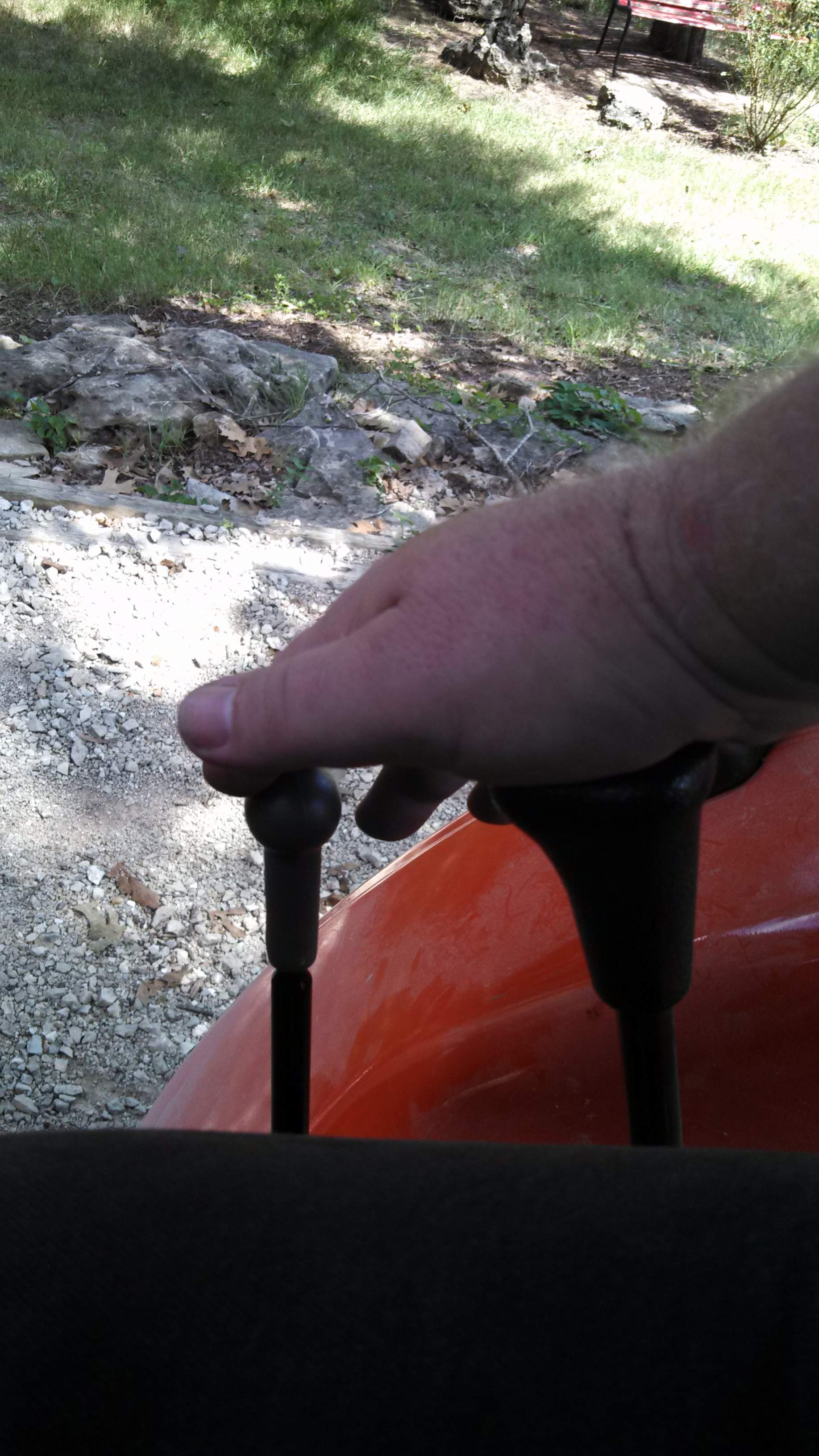

Everyone will have an opinion on this, but yes, I have one too. And I think the "true third function" is overated. But then again, I don't have/use one. I have a convenient rear remote valve that I use with my fingers while my palm is on the joystick, I again opinion only, but I believe I can operate and set up and grab rocks and brush just as fast as a "true third function" button setup. I also believe a diverter that uses your joystick to control both the lid and curl function would also be just as fast. Others will disagree, but just how many angels CAN dance on the head of a pin?:D

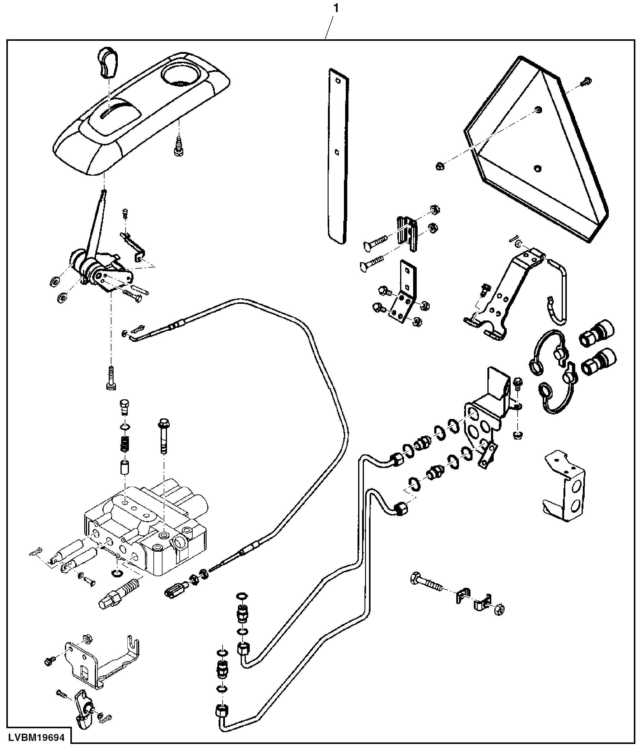

Second, Your 4400 already has 3rd SCV, (#1 and #2 is for the loader connected to the joystick), just no way to control it. JD has (actually had since these are 10+ years old) a kit to control it, it added the handle, hardlines, hardware, couplers, ect to use the valve.
All you would have to do is run long 1/4" hoses from the rear to the front. These kits will eventually go away since they are 10+ years old, so even if you want to add a diverter I would suggest getting this anyway.
The part number is LVBM19695: John Deere 3RD SCV KIT LVBM19694

Per your above picture, looks like you have a third spool available on this valve. therefore, you could easily connect your lines from the grapple. But what you need is a lever on that third spool (you may need to modify it for ergonomic conveniences; ie: ease of operation. If feasable, then you will have your grapple operating in no time. This is very close from being a true third fonction in my opinion.

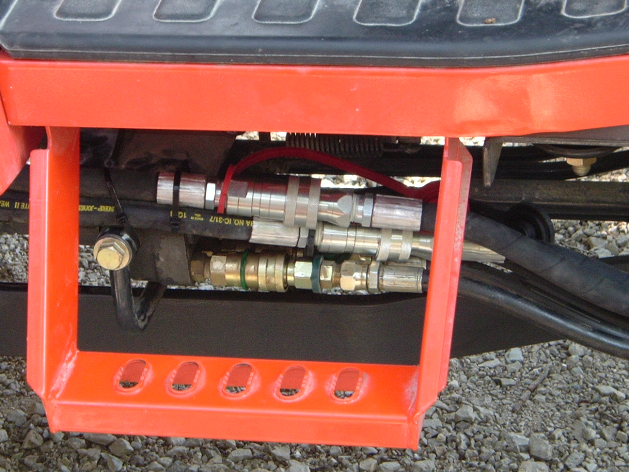

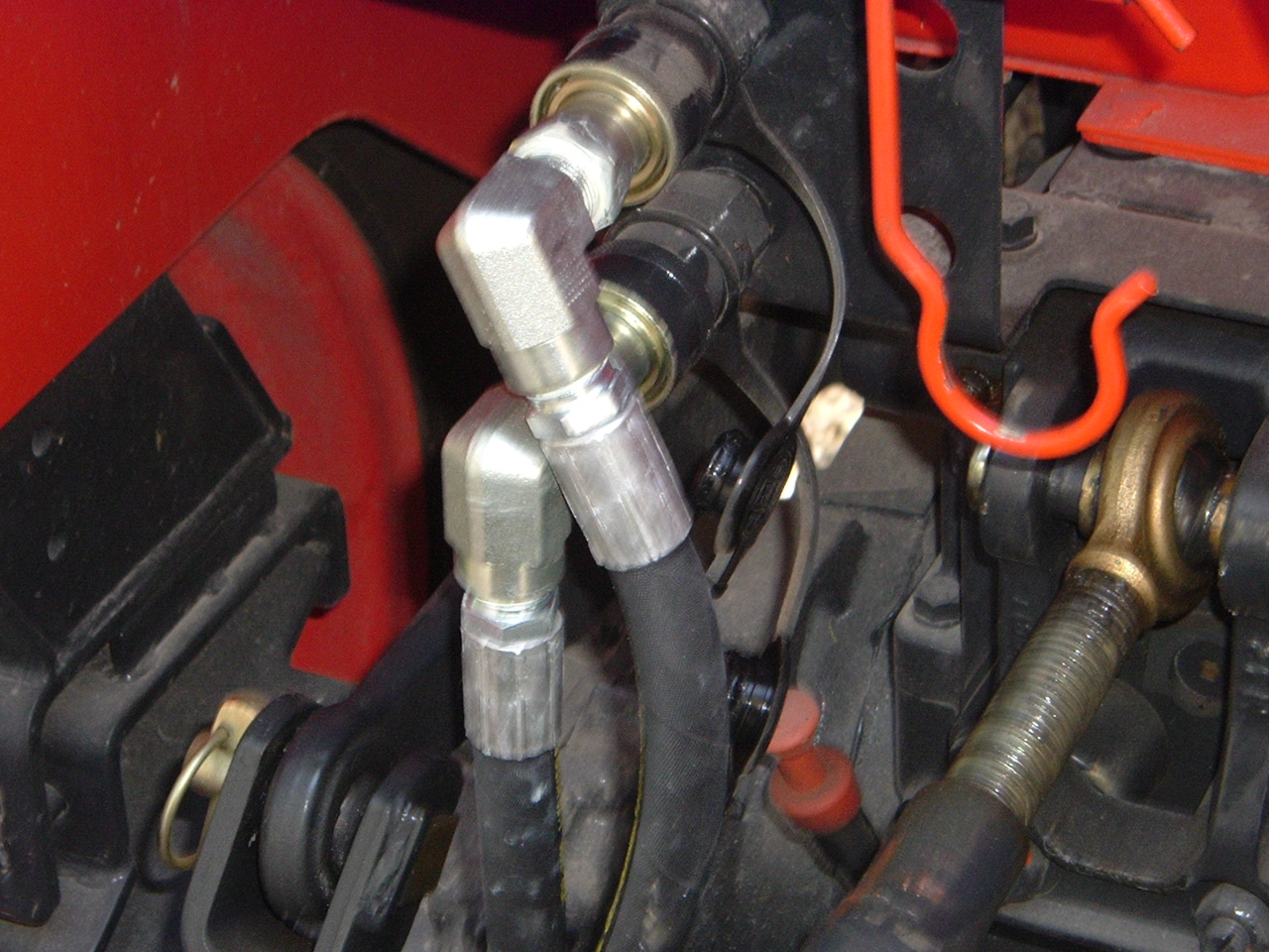

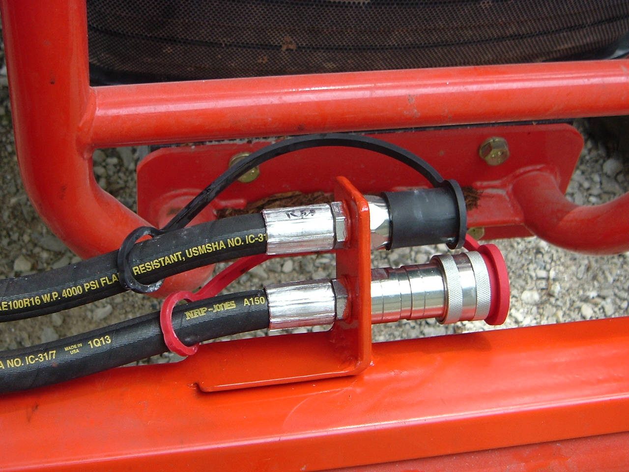

The Rear Remote valve and outlet ports were existing on the tractor as standard equipment on every Kioti of the DK lineup.
Just like an LS will have 2 of those rear remote valves as a factory default.
What you see here is the quick connects on the "torque tube" on the front of the loader to hook the grapple hoses to, then the right center step mid-tractor where the other loader hoses disconnect so that these hoses can be broken in two and the front half stay with the loader when you take the loader off just like the original 4 loader hoses. Then the rear remote connections on the back of the tractor (usual place for remote's) with quick connects and right angle adaptors so the hoses are pointing down.
