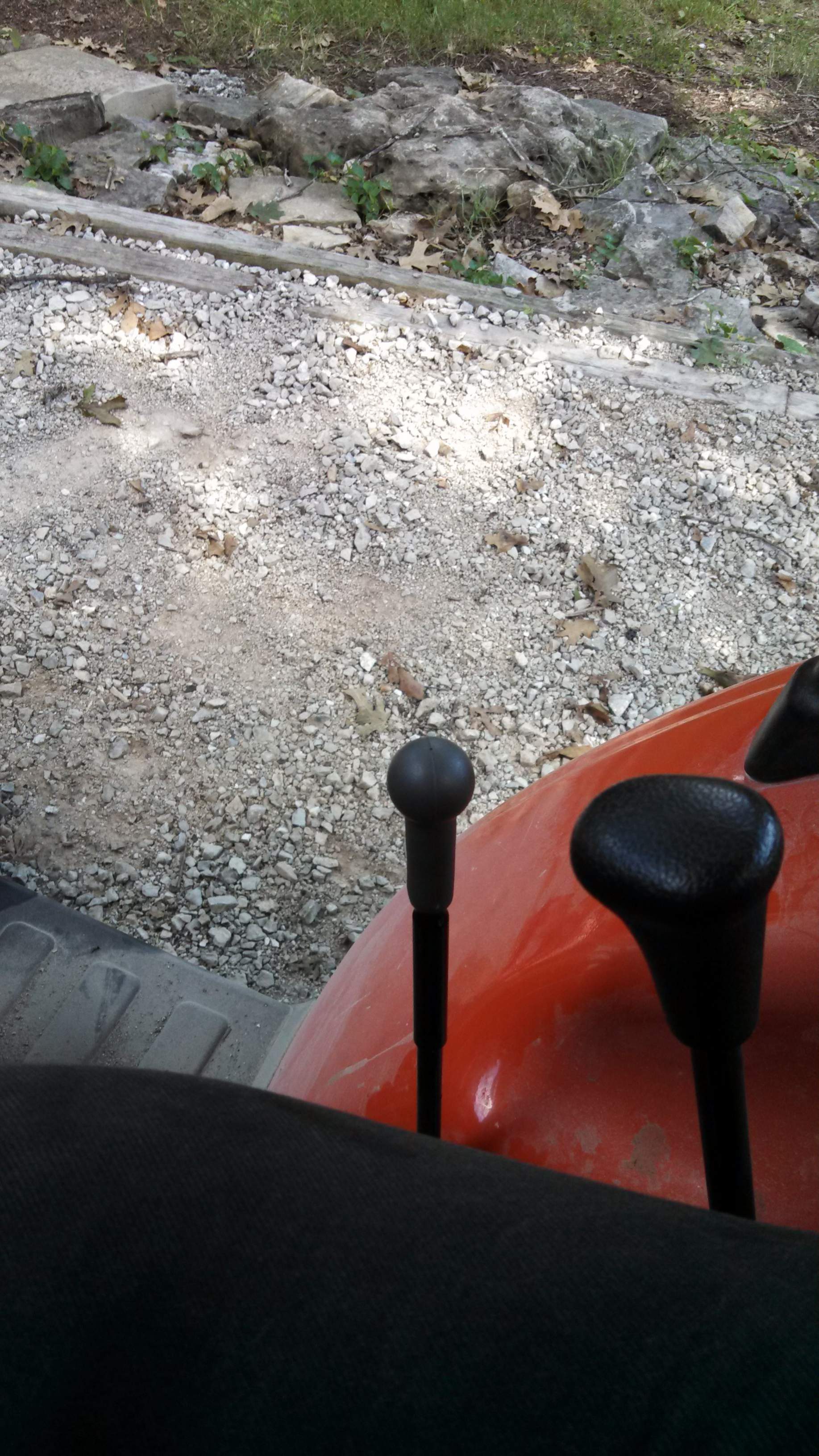

Everyone will have an opinion on this, but yes, I have one too. And I think the "true third function" is overated. But then again, I don't have/use one. I have a convenient rear remote valve that I use with my fingers while my palm is on the joystick, I again opinion only, but I believe I can operate and set up and grab rocks and brush just as fast as a "true third function" button setup. I also believe a diverter that uses your joystick to control both the lid and curl function would also be just as fast. Others will disagree, but just how many angels CAN dance on the head of a pin?:D
View attachment 406044View attachment 406045View attachment 406046
