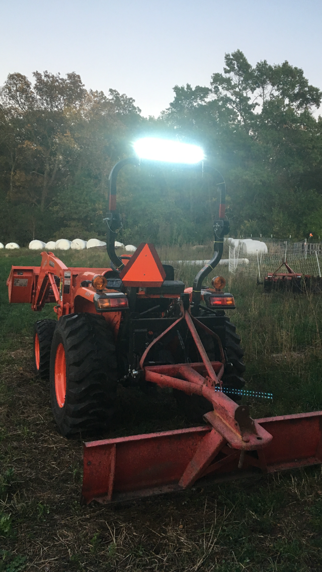

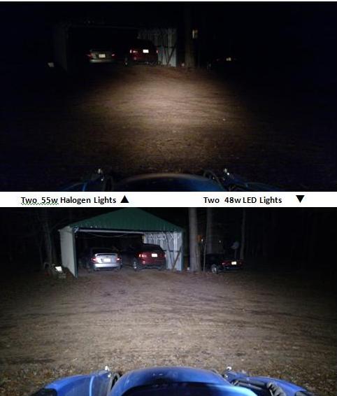

Ditto for me. Those LEDs worked great. Mounted them on the ROPS of my Kubota L3901. Put two facing forward (see photo); put another facing backward when I discovered that I couldn't see anything at night when backing up. The lights are of very solid construction and provide ample light.

Do you have any existing lights on the roof of your cab? If yes, use that circuit. If no, there may be a spare power plug under the seat for a work light. I used 2 48W LEDs from Amazon that cost less than $25 for the pair!
Went ahead and placed my order. Bought two of the lights you have, one for the rear of the tractor, the other can go on my Ranger, not sure how I went this long without a rear facing light for it, and a 22" curved light bar for the front.

I started reading this post because I sometimes mow at night on property that I am very familiar with. The lights on my JD do not allow me to do that, but the Kubota does. However, the FEL kind of gets right in the middle of the light stream, so I either have it raised too high or too low. I was thinking a light bar across the bottom of the sun shade might be a good idea. I read where the light connection is at, so all is well.
