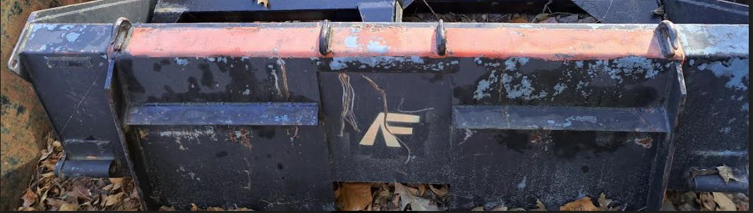

/ Adding grab hooks on front bucket, 2 or 3 hooks? #75
I put one on each side and a receiver in the middle. Can use it with a hook or with a ball mount to move trailers.
I put a piece of sq tube big enough that the bottom of the hook clears the lip of the bucket. It also reinforces the edge of the bucket.
