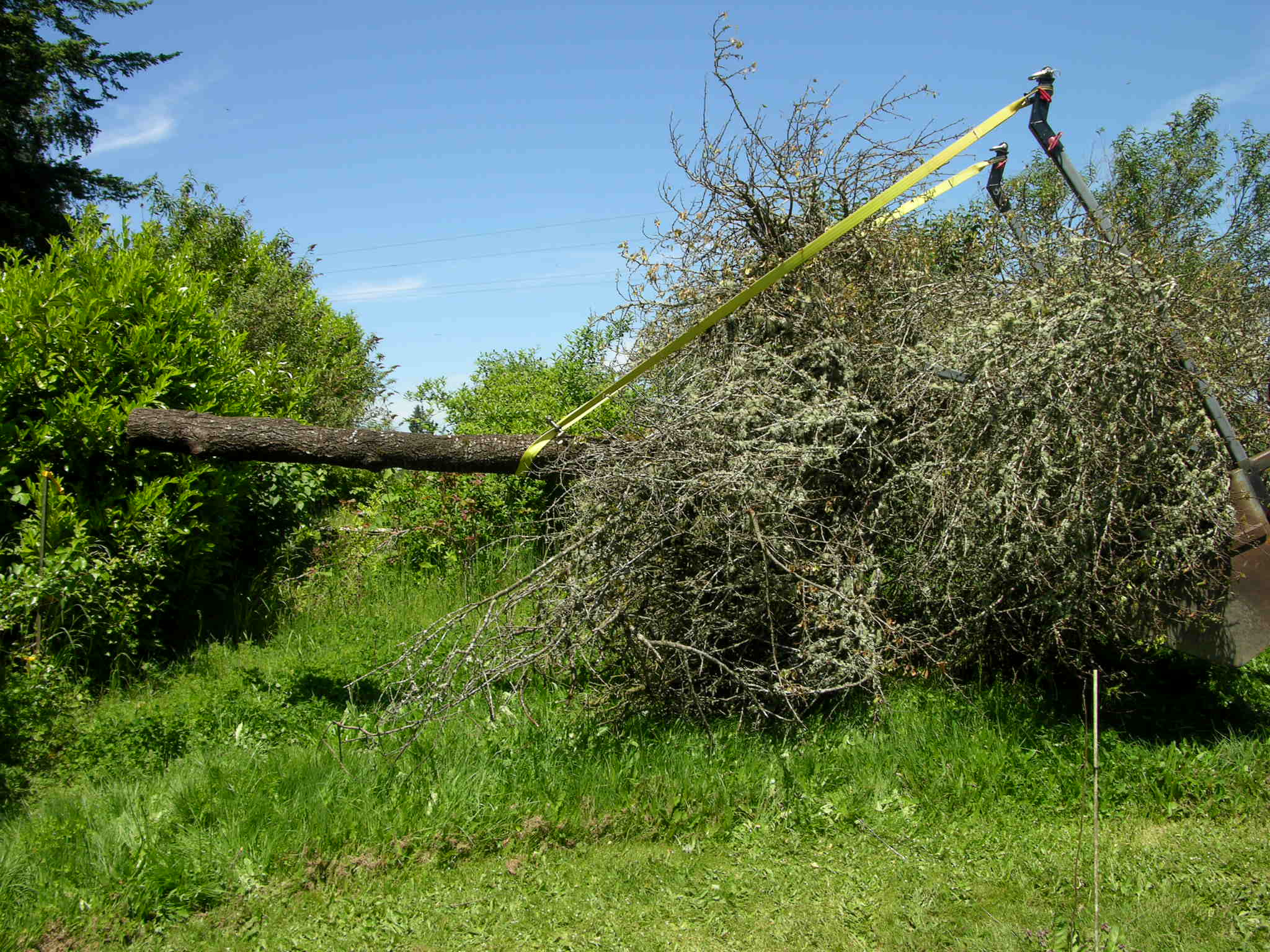

For that single hard pull that will damage center of bucket I op for something different on front of tractor.... Its equivalant to straight "draw bar" on rear of tractor...

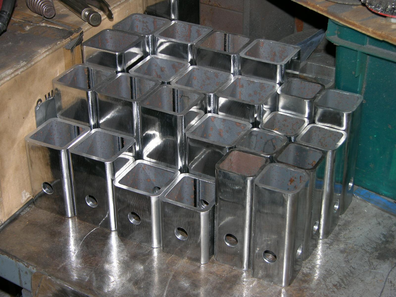

I bought hooks & clevis plates from BOH - they are quality products. Great for pulling posts and tying off brush that needs to go to the burn pile. I went with 3 hooks and 2 clevis plates.

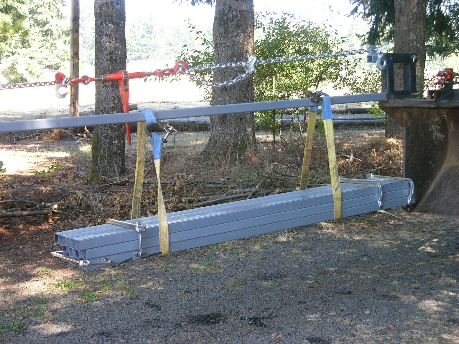

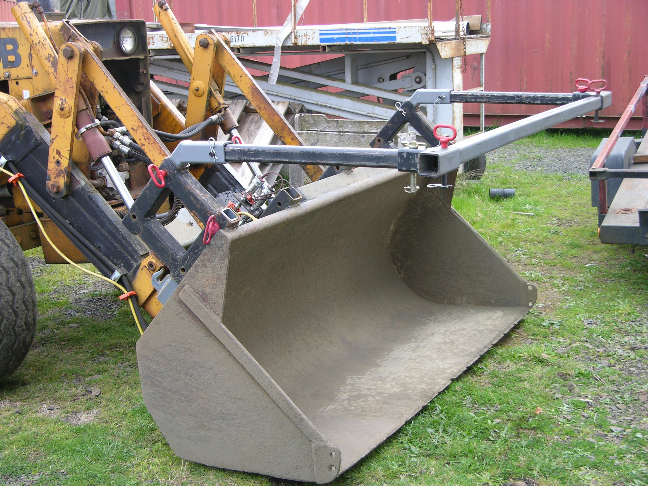

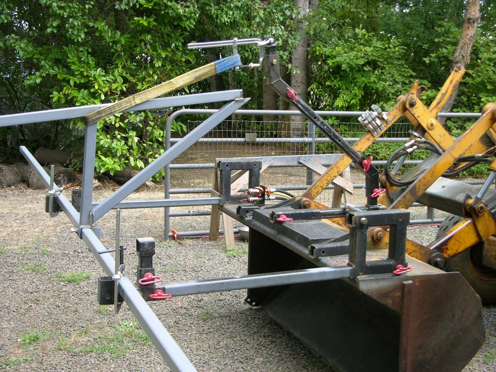

However if you read carefully. I did say I pulled the rear end of a 14k tractor off the ground several times with my side hook trick. Even lifted the REAR of the 4k pound forklift to change tires like this...it does work.
I'm not convinced but I am done. I offered what I know - Didn't mean to make it sound like that is what everybody should do. To each their own. GL and Cheers.
