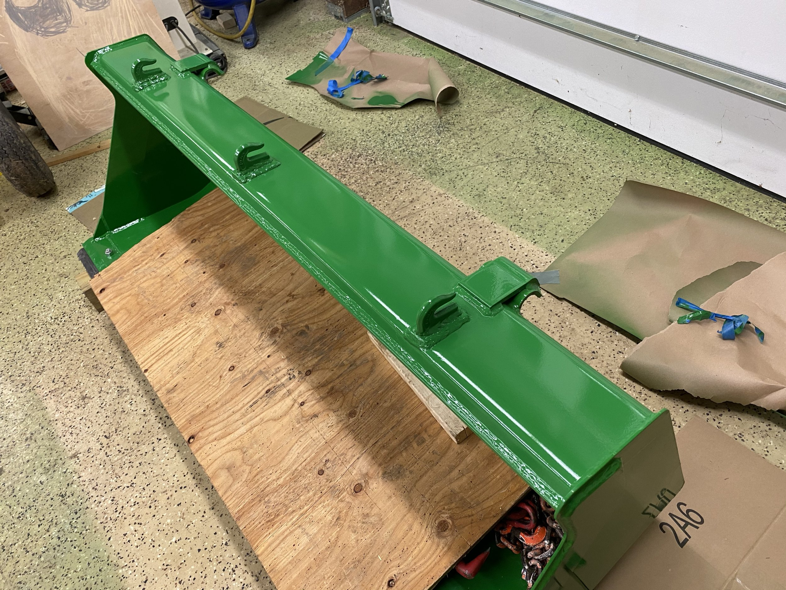

About to order some weld on grab hooks for front bucket for B21. 54 inches wide or so.
Was going to put 2 hooks a few inches in from each end, but have seen some with 3, one in middle.
Any real reason to put a middle one in?
/ Adding grab hooks on front bucket, 2 or 3 hooks? #4
yes, I would do the same as RjCorazza one on each end and one in the middle... If you want to lift something and keep it stable, you will want to use the two on the side and if you want to pull something then you would use the one in the middle.
/ Adding grab hooks on front bucket, 2 or 3 hooks? #5
I did three on mine, as well. Two on ends are used with a 10' loop of 5/16" choker chain for lifting whole logs, or when my approach to something that needs to come from one side or the other. The one in the middle is used for pretty much everything else.
You could run a slack chain between the two side hooks, if you were lacking a middle hook, but it multiplies the side force on the side hooks, by the angle of your dangle.
Don't laugh at my welds, these were done blind with flux core, before I had my MIG set up with proper gas.

I have one on each side in line with the hydraulic rams. At times I do think about adding a third in the center, just never got around to it.

I put one on each side and a receiver in the middle. Can use it with a hook or with a ball mount to move trailers.

3 hooks, one in middle hook facing up and two on top leading edge facing toward tractor
#16
"leading edge"? Open or closed end? Everyone I've seen has the open end of the hook facing back toward the operator.

I put 3 hooks on my bucket. 2 outside in line with the loader arms, and 1 in the center.
Same here...but in my case, I use the center hook for light stuff and the outer hooks used for heavier or unwieldy loads. Using the out hooks spreads the load
