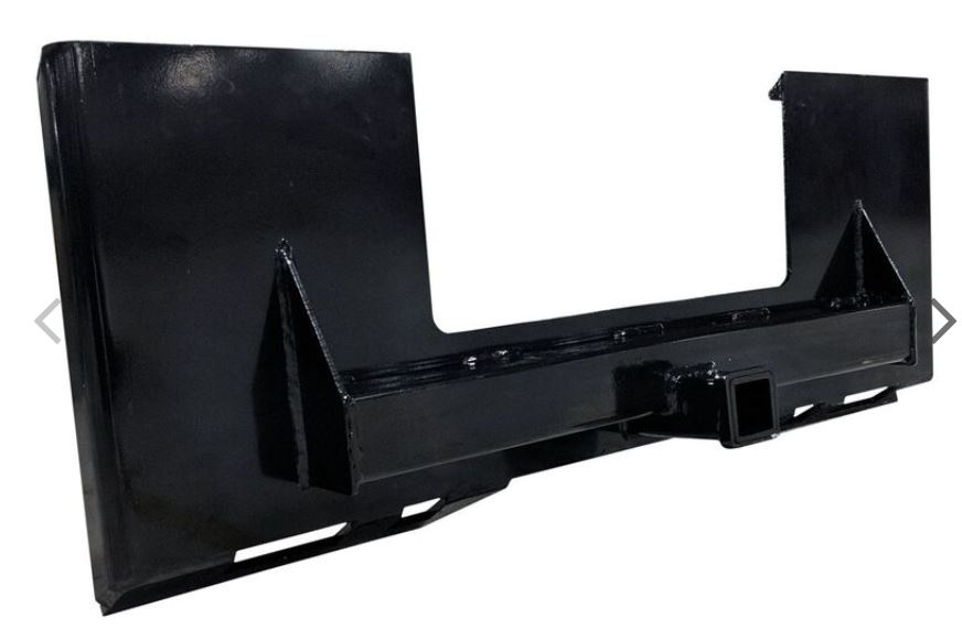

How do you use the receiver? I can't see how you would be able to hook it up on a trailer unless it's a goose neck ?
I think you would need a big ole drop hitch and then you would be working blind... just like forks on a bucket - Ugh!
I chose a SSQA receiver hitch from titan.

/ Adding grab hooks on front bucket, 2 or 3 hooks? #28

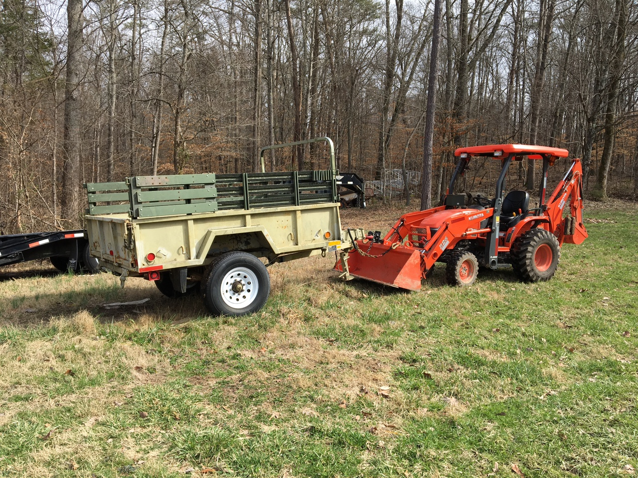

ha ya a big drop hitch make sense... my technique it to have a chain off my 3 point arms then I back up until the chain get under the trailer tongue, lift and back up some more, lower on the hitch and off I go ...
Your are right. Top hitch mount receiver for larger tractors have limitations.
B26 is a small tractor with a low height bucket. Most of my hitches are 4-6” drop. Pintle hitch is easy.

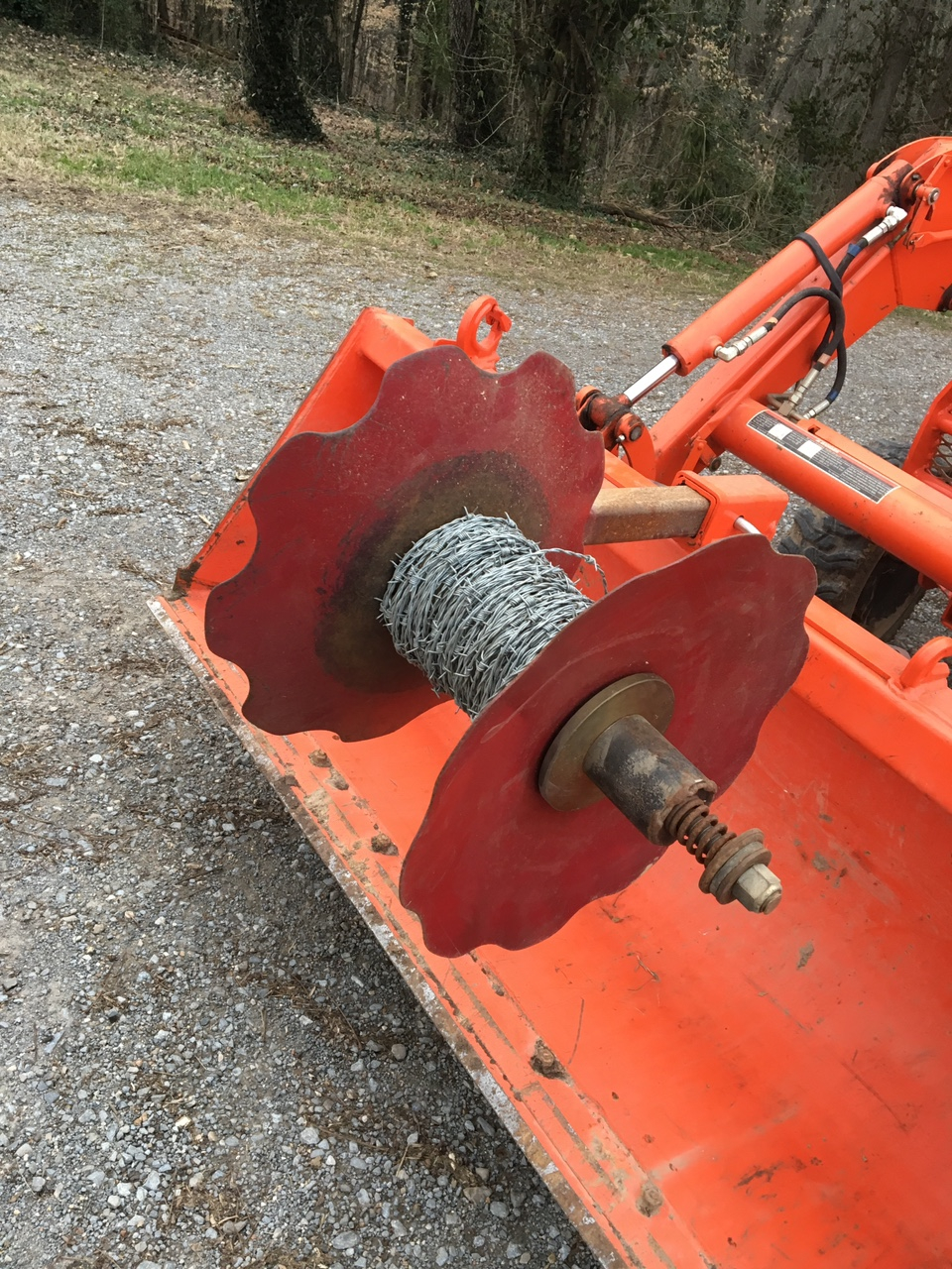

Other attachments.
2” receiver bale spear, vises, crane, and other shop tools.
