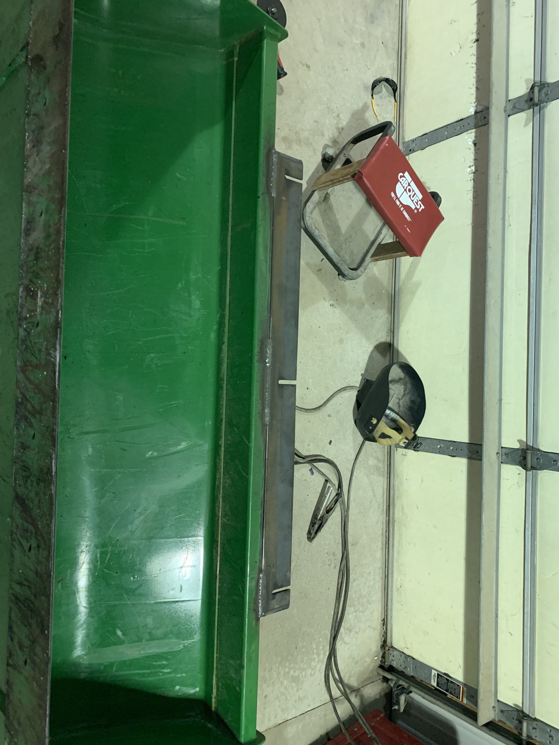

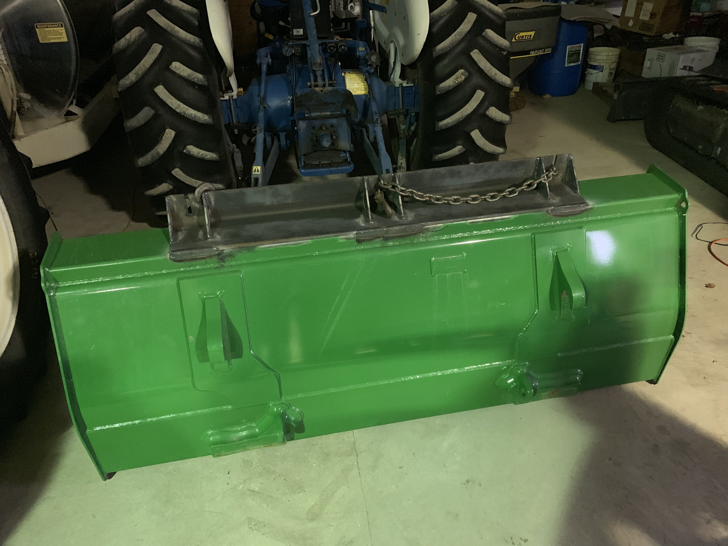

Here’s what I like to build for a bucket chain grasper, angle iron with slots I cut in. This one I just made for my Deere 5115m, 540R loader, 73”HD bucket. Angle iron eliminates any chance of bending top of bucket, handles side loading the chain no problem. When I set a large stump on brush pile I’ll tip the bucket forward and the choker chain pulls free of the center slot as I back tractor away a few feet, makes chain retrievel off stump much easier and faster. This one was 4x6” x3/8” angle, 1/4 “ gussets. Smaller tractor loader 1/4” angle would be plenty strong I’d think

Nice setup, Seven Gables. Although I still prefer the forged hooks, I do wish I had thought to buy a standard bucket and simply re-enforce the top like you did. I went the route of the "Heavy Duty" bucket from Deere, as I'd seen too many of their standard buckets bowed on top from lifting logs on hooks (primary use of my tractor) and I'm not loving it.
1. Way too heavy, requires me to ALWAYS carry ballast, even with empty bucket
2. Hardened cutting edge can easily damage driveway
3. Bolt-on edge prevents use of a lot of common bolt-on or clamp-on bucket accessories
As much of a PITA as it is to set up and repaint new bucket, I'm thinking of buying a standard bucket, mod'ing it better to my liking, and then reselling the HD bucket to someone who really needs it.
