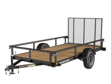

Bought a small 6x12 Karavan utility trailer from HomeDepot. It isn't the greatest trailer by far, but it was in stock and makes up for my new 5'3" bed in the new truck. It also has fold down rails so I can lift pallets onto it which many of these other trailers didn't offer as an option. The trailer will be used to move/haul things that are too large for the truck bed and for brush, wood chips etc. from time to time. Not sure I want to add the wooden rail by drilling and bolting to the trailer since I then can't drop the sides down since they won't clear the fenders.

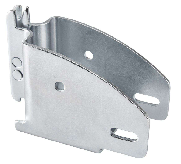

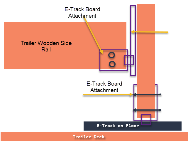

I am wondering if you can make the rails out of E-Track so I could just snap them in and out when needed. If the board mounts normally used for shelves in an enclosed trailer could hold my corner supports (vertical board) then I could just put a piece of e-track on those and place the boards in. I'm thinking since it would be attached at multiple points it may be strong enough. Is this a dumb idea? Has anyone done this that can share how it worked or pictures?

I know that the board/shelf holder attachments are always shown for horizontal attachment to trailer walls to support a shelf or divide a space. I guess I need to figure out if they can support a vertical corner post. What other options are there for quickly taking side rails on/off. I don't have any pocket stakes on the trailer.

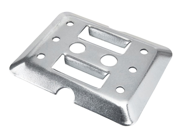

I put e track on the walls of my cargo trailer. I have a couple of sets of the holders that you can run a 2x4 rail horizonally across the width of the trailer. I think this is the accessory you want to use as a vertical rail with 2x4s? If so, you will be very limited because the strength of the device on the vertical plane is much less than the horizonal plane due to the little clip that holds the cup into the etrack. I wouldn't count on it to withstand much lateral load. It would probably be fine for some fluffy insulation, but I wouldn't trust it for holding, say, square bales of hay. That said, you could run e track right below the existing rails and use the attachment points if that offers any benefit. The e track is strong enough for the unsupported distance between vertical rails on the trailer, however, the clip in accessories are the weak link by far.

That is what I was wondering on the strength of the 2x4 attachment in the vertical positon. I got a 10 pack of them off Amazon and figure I'd give it a go. there will be 4 vertical posts and then a the posts going across the front to brace the sides and possible one out back depending. Those would all be in the horizontal clip location the way I believe they are supposed to be oriented.
I guess there is only one way to find out.

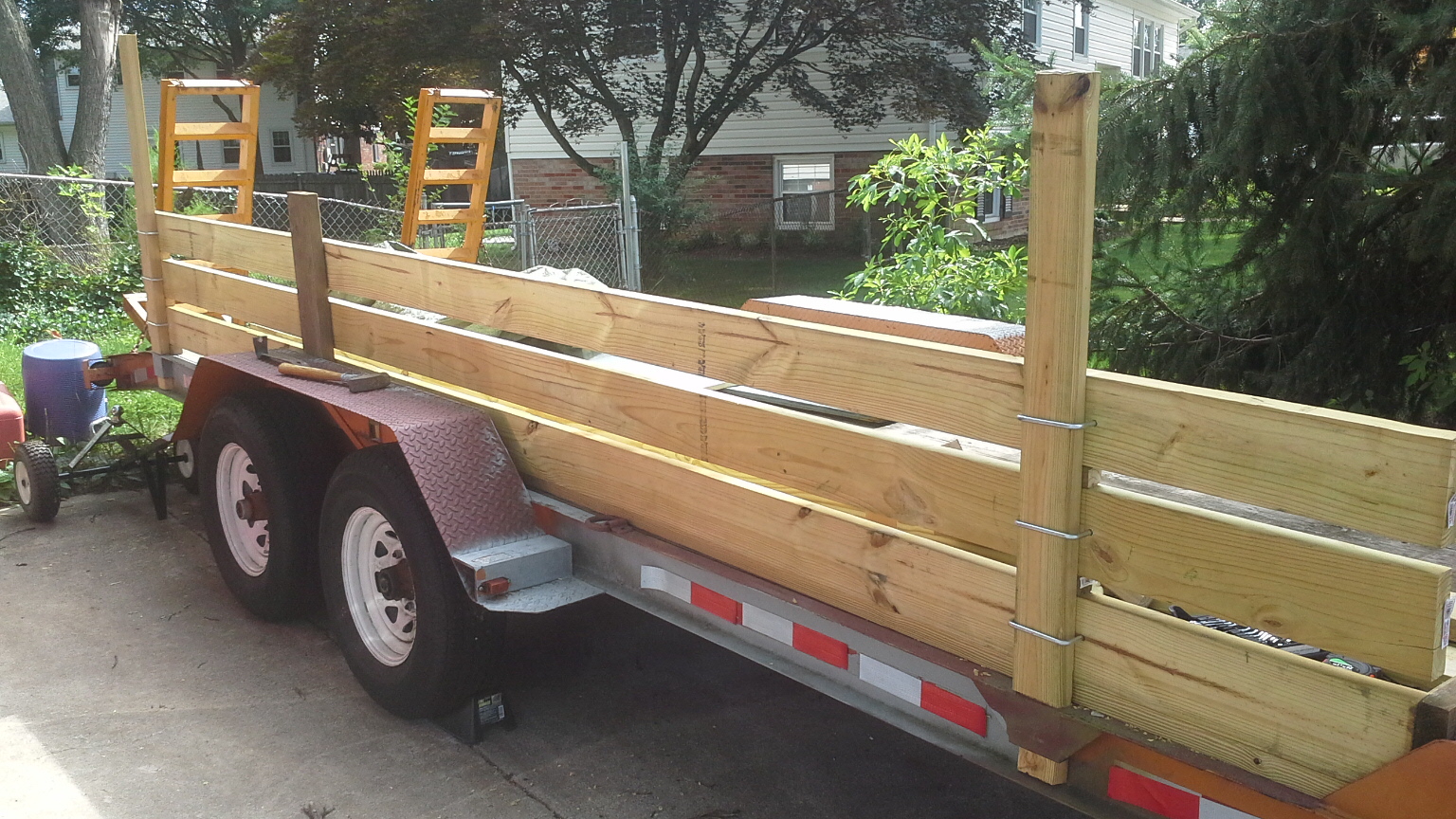

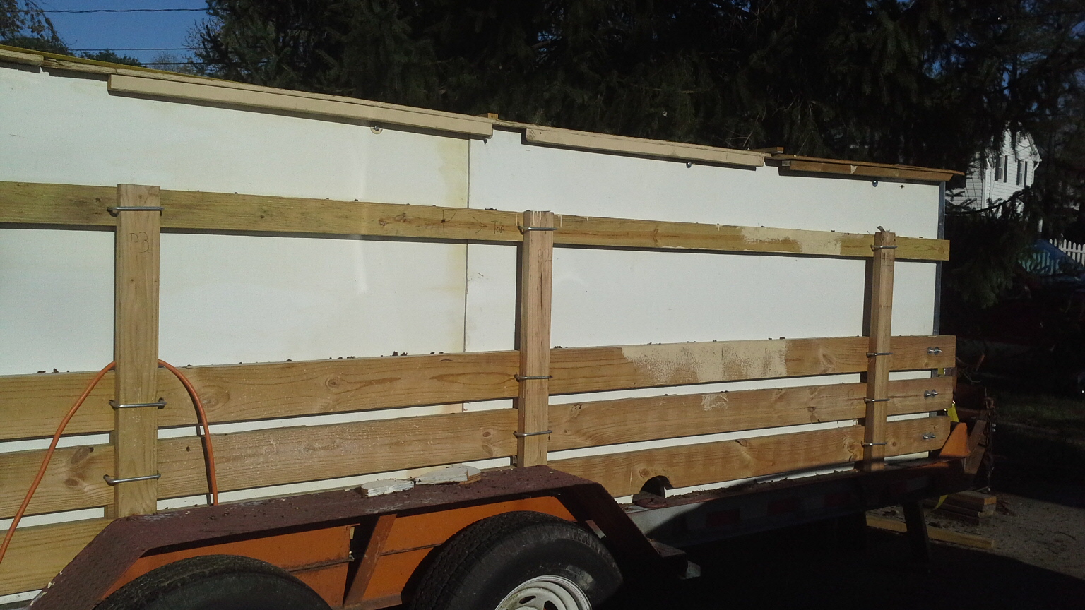

I'd use flat ubolts.
My 8'x18' 12K Hudson goes from flat equipment to enclosed (4' high) in about 3 hours of work. The side panels are 3/4 Marine ply.

Just leave a cut out where the fender is in your wood sides.
