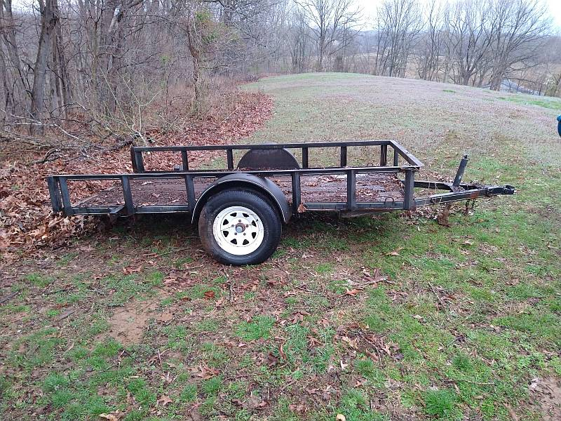

Once I get the Mean Green Tahoe Machine, I'll be able to do things I never could. One of those will be to haul the Little Blue Diggin' Machine. But I have questions.
Neighbor has a 5 x 10 trailer that has been stuffed off in the woods for many years, 15 at least. I pulled it out of the woods a few days ago and began looking it over. Structure is fine, but it needs work. Deck is probably shot and will need new planks Fenders are dinged a bit but can be straightened. One tail light mount is bent. Tail lights and wiring are shot and will need to be replaced. Trailer jack is tilted several degrees (mount plate is torqued) and will need to be straightened.

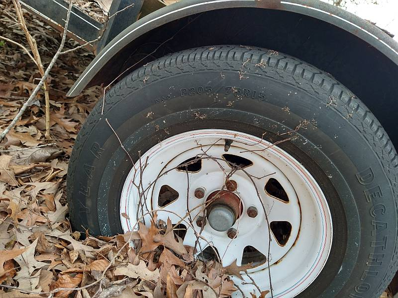

But for now, the question is on tires. Both are shot, unusable. It has P205/75R15s on it now, most likely not original. Tire store says those are not suitable and it needs trailer tires at $100/ea.

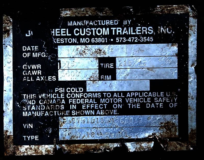

Tag says GVW is 1,575 and GAW is 6,600 (if I can read it right since it's very faded.)
Opinions?

so you need tires rated at 2500lbs minimum to respect the total rating assuming it has two tires not four. but I would have doubts about fully loading a trailer that has been sitting for so long. some people have had good luck with truck tires, I used maxxis trailer tires on my home built 5.5x10 single axle

Yes, two tires. Plan on replacing the deck planks. Frame seems solid from what I can see so far, only surface rust. No ramp(s) though, so I'll need to work something out there.
SCUT is listed at around 1,500 by itself, no FEL, MMM, etc. Tires are loaded. I figure 2,000 or so, meaning trailer will be less than half loaded if I'm understanding the numbers right.

I'm thinking the gvw and gaw may not be right or be illegible. GVW is max total weight of trailer + load. 1575 seems pretty low unless this was designed as an ATV/snowmobile/raft type trailer. GAW is max axle load and is not typically listed on utility size trailers.
Knowing what style of hub, the stud bolt pattern, style of axle, and diameter of axle tube if solid would give some clues.
Unlikely a 5x10 commercially built trailer with a single axle would have greater than 5k axle rating
Also most commercial axles will have some kind of a tag attached to them with a load rating. Usually on top of the axle tube maybe with a metal tag

Problem is, I can't really read it. Possibly 3,600?
/ Tires on a utility trailer. #9
That is almost certainly a 3500 lb axle. I agree 575 lb sounds like the weight of the empty trailer or the tare weight. So your load capacity would be just under 3,000 lb
/ Tires on a utility trailer. #10
Looks like original tire was 215/15 on tag. Probably 215-75-15 ST trailer tires load range D 6 plys. Hard to believe gvwr is truly 6600 for single axle trailer with no brakes. Most utility trailers with single axle are under 3500 so they don't need electric brakes.

If the gvwr is truly 3500 and trailer weighs 575 your load limit technically would be 2925 lbs.

It's on you to figure out the load rating on axle but I can tell you I've never seen a 5 lug hub with capacity less than 1250 Lbs x 2 = 2,500 for two wheels,nor more then 1,750 Lbs x 2=3,500 Lbs for two wheels. Based on experience gained from decades of owning and operating trailers I NEVER put trailer rated tires on ANY trailer unless it's an emergency with no other option. I use LT tires rated C through G as load requires. For occasionally used trailer I normally buy new tires for a truck and put used tires from truck on trailer. LT vs ST argument has raged on since tires were assigned ratings because some don't understand that in addition to load capacity truck tires must pass additional tests that trailer tires don't.

Tag says “215/75” so go with that. Most likely a 3500# axle. Compare to one’s being sold at tractor supply. Tire shop is probably saying to do not put regular automotive tires on it because they are not suited for trailers. There are probably thousands on the road with them anyway but not encouraging you to do that.

Diggin It, look at the tag, call the phone number and talk to them. Maybe with a few pictures of trailer and tag, they can figure out what the trailer is rated for and what tires should be on it. Jon

In my opinion that trailer has too much rear overhang to safely haul the Little Blue Diggin' Machine:

Whoa it's only a 5 lug I swore I saw 6 initially oh well looks very similar to my 12' I'd never haul a tractor on it . that size trailer is comes in very handy for other things. good luck.
