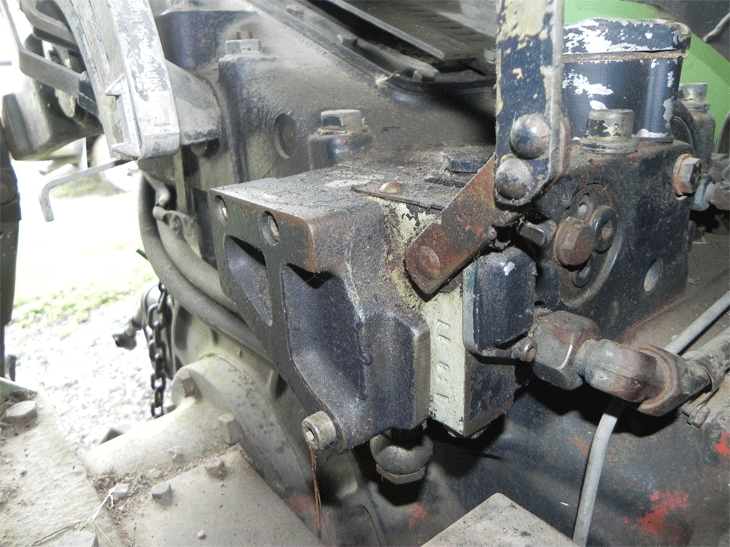

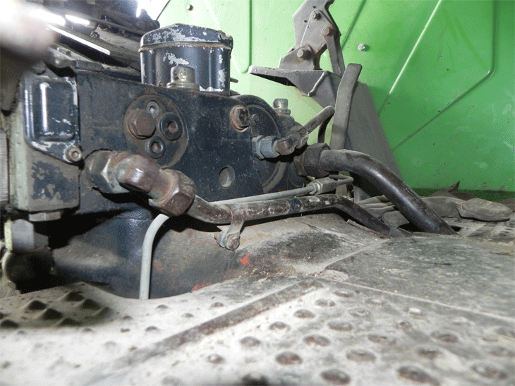

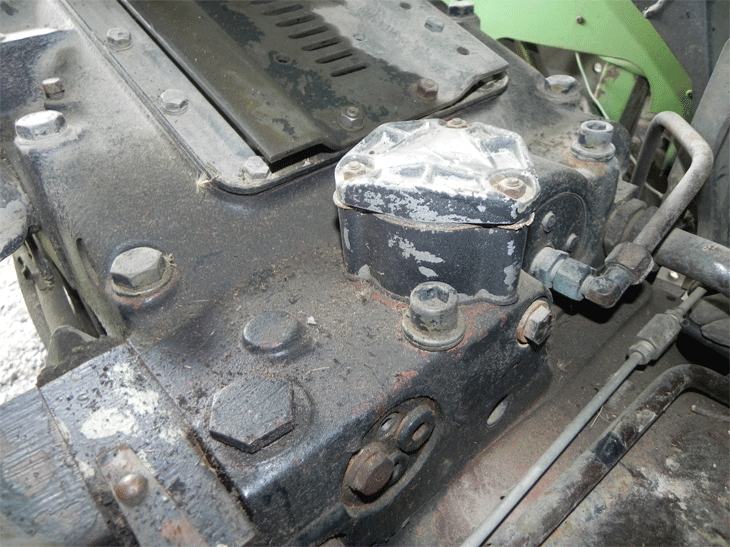

I have a 6275 Deutz with one set of remotes and I now now need 2. Dealer claims he can not get an additional spool valve to add on to my single. Is there some place I can tie into the hydraulics to add an after market spool valve. spool-valve.gifhydr2.gifhydr3.gif

Which one of those lines is the supply line?
Trace back from the pump.
I thought the pump was inside that big block of metal that had all of the hydraulic lines coming out of it. Was hoping it would be as simple as taking that plug out that is in the second picture and putting a hydraulic line there to spool valve. I will follow all the lines and take pictures of anything that may be a pump. Please stick with me I'm not stupid just uneducated about hydraulics.
Thanks Sam
/ adding another remote #10
If the pump is in the case, is there any pressure line that exits the case?
If so, insert the valve is series.

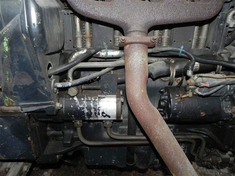

here is a picture of what I now believe is the pump. A line goes from this to the block and enters on the left side in picture 2 from my first post, exits on the left to the cylinder for the 3 point.

All you need is a supply line before the flow gets to the 3pt and insert a two or three spool valve in a convenient location.
So just add a tee fitting in the supply line?
/ adding another remote #16
If you tractor is open center, all valves should be in series with the PB from the first valve feeding the second and so forth.
If your hyd system is closed center, the you can tee all valves.

Ok, found some specs on tractor that says hydraulics open. so from pump to new spool valve with power beyond back to where the line was going. I had another question with the hydraulic capacity of 17.7 gal would it be ok to use a spool valve with a 25 gpm capacity.

From the photo
Your D-A has a duplex pump, with one pump certainly devoted to power steering needs.
The second section of the pump is available to power any 3ph and remotes.
When I added a loader valve to the Hurlimann, I taped in on the FEED line that supplied both the 3ph and the OEM remotes (smaller tubes are the high pressure supply, big tubes are returns) to supply the new 3 spool valve. The power beyond port from the new valve then connected back to the existing fluid supply line. Now I have a dedicated loader valve (that takes priority) as well as the OEM remotes and the 3PH with both position and load settings.
All good!
But, I've also got one of those manual "diverter valves " as Mtview posted set up to supply two cylinders on the york rake. Depth and angle (not at the same time) It works just fine.
Clear as mud...right? ;-)
