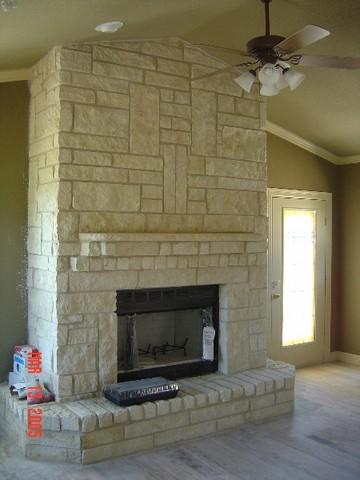

Here's the fireplace I had built for our new addition. It's real stone veneer, but the fireplace is a zero clearance with a lined flue pipe. This setup greatly reduced the cost (About $4k savings) compared to a true masonry fireplace. This one actually has another fireplace on the outside, with it's own flue (next post). The total cost was approximately $6,000 including the stone, labor, fireplace inserts etc.

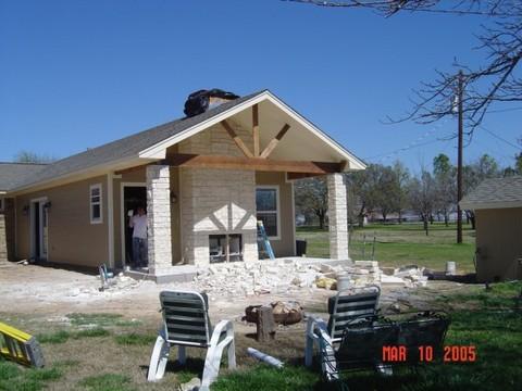

Exterior fireplace
