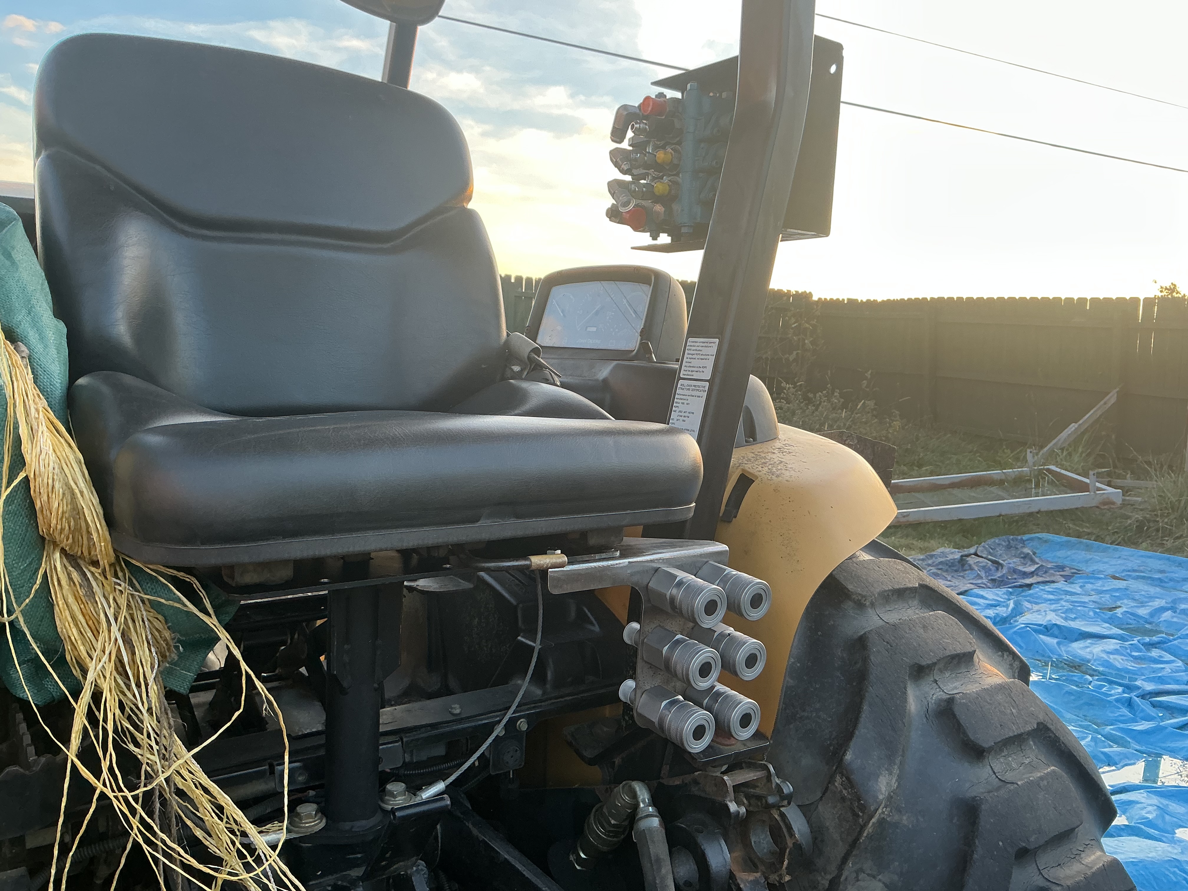

I plan to plumb with 1/2” steel tubing from the valve to the connectors. I want to use flexible hose only where flex is necessary.
The coupler body is essentially one piece with a 1/2” JIC machined on the end.

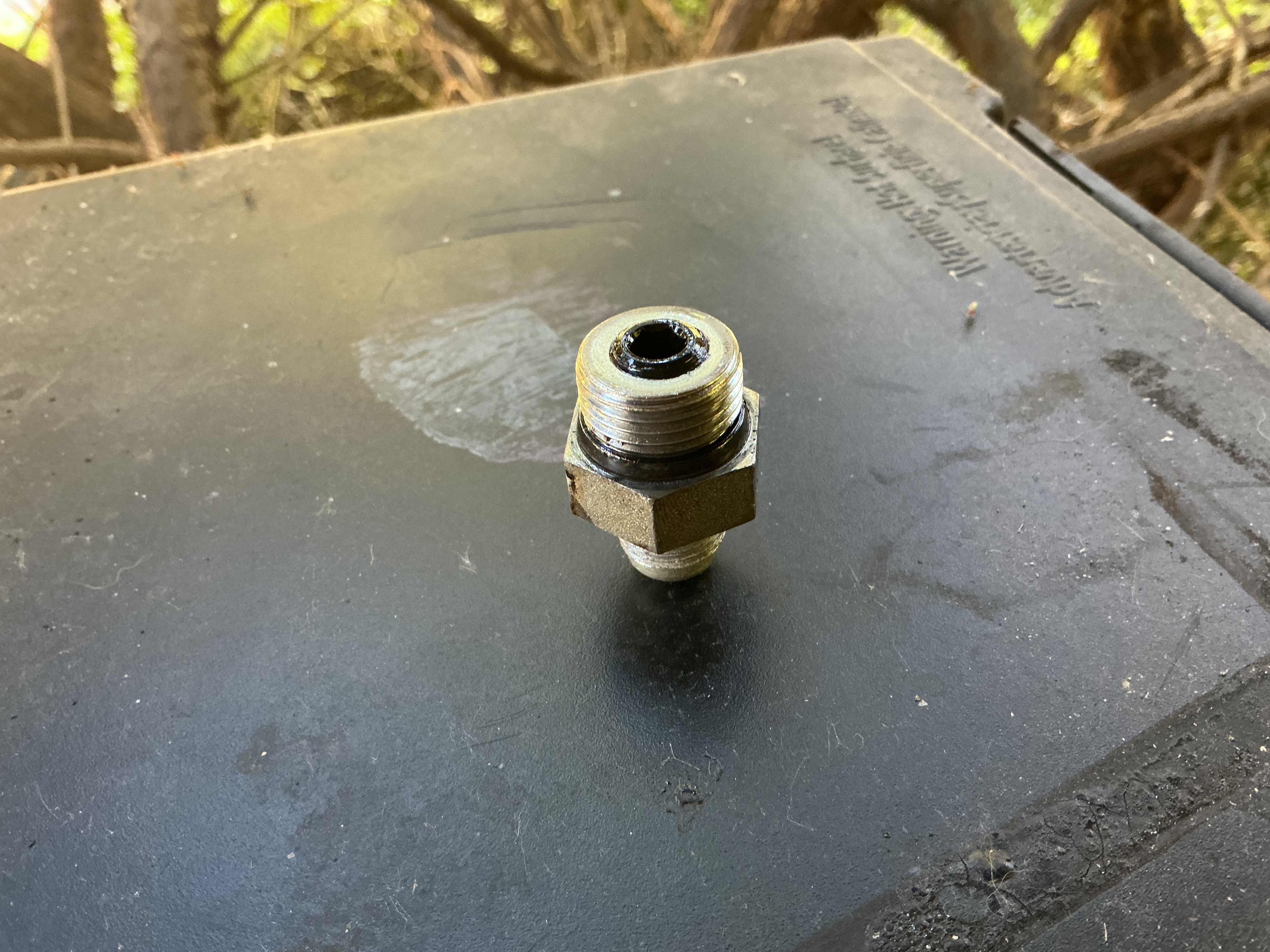

While the six fittings in the work ports look like ORB, three of them are special. The special ones have an additional O-ring on the bottom face. I’m not sure the purpose but I don’t want to change anything there. All six fittings have 3/8” male JIC to connect to.
I have a ridiculous amount of time in this project because my shop is 200 miles away, I have little hydraulic experience and a stubborn desire to archive a clean installation.

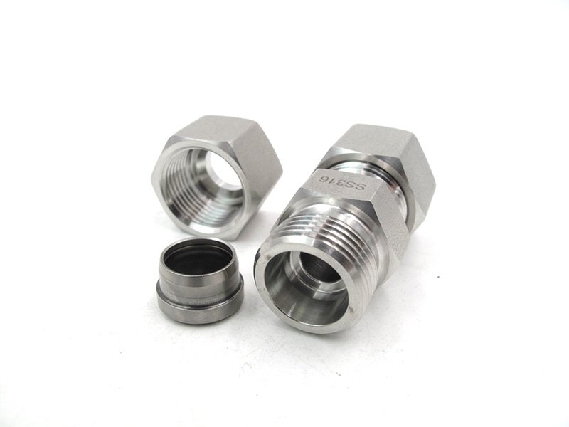

Doing this with metric tubing would be as easy as it gets. Pretty much just needed a tube bender for the bends and a pipe cutter (not necessarily needed but makes the job easier).
DIN2353 crimp fittings would make it very easy and simple to use as there is no need for flare. Just slide the tube all the way inside the fitting till it stops and tighten the nut.
L series tubing would handle all the pressure that machine can produce and it's still easier to bend compared to the thicker S series tubing.
That's the route I went when I built the loader for a Kubota B7000 way back in the day. More recently, for the Branson, I also used hard lines but machined and welded the fittings on the tubing.
   / Adapting JIC from 3/8” to 1/2”? #18
That is the type of tube bite fittings I was refering to. Your skills with tubing fabrication are amazing.

This project has turned out to be more complicated than expected and I’m barely halfway through.
I simply want to connect a control valve to the quick couplers. The control valve has six 3/8” male JIC ports with 9/16”-18 thread. The six quick couplers have 3/4”-16 male JIC threads.
So simply put, I want to connect a steel line to a device with a 3/8” male JIC on one end and a device with a 1/2” male JIC on the other.
It seems like a simple process but I can’t find a way with either 1/2” or 3/8” steel lines. Is this possible.

The simplest way to plumb this would be to get 1/2 x 3/8 tube end reducers. They are just a nut and a male 3/8 jic that screws to the end of the 1/2 male but then you would need to use 3/8 lines.
