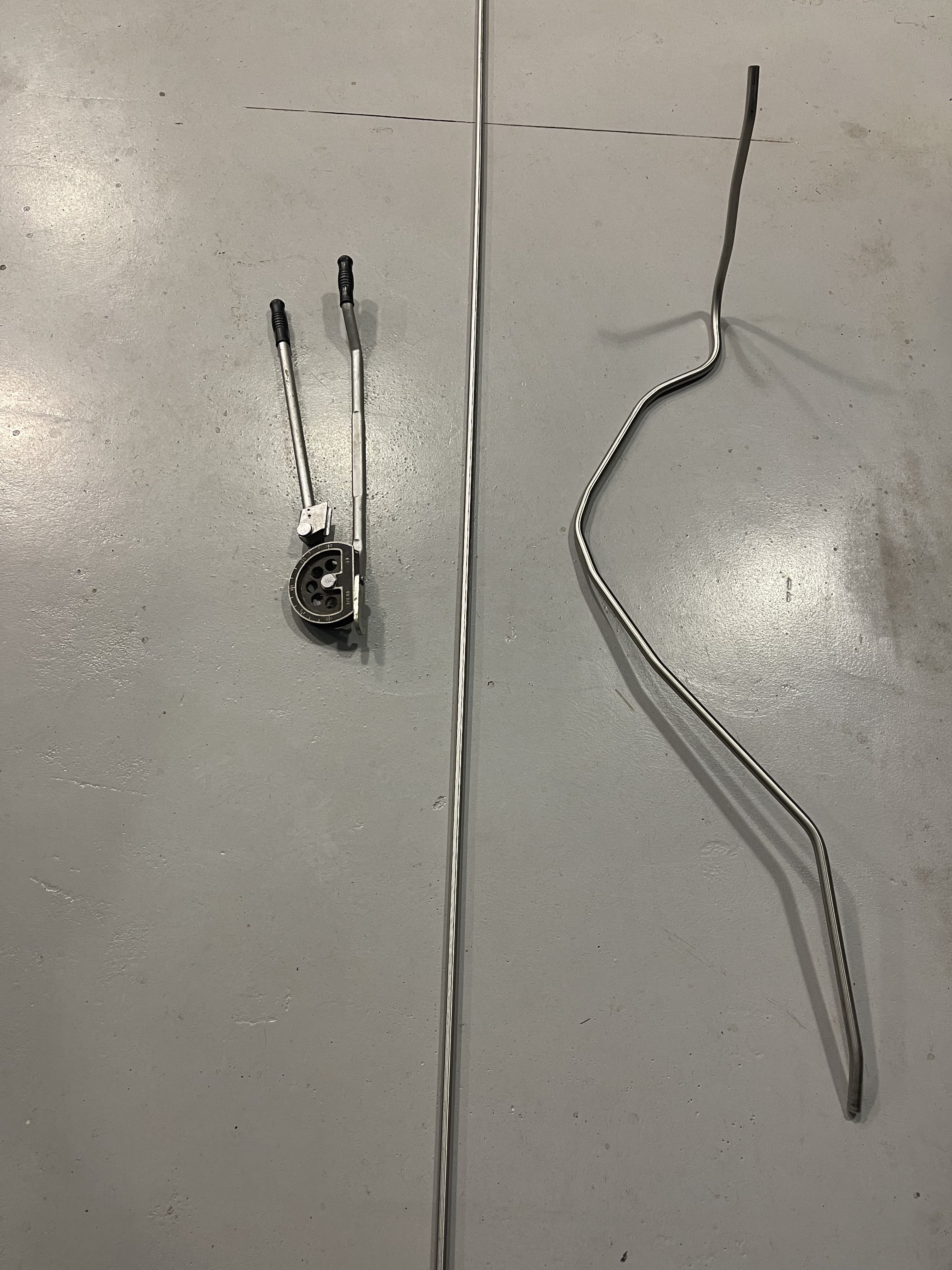

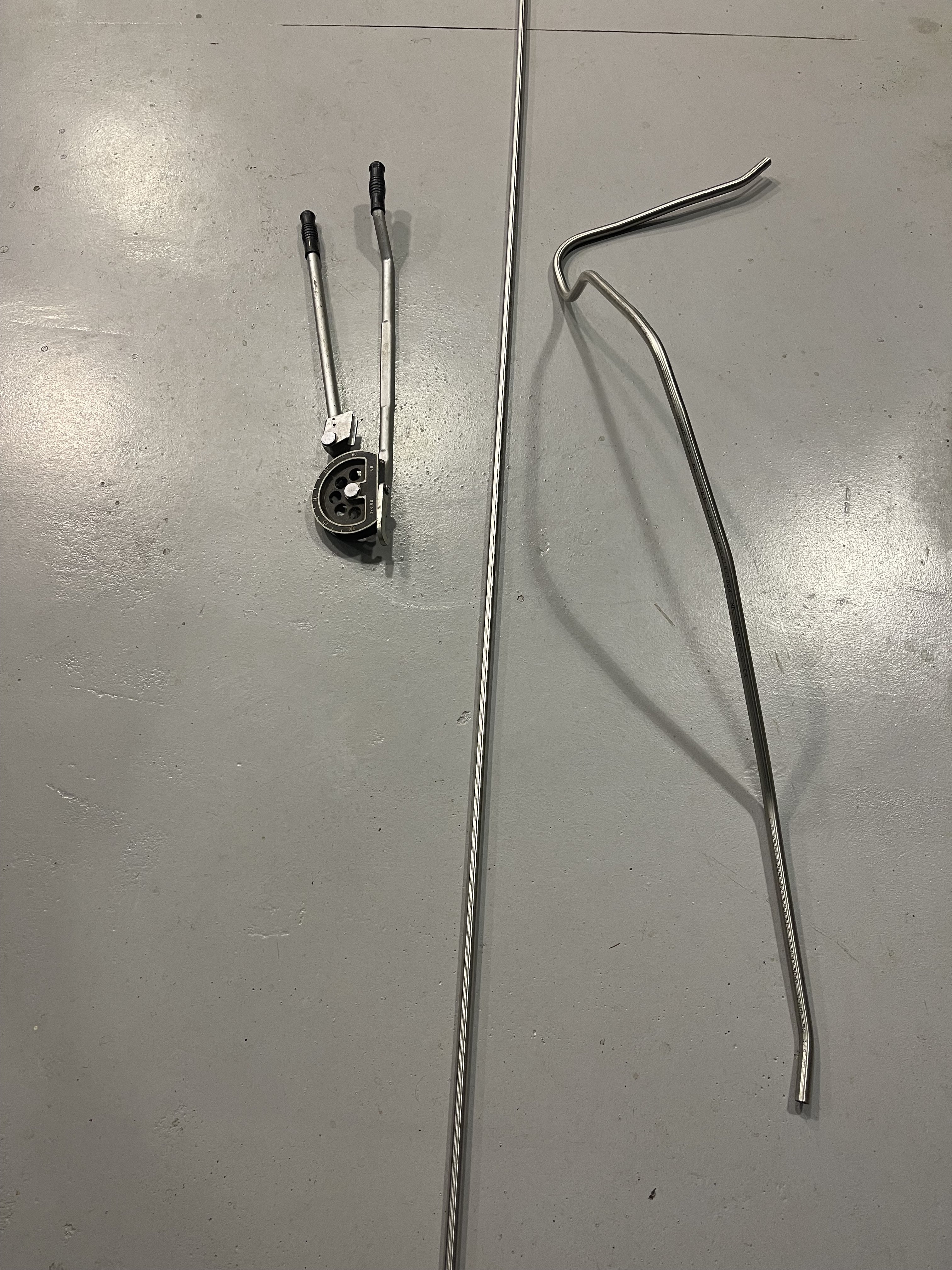

Its more like bending conduit since you cannot really undo the bend, and your trying to line everything up. For 1/2" I use carbon steel or stainless seamless tubing.
To bend it I use a Parker #8 sliding block. For larger tubing I use geared Ridgid benders.
To flare it I use a Ridgid 377 that has an eccentric head so it is not trying to flare all the tube at once.
To cut it I use a Ridgid 15-SI cutter with the correct wheel for stainless
To deburr it I use a Ridgid 223S.
To put a fitting on the end you have two main options:
Flareless.
These are bite to tube fittings, you cut the tube, deburr it, then clean the outside, slide it on then tighten the collar. The advantage of this is that you can get lots of different types of threads, the downside is they are expensive and bulky.
Flared fitting.
Your mostly limited to female JIC 37 degree, or SAE 45 degree of the size that your tube is. They are cheap, and compact. Downside is that the require special tools to make, and you are limited on thread options.
Also I suck at it. Buy 3x the tubing I need and cuss at it the whole time as I fill the scrap bin. Having the right tools does not mean your an expert.
Would those flareless fittings accommodate some variability in the pipe lengths? With hard lines, that's what I'd be most worried about since they all need to start and end in the same plane. I suspect that would be really difficult to get right when flaring the ends.
   / Adapting JIC from 3/8” to 1/2”? #24
They provide a little variability, but not much.
   / Adapting JIC from 3/8” to 1/2”? #25
I have never made rigid hydraulic lines, but imagine it requires a certain amount of specialized equipment and materials to deal with the high pressure. What sort of pipe? How do you bend it? How do you put a JIC flare on the end? What sort of nuts and collars or other stuff is needed? I don't think it's like working with copper pipe, or even brake line pipes. Maybe someone has experience fabbing hard hydraulic lines and can speak to this?
I have benders up to 3/4 OD for the tubing and the flaring tool to make up all my steel tubes. You select the wall thickness of the tubing to match your pressure requirements. Sometimes I have to weld the fitting to the tubing. I am making some 3/4” stainless tubes for my Massey Ferguson project right now.
