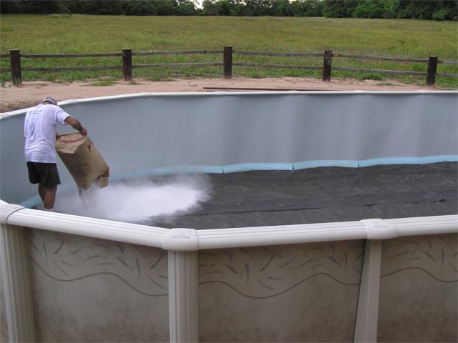

Ordered pool on fri. Should be in this week. Went with a 52" 24' round with resin top rail and styles, snap in liner, sand filter and walk in step type ladder.
Preliminary excavation of site is done. Luckily fairly level to start. Hopefully begin pool install this week. Deck install will commence as pool is finished.
Question. Did/will you use sand under liner? Do you put sand down before or after placing bottom rail?
Thanks,
   / Above Ground Pool Install #46
I put some sand in before putting the rail down. I then put the rail up and the side up and went around sloping sand to the middle. I added a couple of scoops of sand of the side as needed.
   / Above Ground Pool Install #47
Renob, The pool is installed in a sand hill. The bottom rail rest on the hill sand. However the kit came with a bunch of bags of Harborlite (expandable pear-lite) to put under the liner. See picture. My pool is also a 52" resin pool. I put the side supports on level 12"X12"X2" cement blocks, making sure no more than 2" of the block was on the inside of the pool. Rained out again right after this picture.

   / Above Ground Pool Install #48
I would put all of the sand in a couple of piles inside the pool before putting the bottom track together and then after wall is set up move it around. I have put all of the sand in after the wall was up, that wasn't any fun!!!

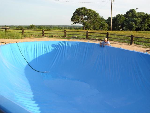

Step 24 is filling the pool with water, finally.
It took 2 days and this evening the pool is full.
(The wrinkles came out.)
This is a tough job with just 2 people, but it can be done.
The pool came with an underwater light kit called the Hayward Elite underwater quartz halogen flood light for above ground pools. It is an excellent addition and easy to install. The kit included a tool to make a perfect cut in the side of the metal wall.
Next project deck.
