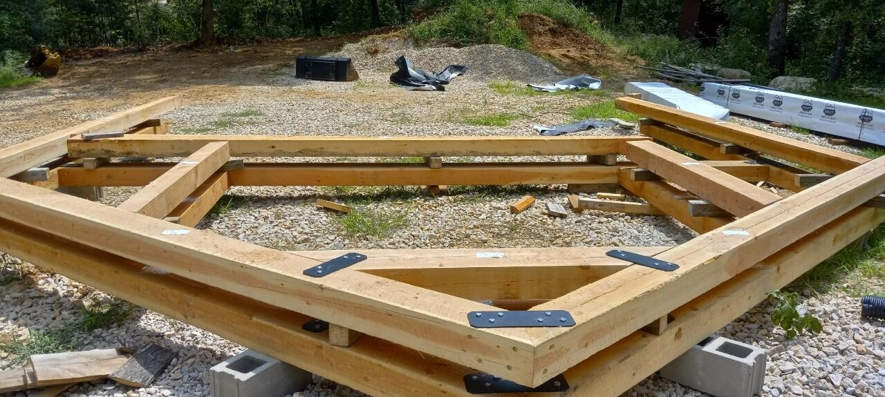

Second bent of 4 being put on the stack and some of the joints/plates have been secured. I did most of the first bent myself and a buddy came over to help me finish A and start on B. This project sat too long and some of the joints are difficult to get the plates on from timber warp. The bents are assembled on the plant floor and then taken back aprt to be put into a bundle plus labeled. Progress has been slow as the summer heated up it became a little too much for me. I work in the morning, knock off then get back at it after 3:30

#46

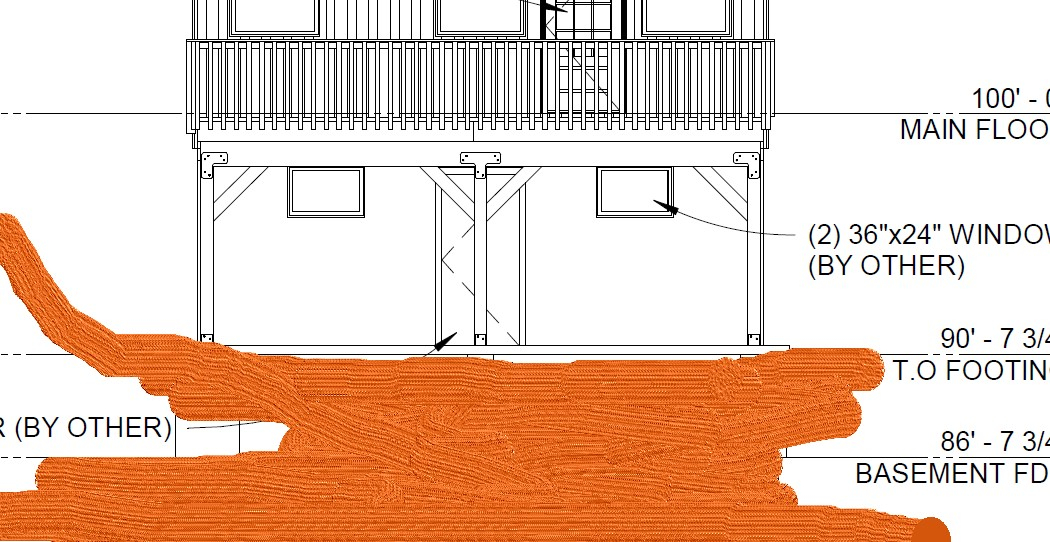

A and B bents are assembled on the ground. I spotted C bent posts in their position but needed taller cribbing so they don't interfere with a cross beam support bracket. That slowed me down. The tractor with my QA forks is a lifesaver. I have gotten in touch with a contractor who's interested in my project. He owns a crane and telehandler. We will meet next week to talk details. My main hurdle is to get the bents flown into place and braced. If they have time I may have them put all or some of the rough cut 4x6 roof purlins on. One big boo-boo the plant made was that they cut two bent posts too short. Initially it drops my roof down about 8" but I will likely add pressure treated blocks on the bottom of the posts so that gains me another 1.5 inches. It's something they recommend on slabs and included but not needed on a foundation. The reason I want to use them is my U-brackets on the sill plate have two anchor bolt heads sticking up. I would have to position the bent post to make an impression then lift back up and drill countersink holes. So my option is live with it and the first bent with shorter posts is now the zero cut line. Or they can send two replacement Douglas Fir posts to me but I would have to cut the angles and drill the splice plate holes. I might possibly do that but that bent will be the last to go up and is on the bottom of the constructed bent pile. I'll run it past this contractor if he comes on board for a few days or a week. He has other work but some jobs can be postponed. PS I checked today with my clinometer phone app and that is a 11* slope I'm building those on. Ugggg

The problem is you see in the photo the short posts are on the bottom of the built stack. But, If this contractor comes on board I may see what he thinks of flying A, B & C bents and then D bent is exposed. See how long it might take to swap those posts out on D bent. If he thinks that's easily doable then I will get the TF folks to send those new posts asap. If not (I didn't mention it) and I go the short version I would hit them up for some compensation for their mistake. My "project manager" happened to be in the office of another co-worker. We thought something was obviously wrong about 15 days ago when we started spotting posts for the B bent. A phone call made it seem like they just cut those posts way longer...but they didn't.
I got back to the project early this week and my buddy wasn't there as last time. I had a clear head and decided to take measurements again. It did not make sense looking at the print. So I called them back.
During the phone call 2-3 days ago I think the co-worker understood the problem and was looking at the picture showing a tape measurement and no where near saying what the prints say.

Another thought, you could simply scarf/splice in an 8" stub, then trim out the bottom of every post with some nice hardwood for the bottom 12". I'd do that before I cut all the posts to match the shortest pair.

I thought about that to a little extent but all four corners get a 5/8 threaded rod epoxied 12" into the foundation and connected to the base via a Simpson HDU bracket. There are no mortise and tenon joints in this kit. Everything is plates and bolts and/or
#17 -8" screws. Some angle brackets get 3 or 4" large wood screws. The 8" stub would be hidden under the 14" I joists that go in after the bents have been flown.

From what you say - they made the mistake. So make them fix it at their expense. Normal business...

A contractor came by today and we discussed the details. My main goal is get the bents up and on the foundation then if his schedule or my funds allow I may have them put the roof purlins on. He also said yeah replace those two posts so I don't regret it down the road. We can raise the top 3 and then swap them over on the last bent to go up. Plus, like he said these Douglas Firs will be fresh from the sawmill so no or little warpage. Also the shipping dept guy is going to send me 3-4 replacement 10" nail base panels that were buggered up during shipping.

Headway. Finally got 2 bents flown into place on Halloween and the other 2 the following day. We still have about 3 cross beams and two posts that go all the way to the basement to put in. I assisted as needed but let the boss man and his two helpers do their thing. This is the first timber frame he's dealt with. They also swapped out the two posts that were cut too short at the plant. Hopefully next week we rent a telehandler as his broke down and acts like it has an air in fuel problem. He plans to bring an Amish crew in to finish the aforementioned stuff and get the roof purlins on. Then it's 8" tongue & groove followed by 10" nail base panels. This project has had way too many delays and paying a crew to hustle along was the way to go for me.
