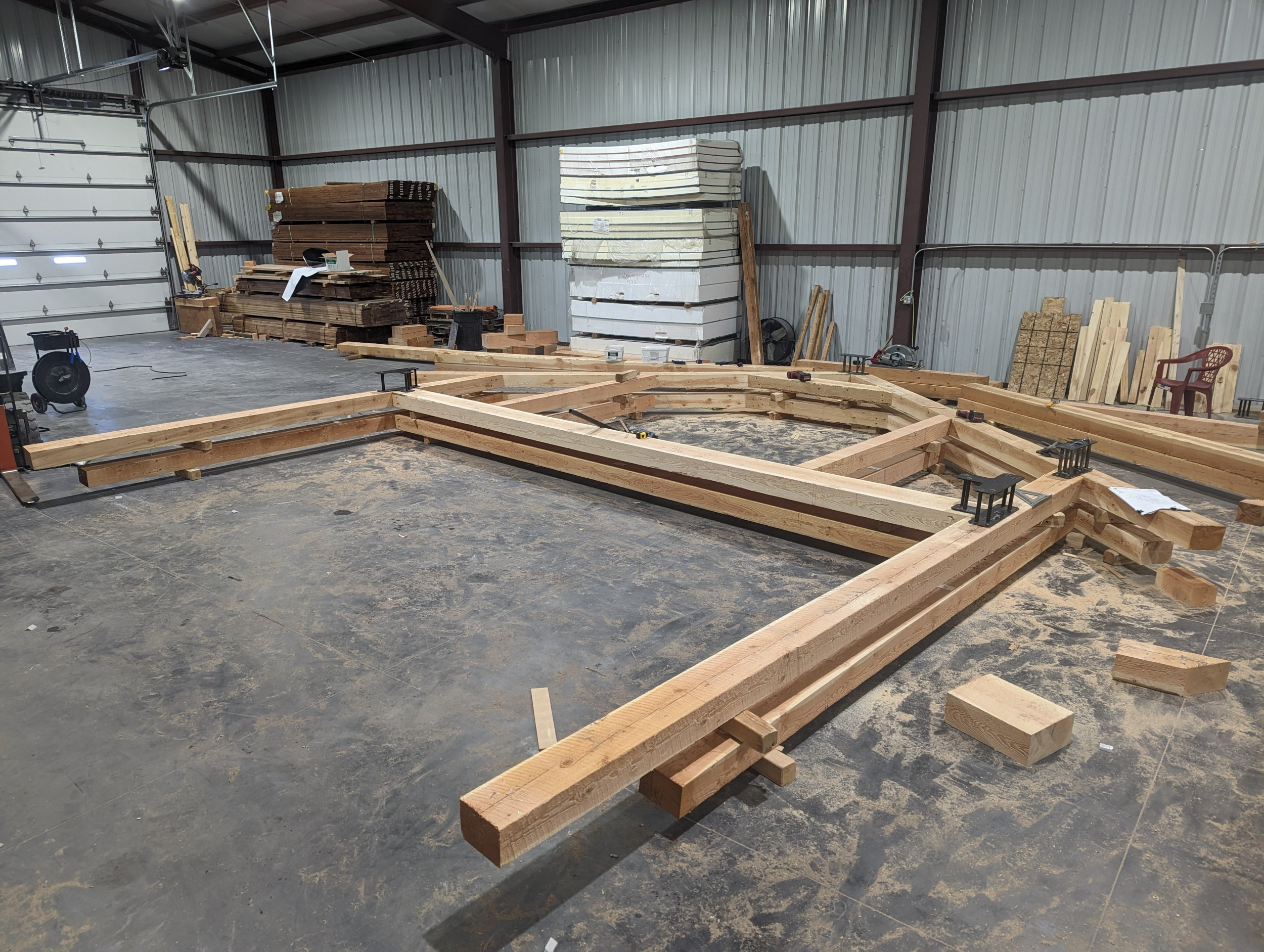

I asked the lead Amish guy if it was ok to be in the picture. He said they did not want to be in pictures. I honored their wishes. It was interesting watching them climb the bents and 30' to the concrete basement floor. Wednesday it was getting them up to speed. They started to notice some of the bents were not square and plumb so they spent a couple hours redoing temporary bracing until they were happy. Maybe the contractor, who these guys are subbed through, has a wonky level. He had tow 19 y.o. kids working for him and one was first day on job. Wed my contractor showed up with replacement telehandler. The Amish crew arrived with their driver and trailer. After tweaking bracing and getting things more true they got all the East side purlins on. Thu they did the West side purlins and got 1/6th of the tongue and groove roof sheathing on. They finished the T&G on Friday and got a couple rolls of Epilay Premium on. I got to use my used SIPS groover for the first time. Slow but not as stinky as I thought it would be. Electric Foam Scoop
