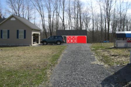

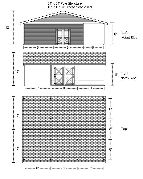

Well after several years of reading on here about others building homes for there tractors it is now my turn. :) I need to replace one of those Harbor Freight portable garages that pretty much desinegrated after it's third season. Held up great at first but once the material started to "thin" it went quick!
I started looking into large sheds that were large enough to hold the PT and a few attachments (plus a few other outdoor items that were in the portable garage) and went into sticker shock. I only have roughly $2000 to put into this and have two criteria: It has to be largest enough for the tractor and "cute" enough for the wife. After looking at various wood, vinyl and metal options that didn't seem to meet those two criteria (within budget) I stopped by a local Carter Lumber to see if they could quote me a pole building idea I came up with. The attached drawing is what I took them and it came in right around $2000 (and I never told them anything about my budget at all). Bingo!
The second mocked up photo is what I think it will look like. Roof footprint 24x24. The shed will be the 16x16 back corner. This will give it a 6' front overhang and an 8 foot "pavillion" like area to the side. We've always wanted a pavillion and this will give us the affect by just adding two more posts and 4 more trusses. (Plus down the road I can probably build a gazebo somewhere else on the property and box in this 8x16 section... shhh don't tell the wife).
Floor will be slag like the drive. No plumbing, electricity or anything too fancy.
I'm in the process of trying to find someone nearby with an auger, once I do that I should be able to start fairly soon.:D

The price sounds pretty cheap for so much material? is this a kit? looks like a good deal for what you need. The only problem might be the height, shows it at 12' at the peek of the roof, will that give you enough door clearance?
Good luck, JB.
/ A small pole building for the PT
JB,
No not a kit. I just took the drawing up there and the guy I talked to has a lot of experience building pole barns so he priced it out on the fly by building it verbally ("First thing I'd do is set the 13 posts {ring up 13 posts}, then I.d attach the...{ring up next item}, etc."
I'll post the material list later to see if anyone see's anything missing. I think the only things not included was hardware (nails and hinges for doors), cement for post holes and paint. It included flashing, roofing materials and trim boards.
As for the height, the side walls are 8' and the roof is eng trusses every 2'. That means I won't have any usable space above the 8' really. For me this will be OK. I don't have any large agricultural tractor and ROPS. I have a Power-Trac PT-180 and even with my custom cab it will clear a 7'6" door with space to spare. I have thought about making the side walls 8' 10" by just moving the T1-11 up 10" and running a pressure treated 10" board around the bottom perimeter. That would allow me to handle 8' lumber or sheets of plywood inside with a little room to spare if standing on in.

Something just dawned on me... the footprint is going to be 24 x 24. Depth I made the posts 22' so the 24' trusses would have 1' overhang each side.
From one gable end to the other though I didn't think about overhang... the posts are 24' outside edge to outside edge. Is this going to be an issue later?

The ends should overhang beyond the trusses to protect the ends of the building from the weather. The posts are in place so you will need a little more roofing.

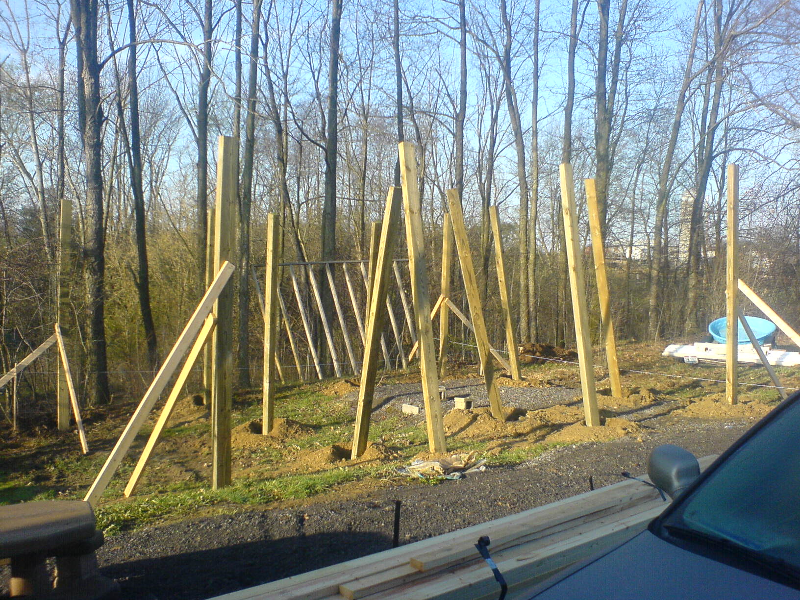

Tonight was not a good night... I remeasured all the sides and diagonal and one of the poles shifted quite a bit. :mad:
Of course we've had rain and the hole has partially filled in. Trying to reposition it with it like it was wasn't working... using the post hole digger around the post was a pain... ended up pulling it out.
Of course I spent 30 minutes trying to do so manually... using the tractor didn't dawn on me to I was pretty worn out. Then I ended up nailing a 6" 2x4 to the post (about two feet up), slid the lip of the bucket under it, raise it a foot or two, then used a cinch strap over the FEL arms under the bucket and around the post to keep it from tipping. Then it lifted right up with no effort. :eek:
I cleared back out the hole with the manual post hole digger (did I mention I was already worn out BEFORE starting this...:() then set back in the post.
After all that I still can't get it right where I want it. :mad:
I called it quits for the evening... here's a quick photo from Sunday.

Sorry to hear about the tough time getting the posts where you want them. For tamped posts you pretty much have to be able to accept a 1" position tolerance. You can brace a post in a clean hole and pour concrete to get more accurate or do concrete piers and brackets to bolt the posts to them.
I like a chain around a post for pulling it. For setting them too when I do power pole posts.
Your site does not look level. Are you planning on a raised floor? If not and it's really not level I would pull the posts, level the site, and start over (Yikes!) You will never be happy with a sloping floor.
Sure it's a lot of work but on that PT it should be fun. :)
